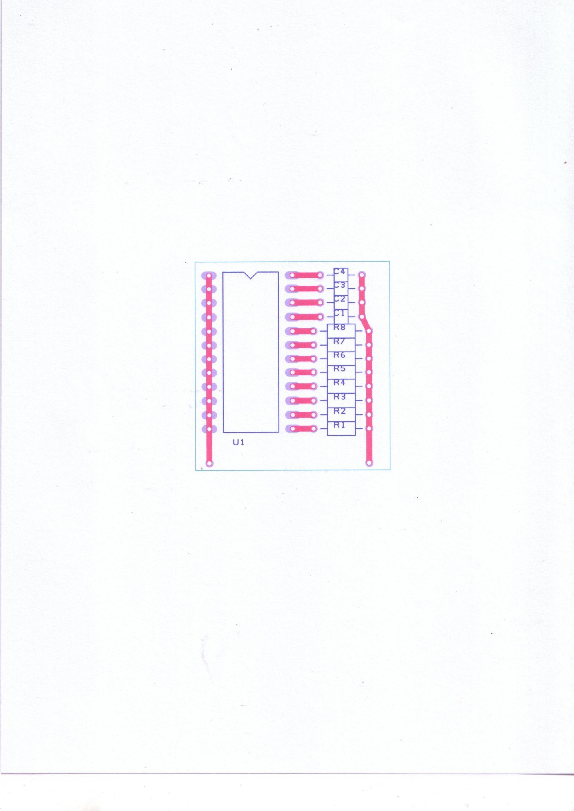

currently i´m adding a million solderpoints in the signalpath for a input imp. switch..
My 2 cents if I may
I have been using dip switches for quite a while and the same as you do
but you have to many wires there as clever paradise boards have spare set of input pins nothing is stopping you to solder the compensation there
after all you just putting a resistive value in parallel to the cartridge winding.
and if constant fiddling is not required this can be done on Little daughter board to fit perfectly maybe even with smd components.
what about same capacitors loading?
My 2 cents if I may
ahhh, many thanks to hinting me on that. I understood and will change. signal direct to pcb and the loading in extra line between the spare input option. :), clever.
