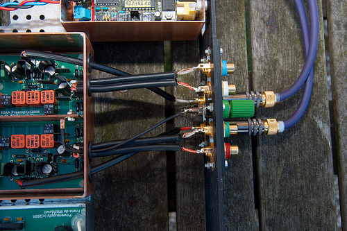

Maybe the gnd on the rca sockets is touching the casework.
This is an interesting point, the RCA connectors in and out should be mounted (any way that is what I prefer) on a Plexiglas insert (inserted into the back panel) to be sure that no (not any) signal or signal ground wire touches the chassis at that point!
Maybe this remark should be added to the builders guide :)
You just can see the insert (just) on this picture Balanced RIAA preamp | Flickr - Photo Sharing! it is on the outside :)

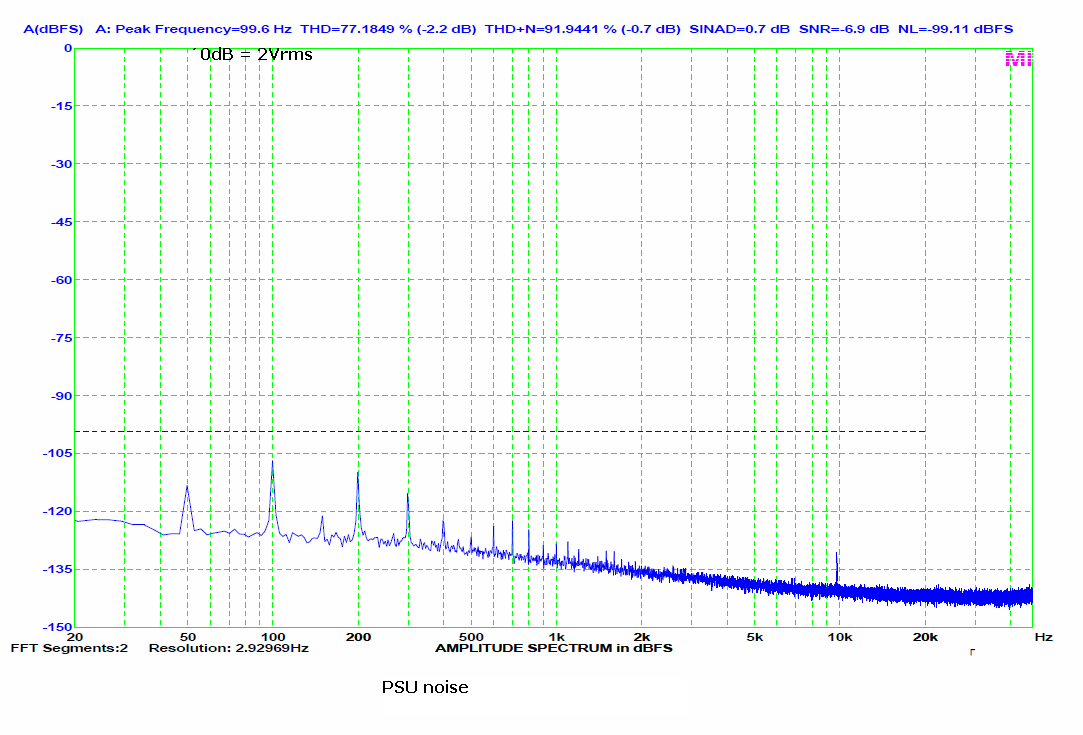

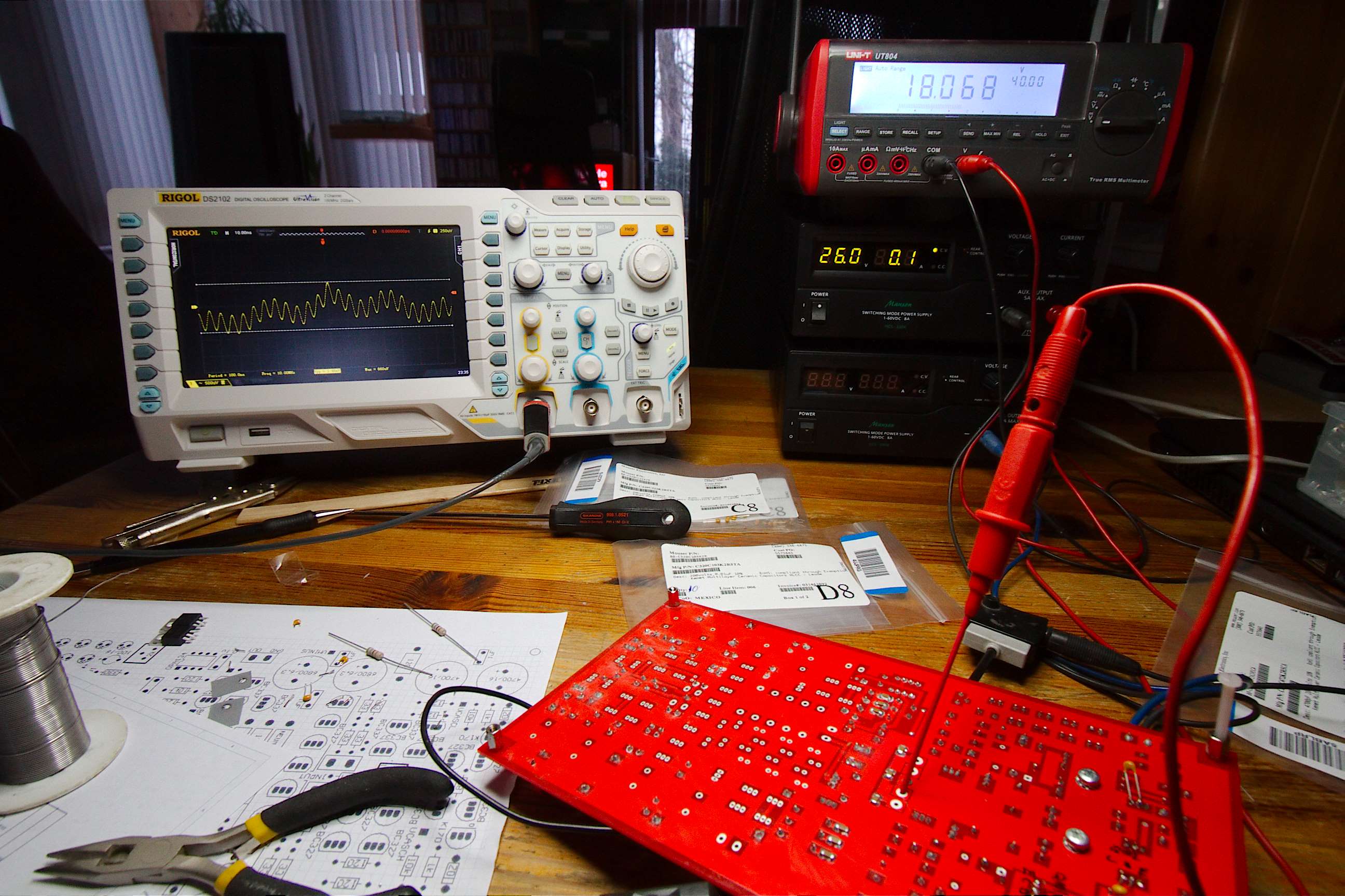

Here a picture that tells a 1000 words (I hope). The scope is at 10nS and 500uV, the HF is sampling artifacts. If you remove the sampling artifacts from the signal, then around 600 to 800 uV signal is there. With this I am happy, the PSU is unloaded, there is no shielding, sitting on the living room table near to the SMPS. This all is at the limit for the scope.
Someone will be happy to see this/his positive supply fixed, I will now continue with the negative supply.
Any remarks, let me know, I will be happy to discuss this.
The funny thing is, I am still not sure why this one was oscillating (more than 2Volts pp), or in other words, why most others are not oscillating.
The things I did are:
1) Remove 2 MJE15031G from the positive supply and replaced by D45H11's. This lowered the oscillations somewhat but not much.
2) Paralleled the 330 ohm be resistors with 56 ohm resistors. Again, this lowered the oscillation somewhat (slightly more than in removing the MJE25031G's).
3) Added ce capacitors (as in the builders guide) but I had to use 4n7's and 2n2's to stop all oscillations.
There you have it, my report from the trenches.
