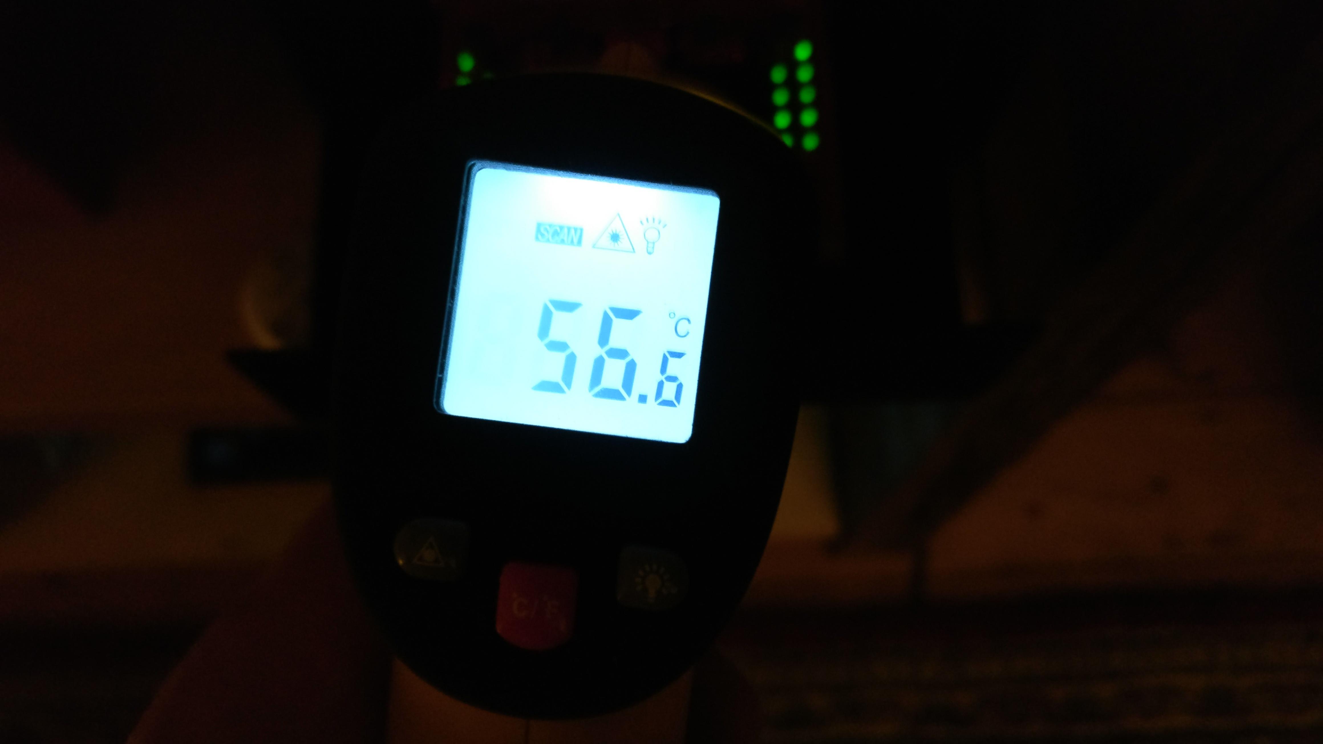

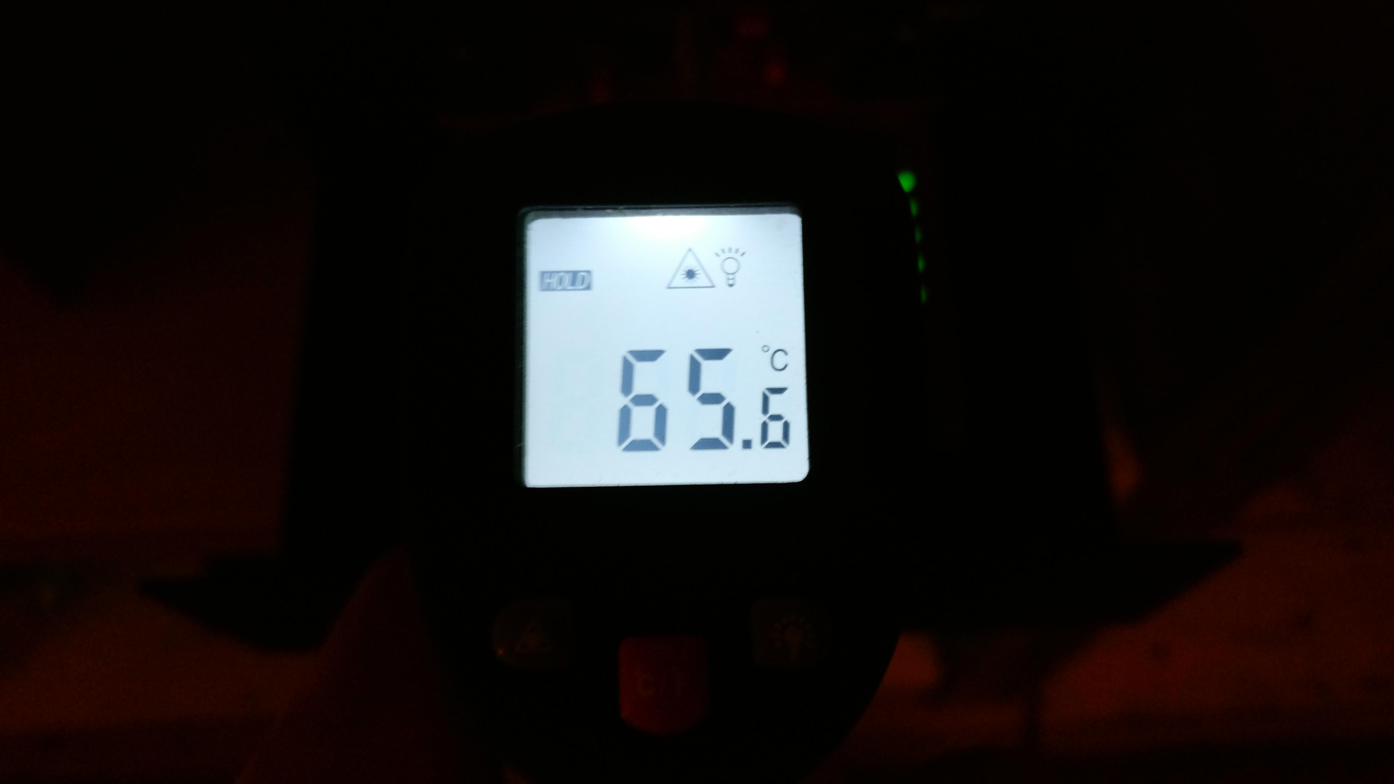

I measured some temperatures inside my closed box.
Air-temp inside is max 34°C after 3 hours.
Than I measured the heatsink closed box, which was 65°C on the hottest spot, on the semiconductors around 45-48°C.
Free air the temp of the heatsink is 56°C.
I measured all the other places in on the Paradise, hottest was 45°C, all capacitors not even reaching 40°C. :cool:
sq225917: can you tell me if I can use the c-rc snubber values? :eek:
thanks for the data, very good. Good industrial grade components will not have any (lifetime) issue with this.
You may want to check if little ventilation holes right above the heatsink (and ideally on the sides of the heatsink) would be possible, that way the warm air can move up and out, to be "replenished" by colder air coming from the sides. This will however create airflow inside the box, so shielding the input transistors thermally (as sq suggested) may be required (and always a good idea anyway)

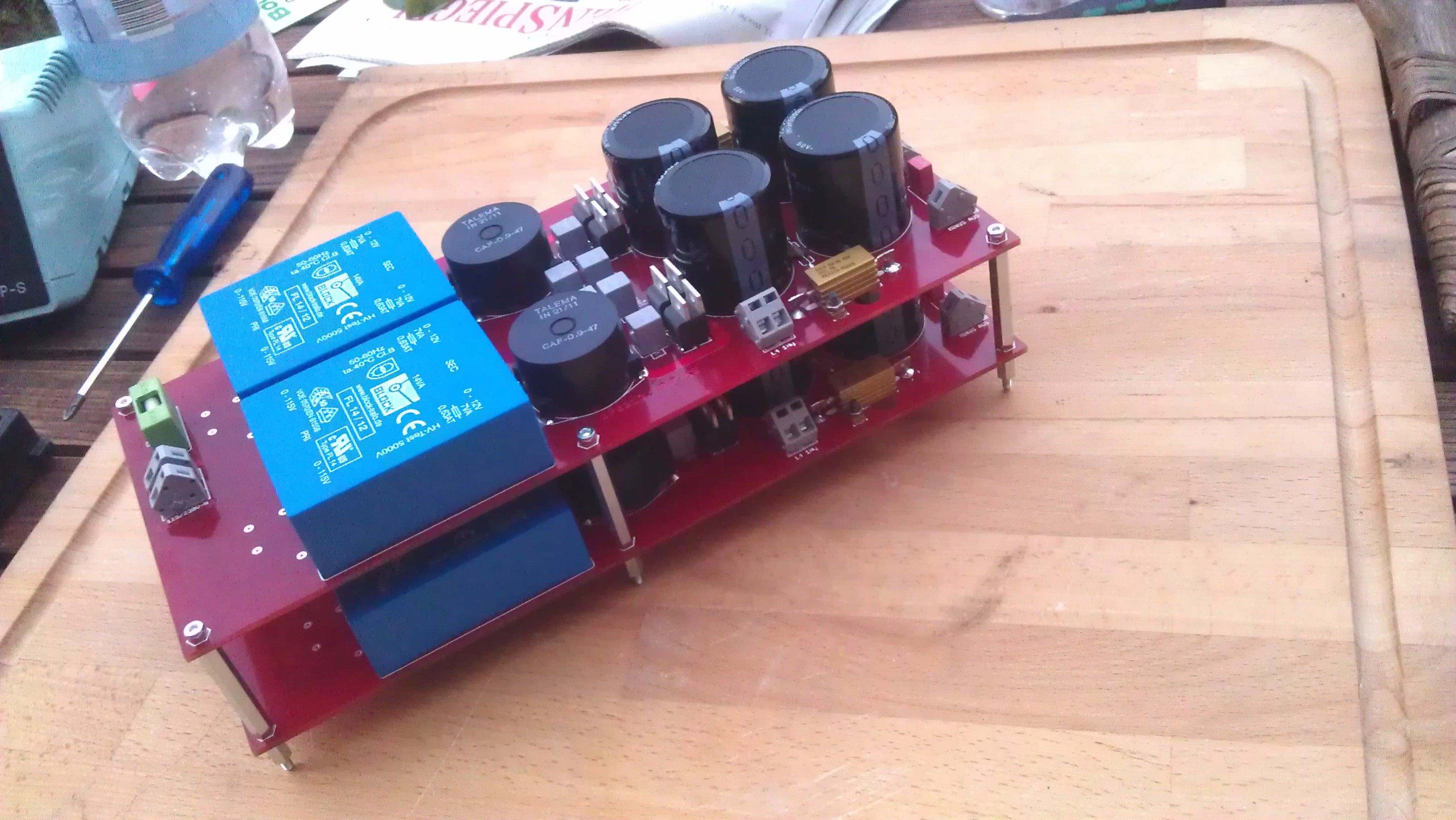

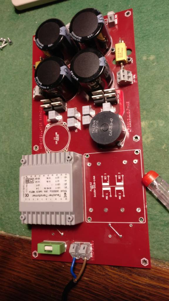

Audiomania, I never measured actual snubber values for the group buy psu with the BLOCK transformers. I use Talema 70065k in my builds and the optimum snubbing combo for that is 10n-15n/82r.
Without having one of the BLOCK transformers in hand to measure I can't really advise. I know the resistor value will be between 20-200r, but I don't know exactly where and it needs to be within a couple of % to work best.
The diodes kick back into the transformers which makes them ring. It's not high amplitude but it's visible on a scope. I use the Quasimodo pcb and a scope to test for ringing before I complete the boards. The Quasimodo is basically a square wave generator at 50hz with space for an onboard C-RC filter. Simple, effective and inexpensive.
The physical noise you are hearing from your transformers is due to poor winding and potting quality. The C-RC filter will not change this, but it will snub any electrical ringing coming from the circuit.
Two different things.
sq225917,
Thanx for the explanation.
I've tried something :
I disconnected the Talema directly after the transformer, as you can see in the pic. I even desoldered the second xformer. Even than the xformer makes buzzing noises. Looks like I have to switch to the ones you use. Can I do with one xformer per side or shall I do the overkill like in mine? 😁 IMG_20170316_213129.jpg
