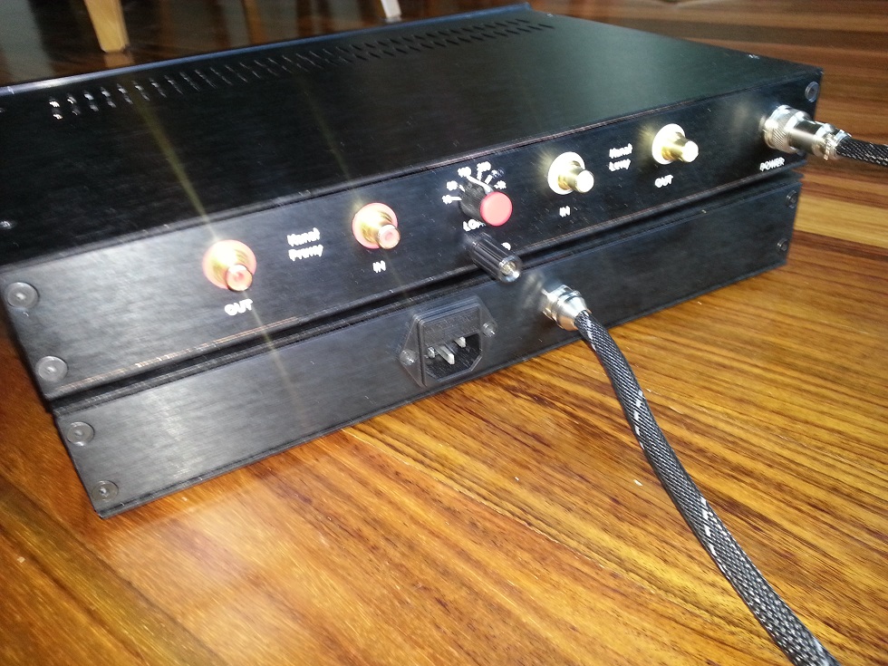

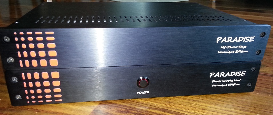

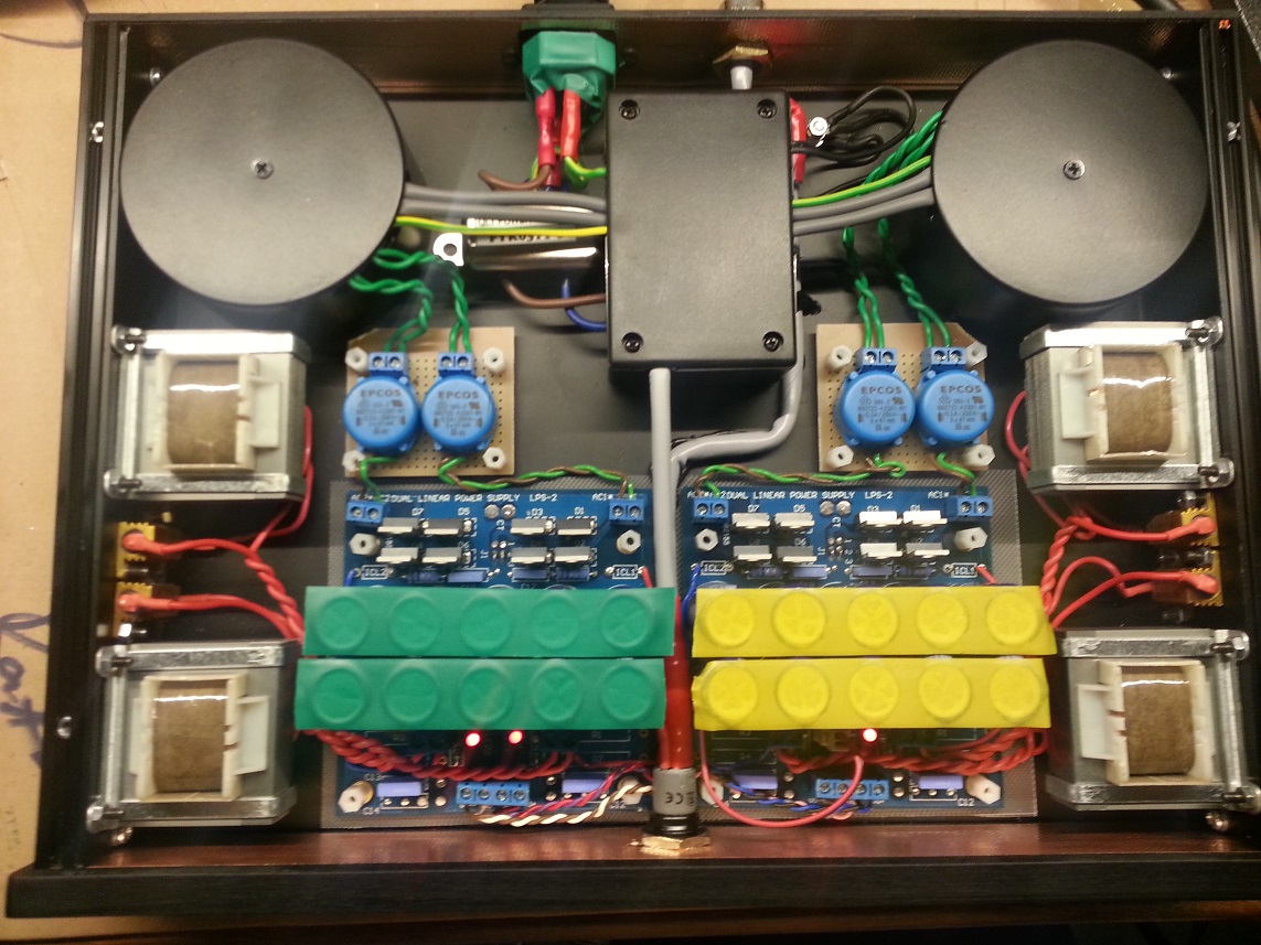

And here is my build of Paradise with Calvin buffer housed in two modushop enclosures. 40mm of height for this enclosures is a bit challenging but is as you can see is sufficient. For amp module I have thermo-coupled shunt heatsinks to the top plate od enclosure to improve cooling. Both amps are in separate copper enclosures painted black. For PSU I have custom made inductors of 1H mounted horizontally to fit into modushop enclosure and custom made toroids additionally enclosed in steel cans. In the plastic black box in the middle there is a junction point for 230V (for additional insulation of this dangerous voltage) and DDCR circuit.
As you can see I intended to have both enclosures sitting one on the top of another. Unfortunately I still have trace of hum in this configuration. This hum is gone as enclusures as side-by-side but this is not I want. Initially I thought that this is related to toroids and therefore I used this steel cans – it helped but not fully. Another step forward was to re-arrange a bit grounding scheme for amps enclosure – better but still a bit hum.

I plugged in my tonearm, and also a cartridge just to check for hum for you. (and to finally check if there is any trouble for myself), all i can say that is i can hear little hum, when i have maxxed out the volume on my B1 preamp. Usually with this don't use volume more than maybe 12 a clock, and then its extremely high volume level. At this level i would pretty much instantly kill my speakers - so to sum it up, it's extremely silent.
I have don grounding like this. Pre-regulator in one case, the one from group buy. Grounded the chassis of pre-regulator straight to mains ground. Then i have 7pin plugs to other chassis. + gnd - from each channel, and chassis ground through the last pin. Inside the amplifier case i have the mains gnd from the pre-reg case to a star ground (which is the tonearm-ground post that also does have direct contact with the case), and another wire to the DDRC boards, and one wire from the other side of the DDRC to each amplifier board.
I did it like this, and not like Frans grounding scheme. This because at least i see the tonearm ground as an "extension" of the case.
I don't want to lift the chassis from mains gnd because of security reasons - but i would try it if i had alot of hum.
Hope this maybe can help you, and it looks like a nice and serious build you got there.

Re: my grounding schema:
I have 'lifted ground’ concept. Power earthing (PE) goes from IEC socket in the PSU enclosure (through power filter) to DDCR. Other side of DDCR connects to PSU chasiss – to its ‘star connector’. I have connected here also shielding for PSU-Amp cable and shields made between primary and secondary winding of toroids. There is no any other connection to PSU circuit here. This PSU Star Connector connects to Amp star connector (through PSU-Amp cable). And here I have connections to Amp chasiss, both copper shields of Paradise PCB and GND od both channels of Paradise taken from input connector at PCB. All elements: Amp chassis, copper shields and GND of both channels circuts are isolated from each other and they connect only in this one point – Amp star GND. This point is also socket for tonearm grounding. Previously I have slightly different grounding scheme: GND from both paradise PCBs were connected together at input impedance selector and this point was connected to star GND through single wire. But I found that this arrangement was giving a bit more hum that I have currently. Sure – this is not that level of the hum to disturb normal level of volume. My concern is that when I max volume I can hear it – and simply I am looking for perfection here and I know that it can be achieved
