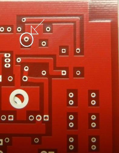

Me too, but the linkage posts FdW puts up help a lot. Post 2213.
http://www.diyaudio.com/forums/analogue-source/218625-paradise-builders-222.html
I didn't understand the board mod pic until I looked at my boards. If it looks like this you need to cut around the pad.
