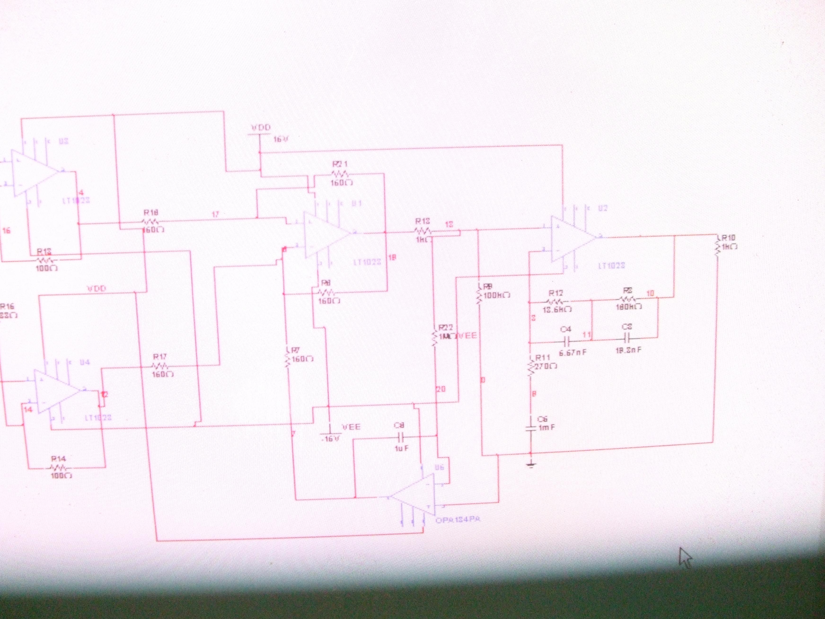

Hi Riccardo I have posted a while ago my LT1028 balanced
Maybe Joachim remembers?
Using complete INA limit resistor value choice? 3 K and 6 K for 163 while discrete 3 LT1028 alowd for much lower values.
Worth looking at FDW balanced ?(yes I know I need to get back to it SORRY is not forgotten)
Long time ago here a couple of preliminary drawing (I am sure you can do better than me)
One is Split passive and did run for couple of years:D try ed AD797 but was a bit to metallic
second was going to be, till I got infected by MPP and decided to try and learn sumthink about transistors, tanks so much, to late now to realize that Public forum is not right place.
LT1028 is BJT low noise voltage wise Current wise noise is sort of forget to mention it so data sheet looks better .
But said before Frans got better...
Cant promise much all old file are in secret puter never connected to intra web at present in the loft untouched for quite a while
