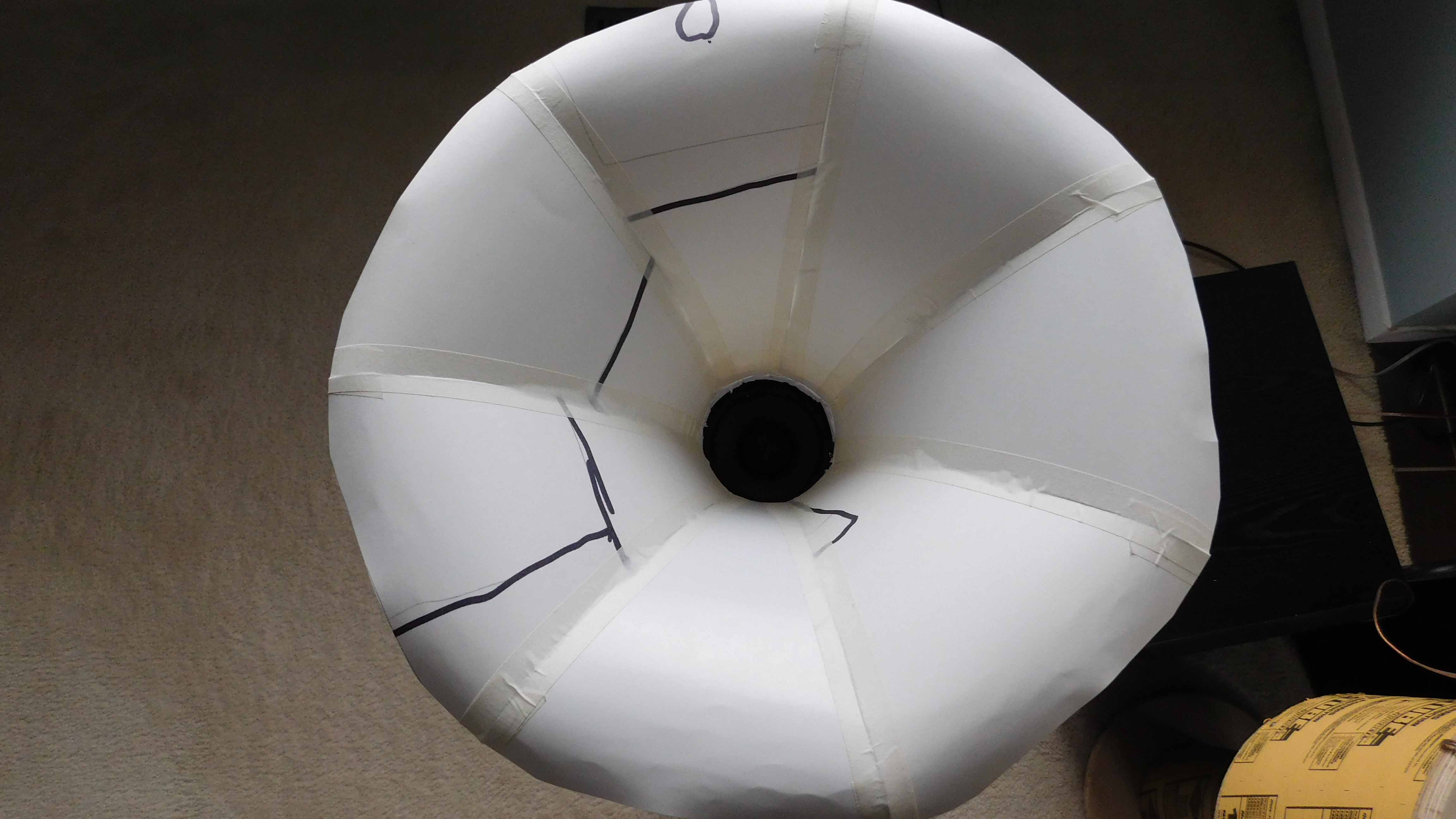

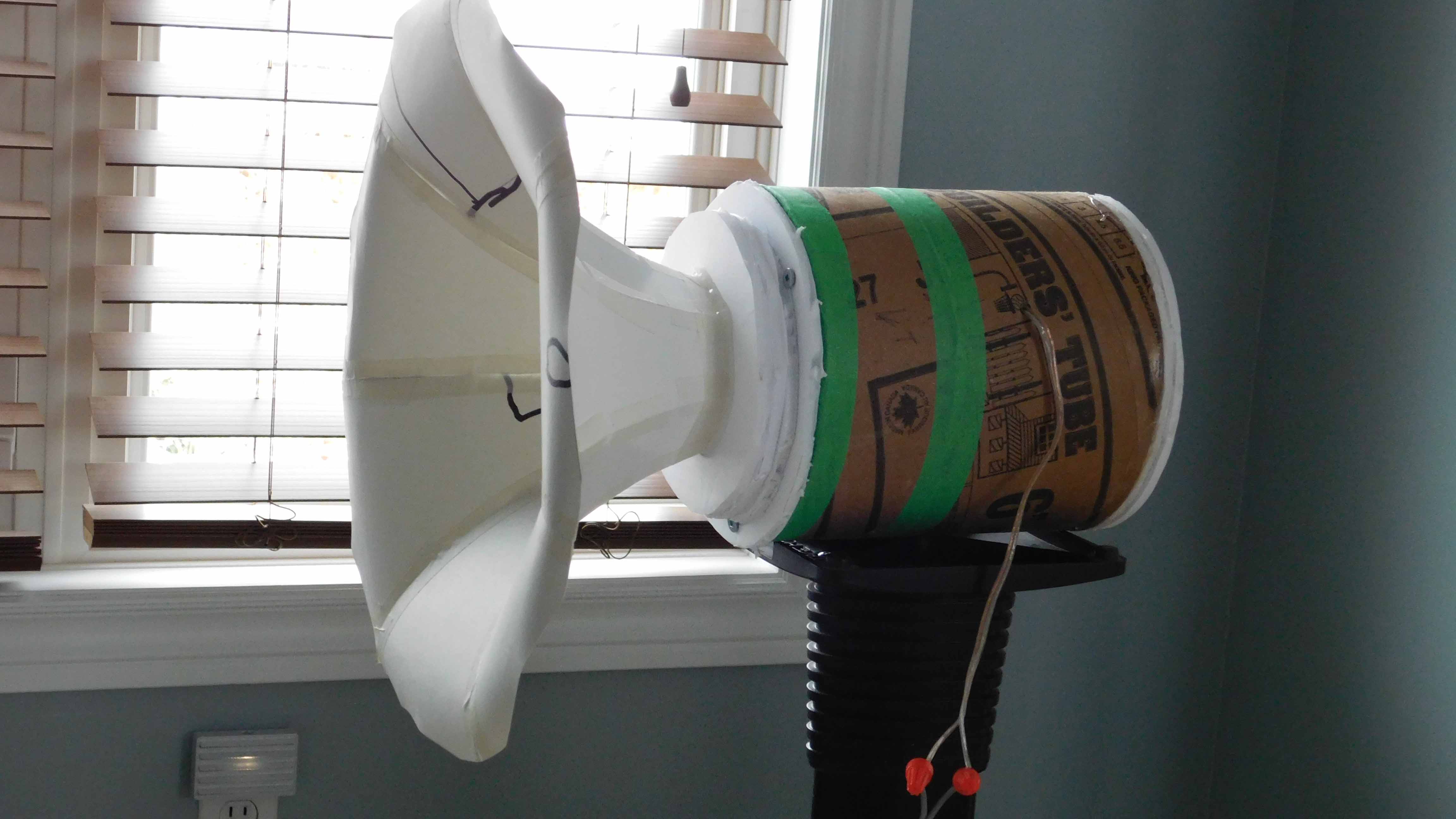

I try to stabilize my building process, but it is very hard to resist to the appeal of creativity.
I've made this one with my inkjet paper sheets (no scotch at all )... for nothing a all
Not totally useless indeed, we can clearly see the deformation problem of the water based PVA glue with the lack of support during the curing process

There is another thread using paper mache horns Building John's Paper Mache Horns and the technique at inlowsound.com . It's a lot more work for a qty=2 but allows more flexibility and maybe repeatability in wall curvatures.
I agree, creating a plaster mold is time and labour intensive using a screed. I can make a polystyrene mold relatively quickly but it is a messy creation OmniDirectional - work in progress . One of those shapes matches the inside of a Dayton 10" circular waveguide.

The curve profile is calculated, graphed and printed 1:1 using excel. The curve profile is transferred to a plywood template, where a "slot" is cut to make a curve template (removable piece) that is the same as the printed curve profile. The grinder is mounted to a X-Y travel platform that has a "pin" fitted to follow the curve template. It works like a key copying machine. The cutting disc follows the curve slot reproducing the profile on the polystyrene. This polystyrene is dense, .... at least as good as inkjet paper and bee's wax

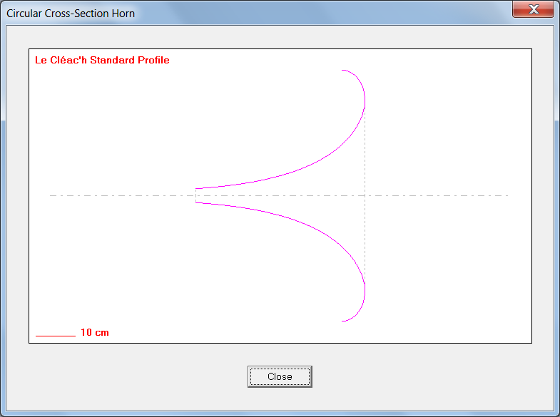

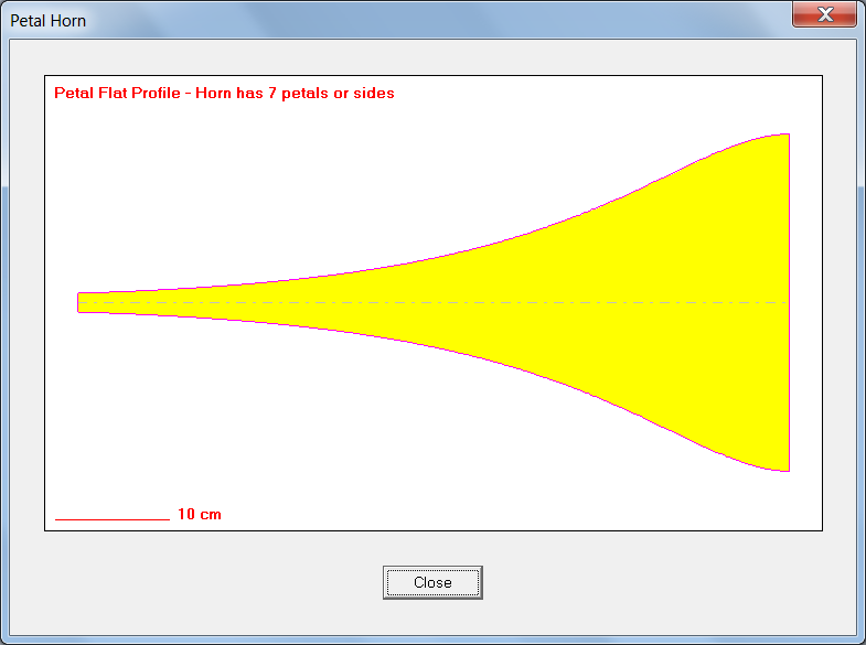

Hornresp can calculate the petal dimensions for a Le Cléac'h horn having from 3 to 20 petals, with a "rolled-over mouth" if so desired.
The attached example has 7 petals, for a horn with a mouth flare tangent angle of 180 degrees.

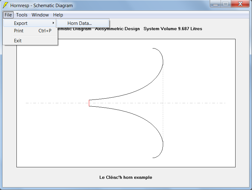

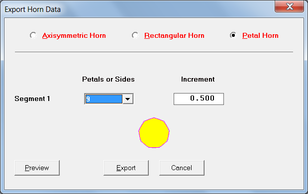

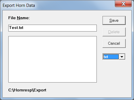

Hi DonVK,
1. Select File > Export > Horn Data from the main Schematic Diagram window (see Attachment 1).
2. Select the Petal Horn option and specify the number of petals and length increment size (see Attachment 2).
3. Click the Export button to export the horn data as a .txt or .csv file (see Attachment 3).

The 7 petal Le Cléac'h from cardstock. It's also posted with results at Dayton PC83-8 (3") test results. It can be compared to other designs attempted with the PC83-8.
