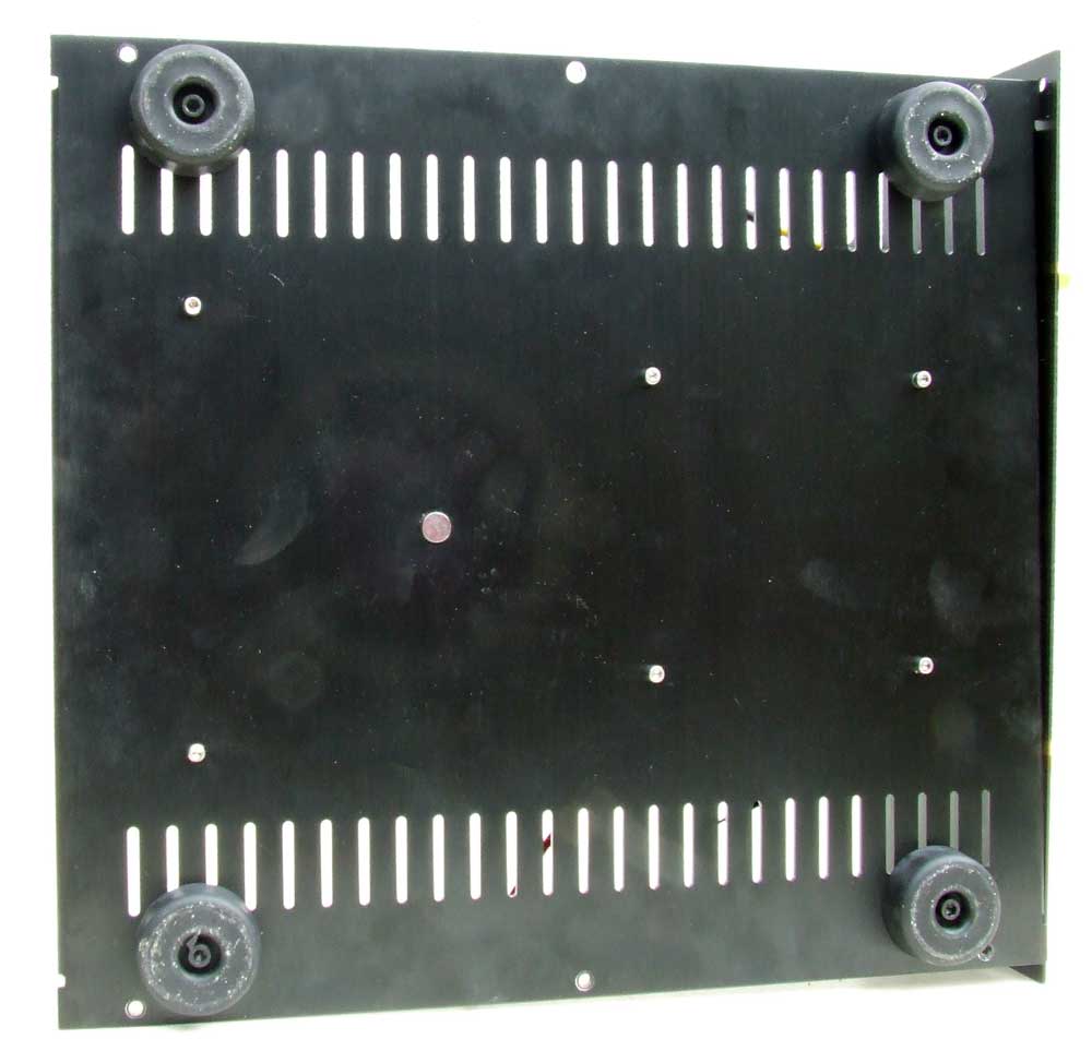

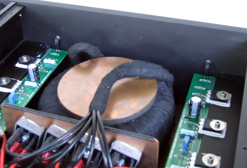

I'm certainly one of not many , having opportunity to dismantle FW chassis in pieces ; as Papa likes AR2 , he didn't put usual Donut and caps in it , probably counting on fact that Vladimir will bring it all the way on his shoulder ( not having enough trust in Air baggage departments ) ......
anyway - little jewel box is even without these few parts heavy enough ...

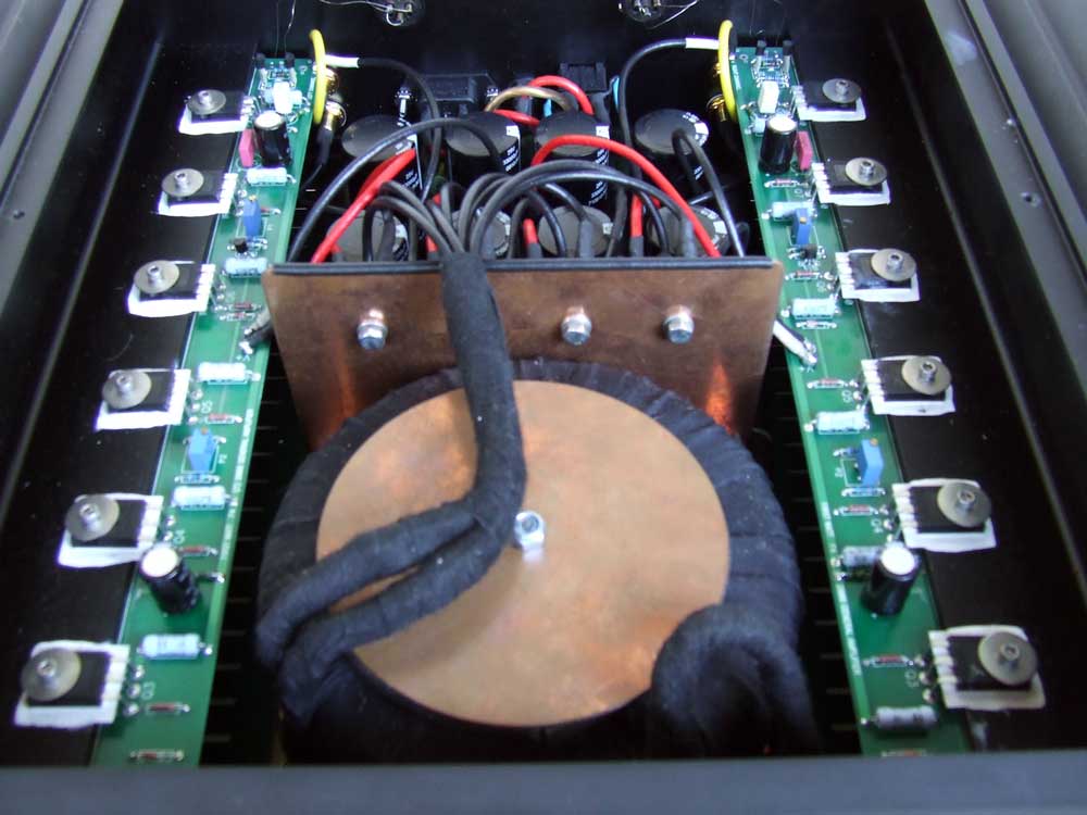

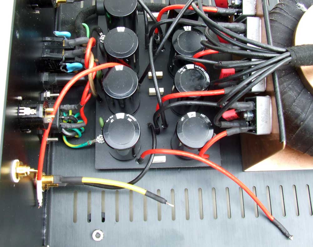

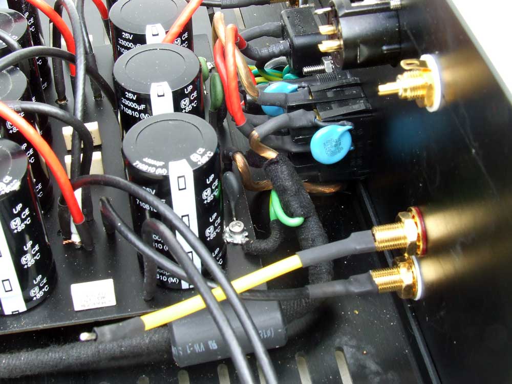

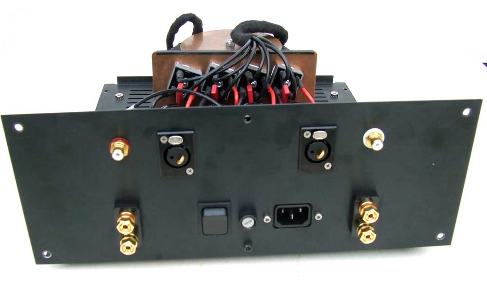

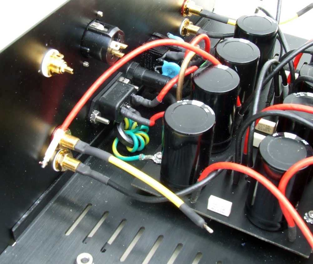

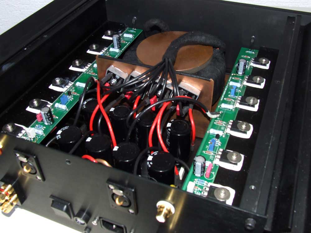

so - to have Papa's Surprise Amp in working condition I had to do few things :

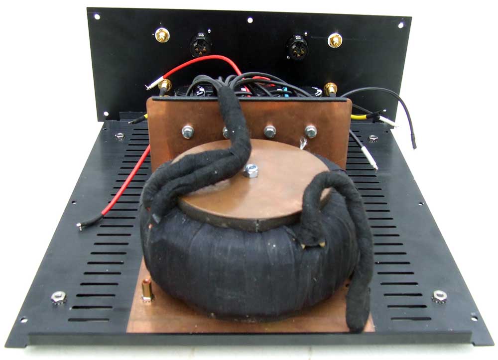

.... install new Donut ; what I already had on my shelf is just right (to squeeze in ) size - 4x18Vac/800VA ; according to that - decision to use 2 Graetzs per channel is logical , same as dedicated filter bank per channel .
so - 2x18Vac windings , two bricks , 4x 33mF/25 Panas , along with 2x 0R1 in CRC ; all that per channel
I didn't want to make new holes in bottom plate , so nice Cu plate is cut and bent , to serve as donut and bricks holder . I also made new filter pcb ( wisely sprayed in black ) , while Papa's original one , along with two finest original FW Chinese Porcelain 35A bricks will end in some less demanding project ( maybe some HP amp ) .

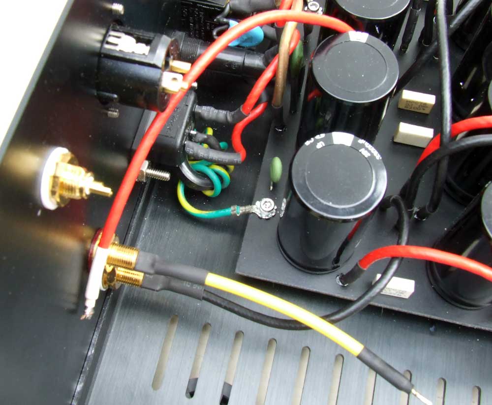

power wiring is made from finest quality cut-in-dust LS cable , produced by local factory
Donut squeezed in sandwich (top & bottom ) of soft rubber ; my usual praxis for all toroids ; you can rotate it few degrees and move about 5mm side wise , but it's secured completely

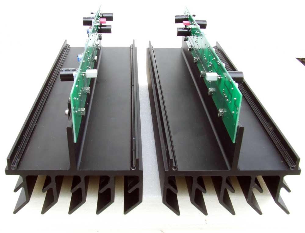

so - few pics for start ( I'm lazy bstrd , so random order is my native state)

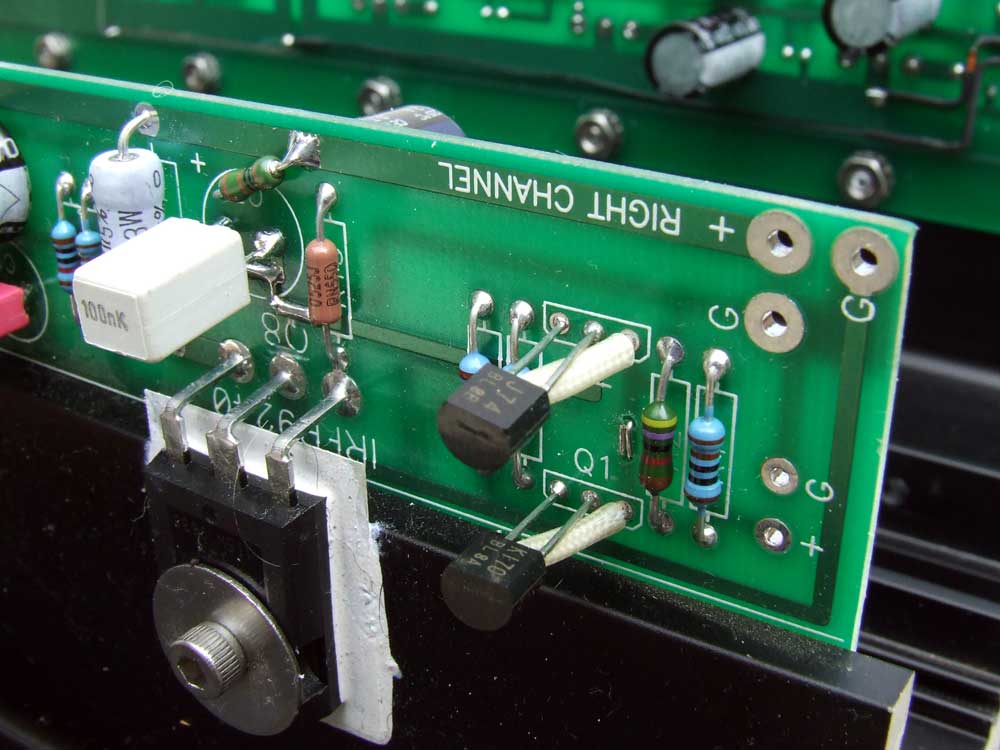

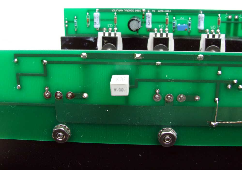

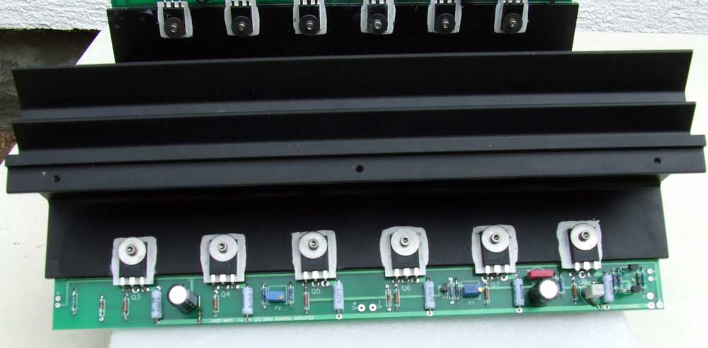

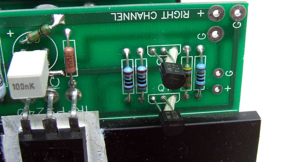

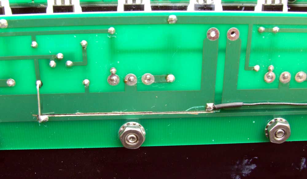

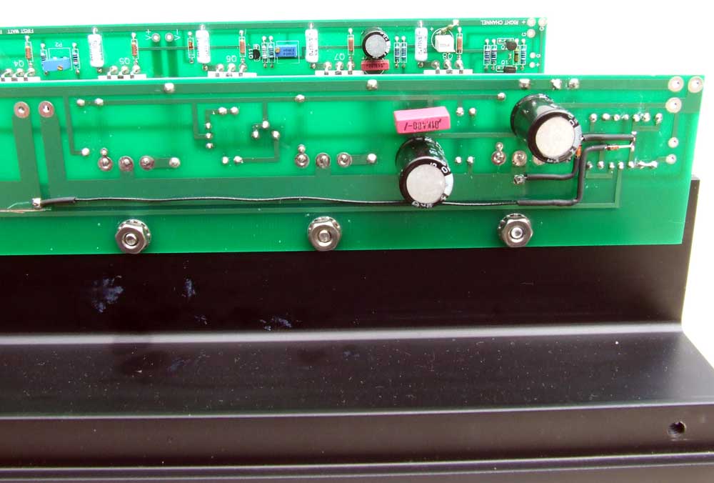

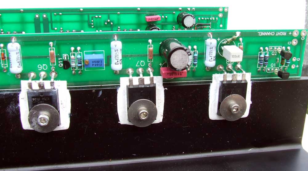

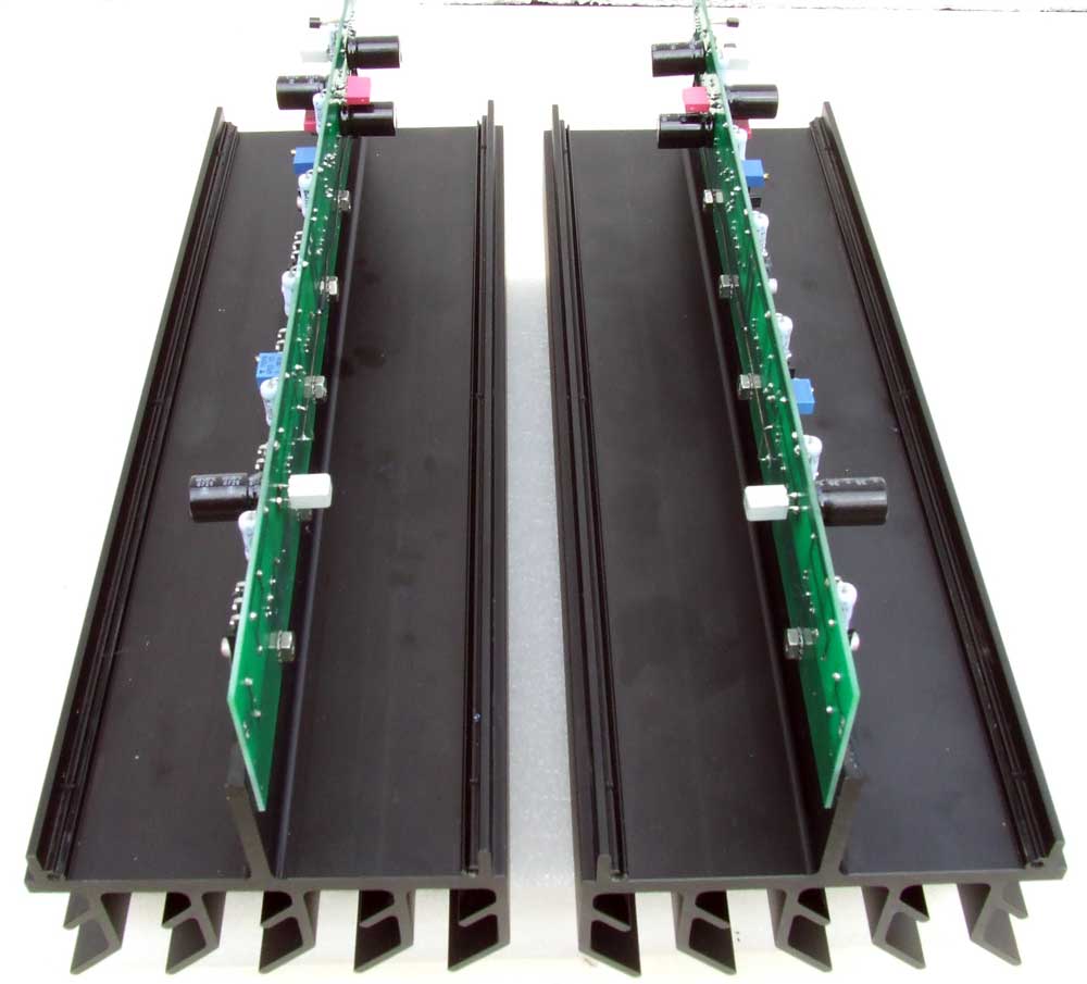

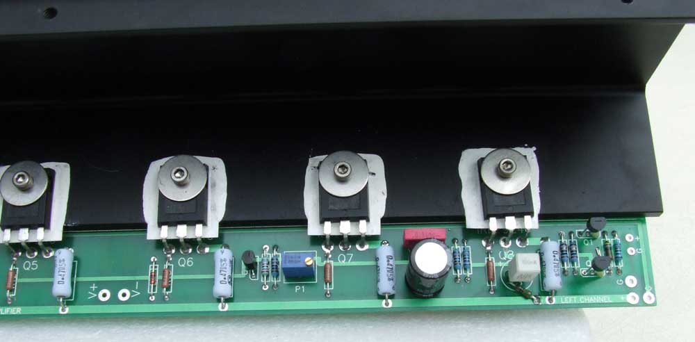

Papa sez that pcbs are from early pre-production ; meaning that pcb itself is right as schematic posted in first post in famous F4 thread ; later and final iteration have few changes - mainly with goal to save and secure tiny fragile input Jfets from excessive input signal which , in case of amplitude greater than actual F4 working voltage , will burn them in silent puff
I had dilemma few days - leave it as is , counting on fact that I don't need much of input amplitude for my spks ...... or to tweak pcb a little and make it according to final schematic ; naah ....... as Papa sez in one e-mail - " I though that you will put something else in that case " , decision was made - I'll leave present as is , but I must play with it a little ; so - every butcher detail you'll see on pics is made as change to that schm .

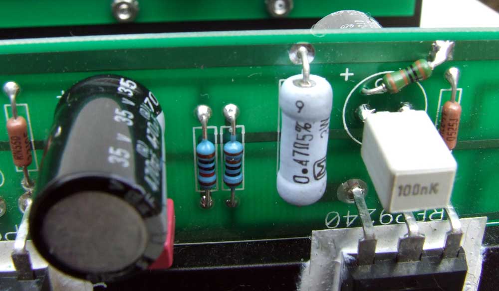

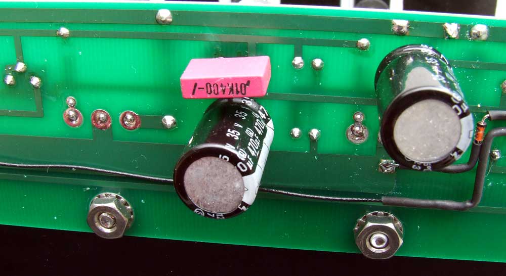

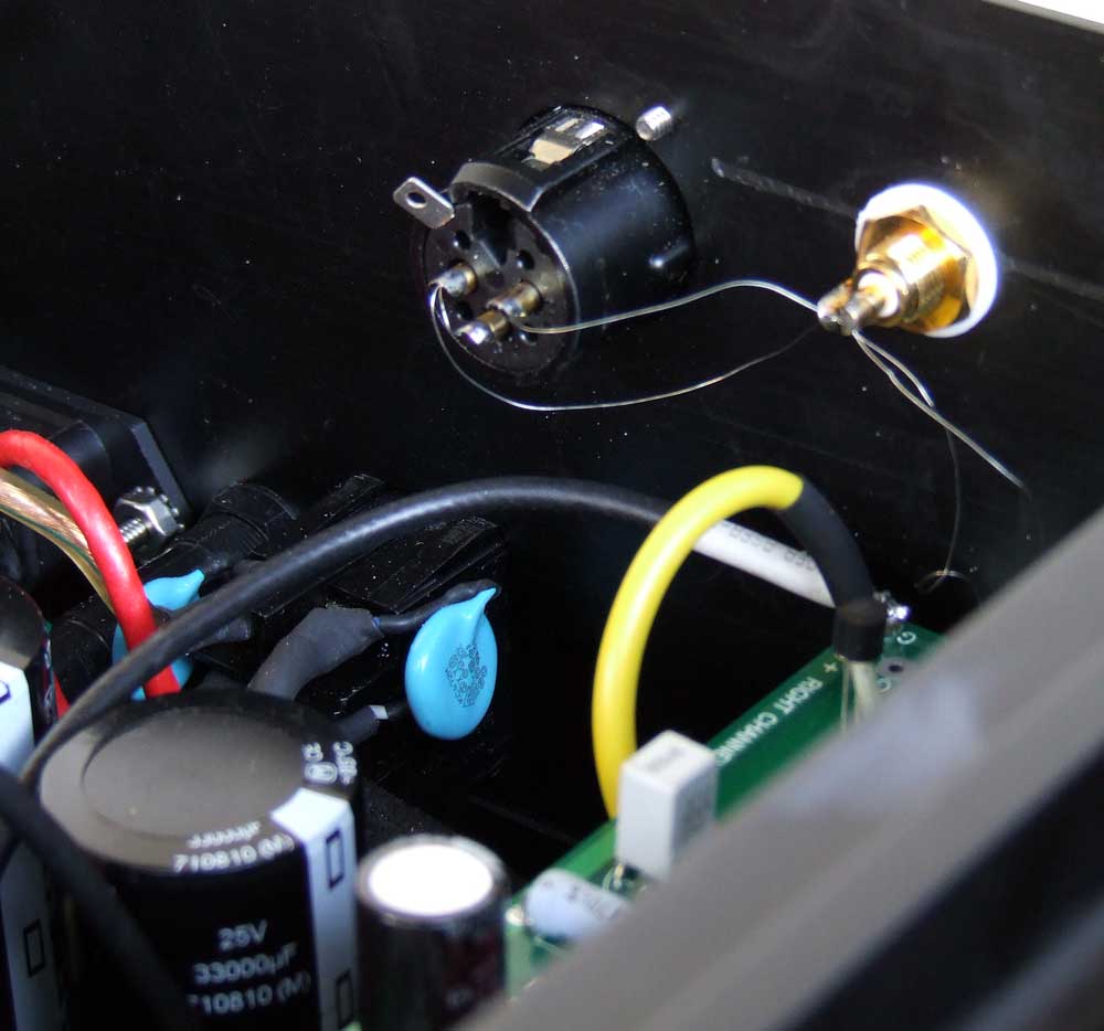

electrolytics are my fave - Elna 470uF/35V/125C , maybe because I have few kilos of them ;
bypasses on two Elnas in power filtering are 100n/some-film-who-really-care-which-type ; bypasses on two signal carrying Elnas are 10n MKC - polycarbonats

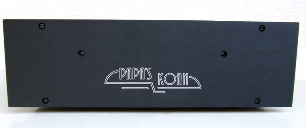

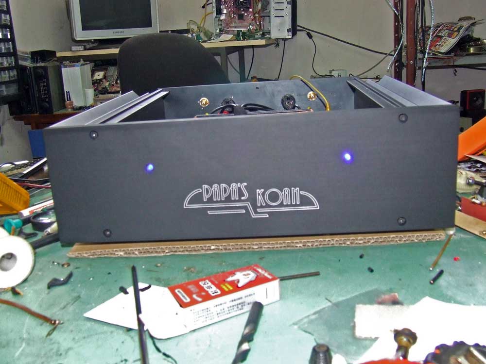

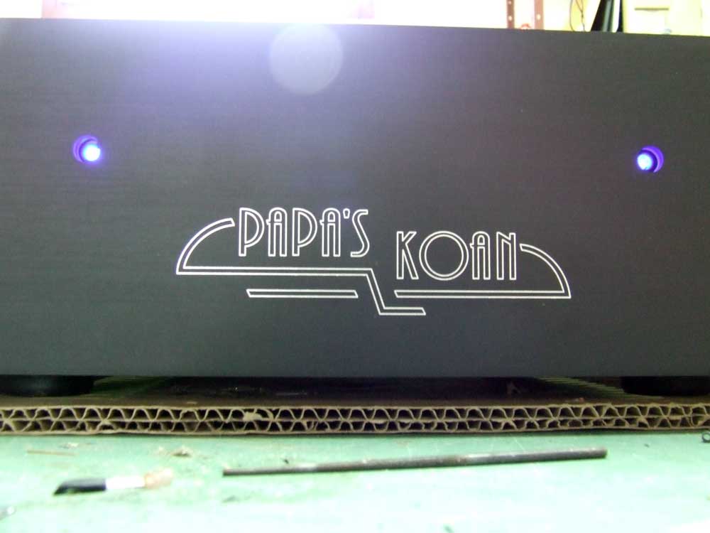

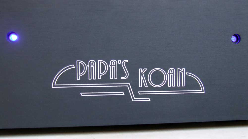

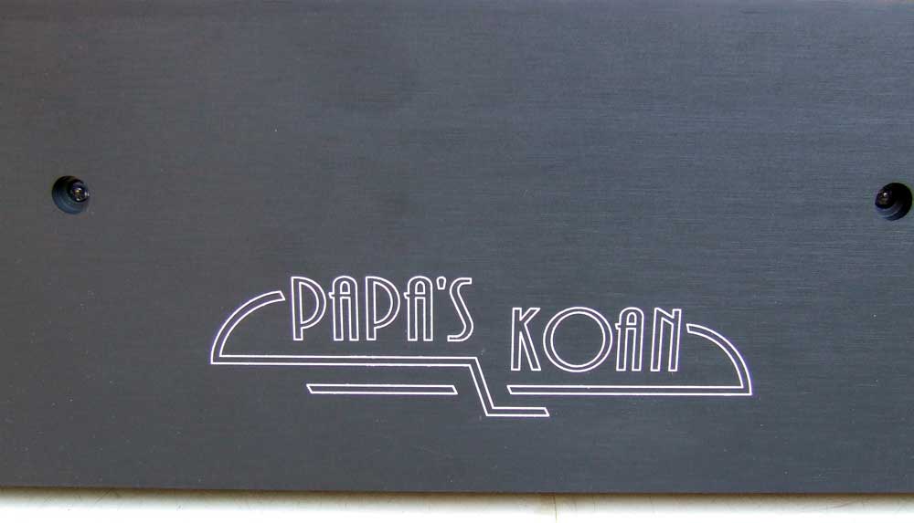

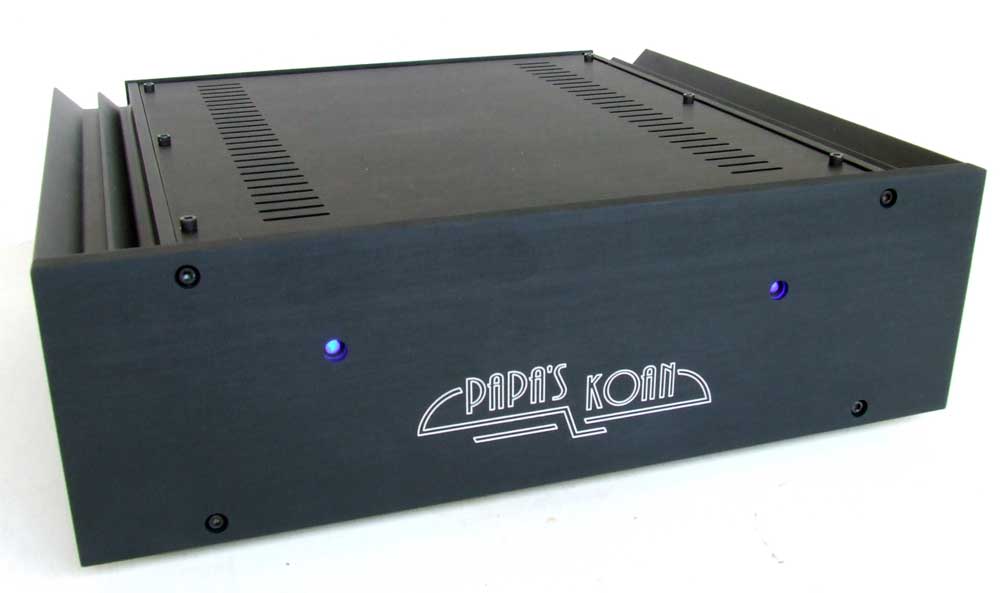

one funny thing is - major-trouble issue for Vladimir , and also major-laughing issue for me - fact that front plate was badly scratched in transport (probably bubble-wrap slipped and back side of zip in Samsonite made those scratches ) ,exactly where Papa's Surprise sticker is put , on pics in linked post above ;
I had instantly cunning plan ( I'm pretty often in Baldrick mode) to send front plate in capable hands of local Metal Guru - Leonardo ( nick on Baby Diya) ;
said and later managed - Leo cleaned existing elox , brushed , made new elox and Fugly! new logo .
possible similarity with existing FW logo is pure coincidence , of course , and your's Mighty ZM is responsible for that coincidence

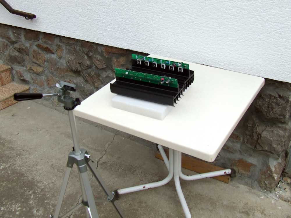

so - 'nuff typing ; now random pics

How does it sound?
exactly as proper F4
usual FW job - honest amp , no bigger than life ; I can't ask for more
