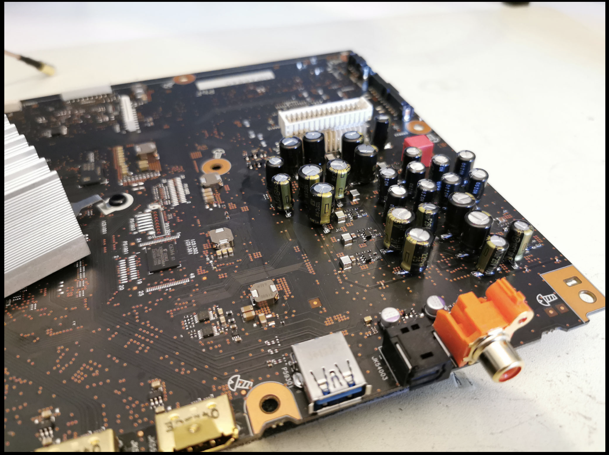

Tks, I am pretty sure the original caps are just SMD electrloytics on the digital board ? I have read about Wet Tants but most options are too big the digital board is small and the SMD's coming off are only 5mm or so and the board to lid height is only 15mm so not a lot of room.

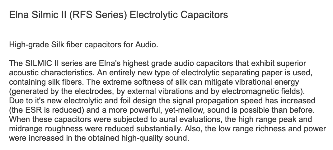

This was the mod from Authentic cinema.de on the digital board and drove my desire to experiment
I'm enjoying experimenting and whilst I could send it to anyone including Coris to do some work I am keen to learn and integrate in my system. I am so fed up of spending thousands and realising its not better in my cinema set up. As you probably appreciate with a multichannel set up EQ and time alignment and set up takes time before you can fully assess. I run manual PEQ's and spend time to measure across and 2m seating position.

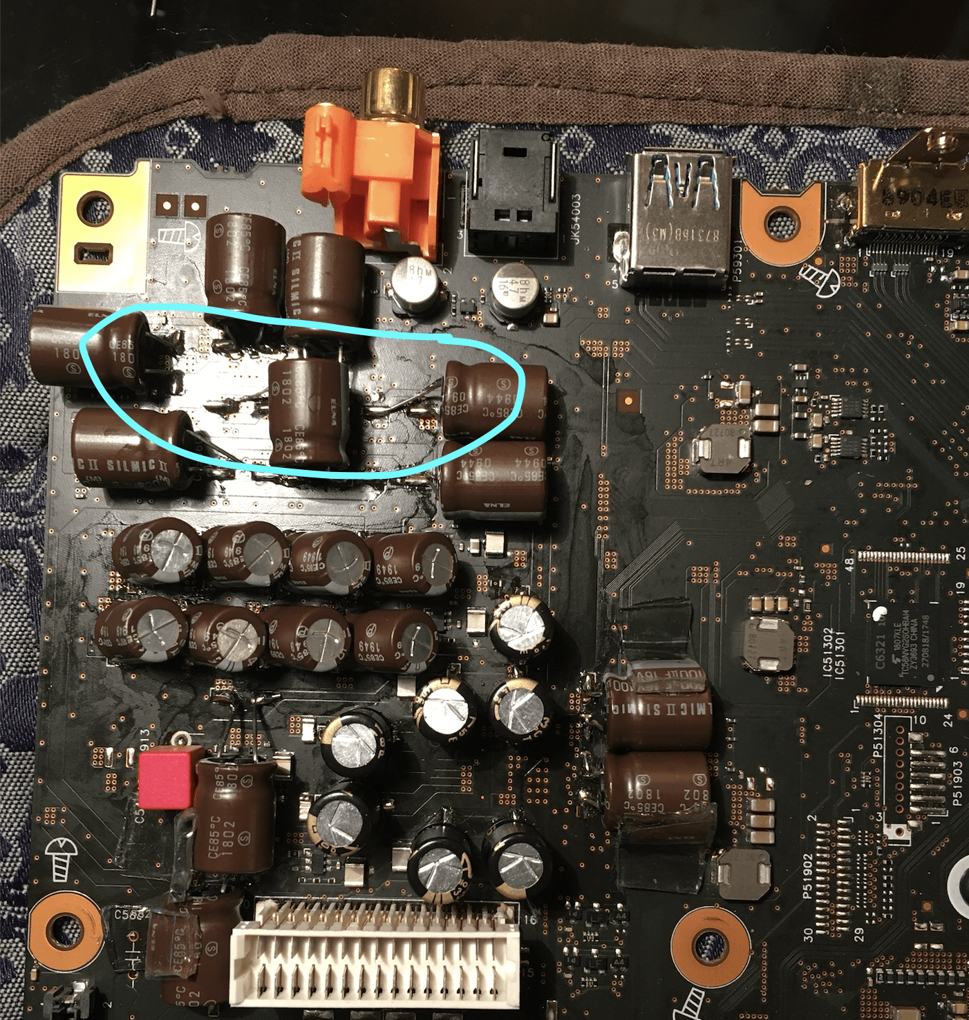

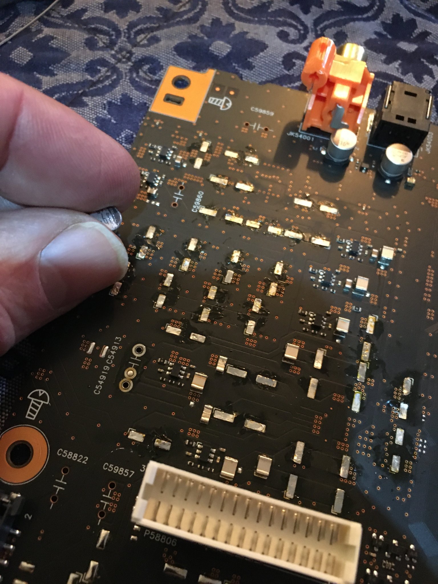

The most of the SMD electrolytic caps used in this player model it do a filtering/decoupling function and it are placed on analogic power lines paths. These are replaceable, and another caps with a better parameters it can do a very good job, improving indeed the circuits performances. The filtering caps used in the UB9000 device, for filtering functions, are not optimal in my opinion (confirmed by experiments/results also). It were used that components as a compromise for technological production process, availability, etc. Here is place for improvements. The only problem when replacing such caps, is the available physical space for such modifications.
I am quite sceptic when about replacing the small caps around opamps as in local SMPS circuits, as these are enough critical components, which it are chosen by the designer accordingly to the active components used, and the targeted circuit functionality.
Indeed, the placement of big dimensions filtering caps all over an circuit is not a good approach. An carefully appreciation may be necessary regarding the placement of such big components. It can impact over the main circuits parameters, creating parasitic coupling for signals, degrade the noise levels, and so on. So, even replacing the original filtering caps with better ones, but bigger dimensions, in some cases it can do more bad than good. In an analogic circuit, the negative impact of such big caps placed over active components, it may not be very important, as such sections it works in relative low frequencies ranges. However, as a rule, is better doing such modifications with components heaving closer dimensions to the original ones, in the limits of the available space. In some cases, this it could be a challenge indeed...

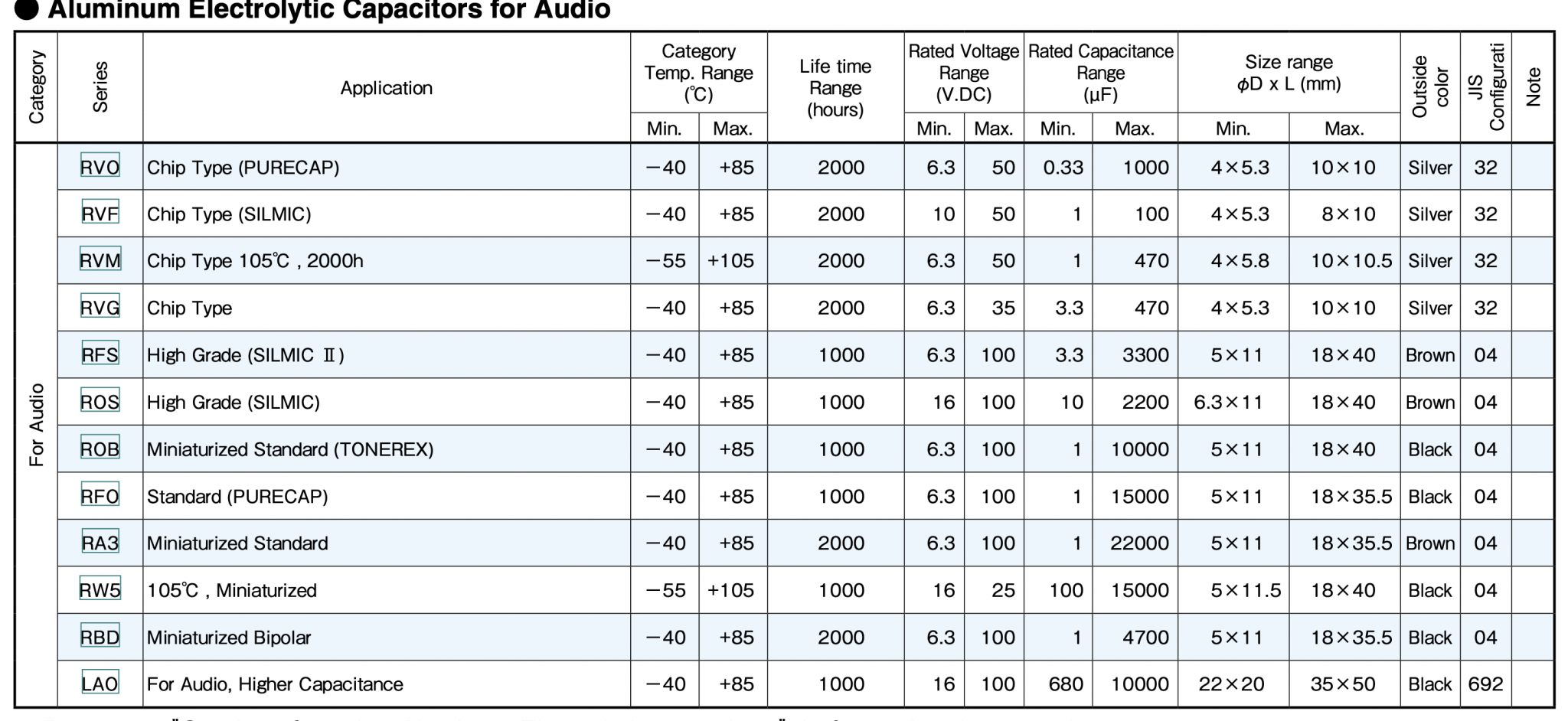

It doesnt say they are low impedance; it says they are lower impedance than the last silmic model. If they were actually low Z, they would specify the impedance in ohms at a range of frequencies. In my experience when a company makes high performance industrial capacitor parts their 'audio grade' typically means lower spec than industrial grade, but for more money .
@Coris Ah, I thought given the good layout and presence of what looks like (hard to tell the colour, but does look right) panasonic pps film SMD decoupling caps they may be nichicon polymer; as they look similar.

I am very pleased with silmics on the digital board. Much greater dynamics, more natural, more 'in the room' the voices are more real and better resolution without any additional brightness. More tonal density and body to the instruments and better separation. Very happy even if this was 'by chance' I have considered trying alternative high performance OScoms here highlighted in Blue to see if that is better or worse
