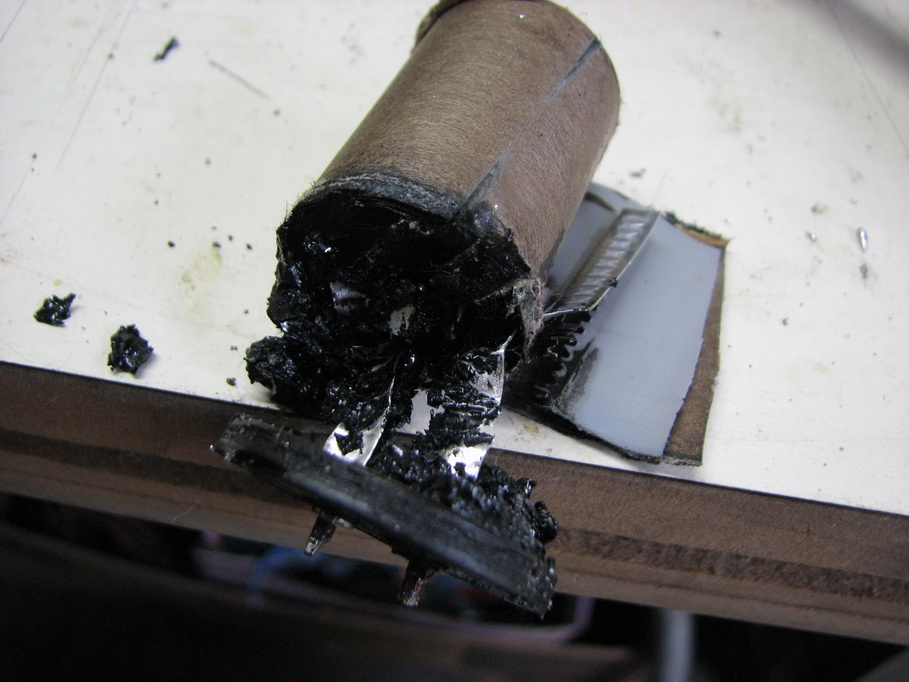

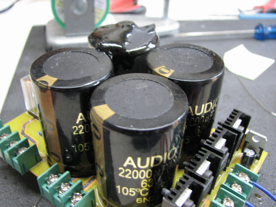

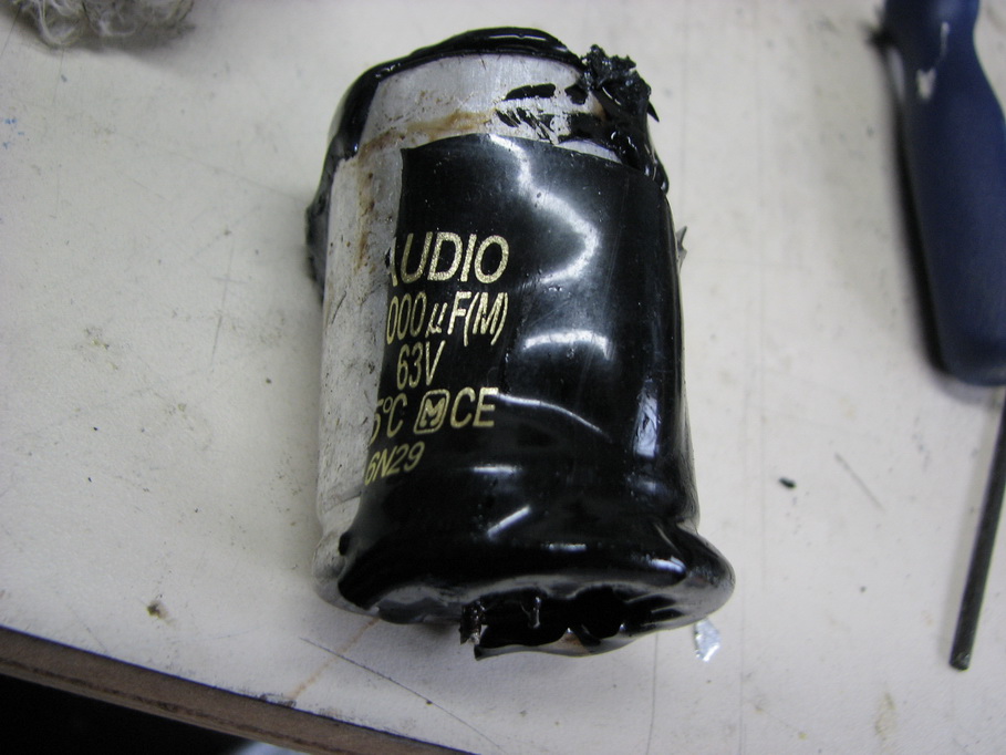

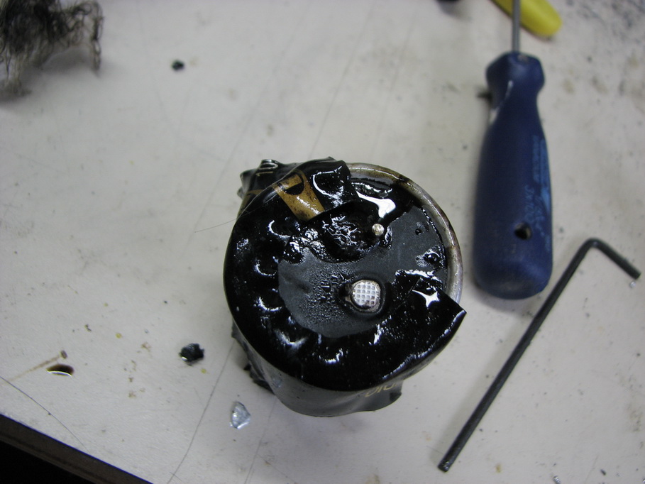

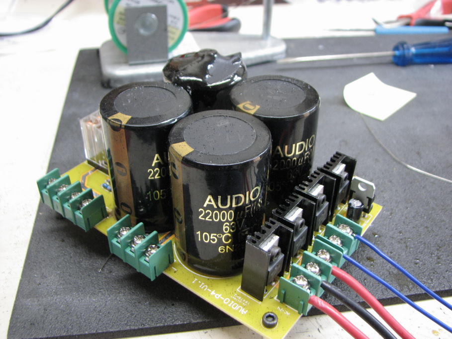

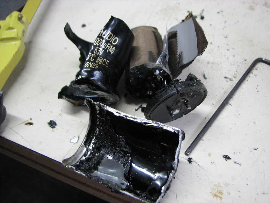

Hey I bought some capacitors no too long ago and they blown like pop corn. I tried 2 with the same resulted. At the beginning they started to get sponged, hotter and then they blown up. I trashed all 12. They looked same as your after they blow up. Save those for the 4 of July.

They look very dubious to me. There is a reason that the cheapest decent caps are about £10 each for 63v 22kuF! I suspect I've had fake LM3886's and a short lived CS8412 all in kits from china and my green dac from Analogue metric has some very dubious looking nichicon fine gold smoothers!!!
Never buy caps direct from china, its just far too easy to print heatshrink and sell ant thing on as "For Audio" etc. I suspect that the heatsrhink is on the wrong way round and you've connected that cap in reverse. You should remove the other caps and check the markings on the solder tags to see if the wrapper was the right way round.
Comparing his pics with the other online pics of the cap it looks like it was on correctly. The negative side printing is on the side by the lead with the black marking.
Could have very well been assembled incorrectly if they were hand made by tired workers who just don't give a ****. I doubt they even get tested after assembly.

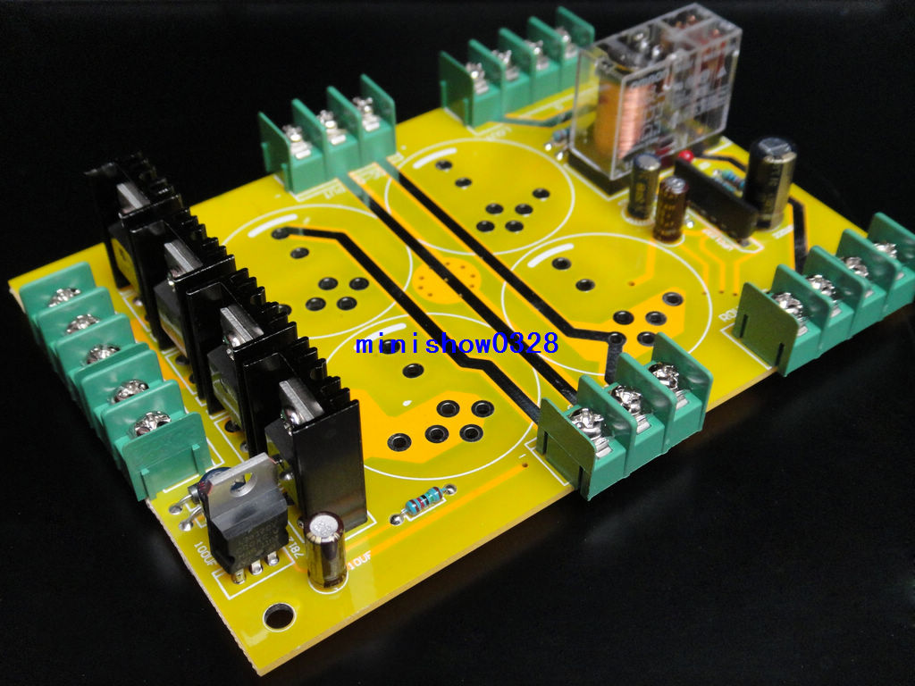

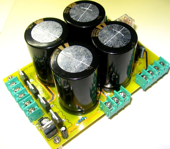

I found a difference in the position of the diodes D25SBA80. The image on the left of the seller Minishow0328 is inverted in relation to the right, Zoe Tsang Store.
But the observation of the price of U.S. $ 8 dollars for a unit is an indication that it is counterfeit product.
