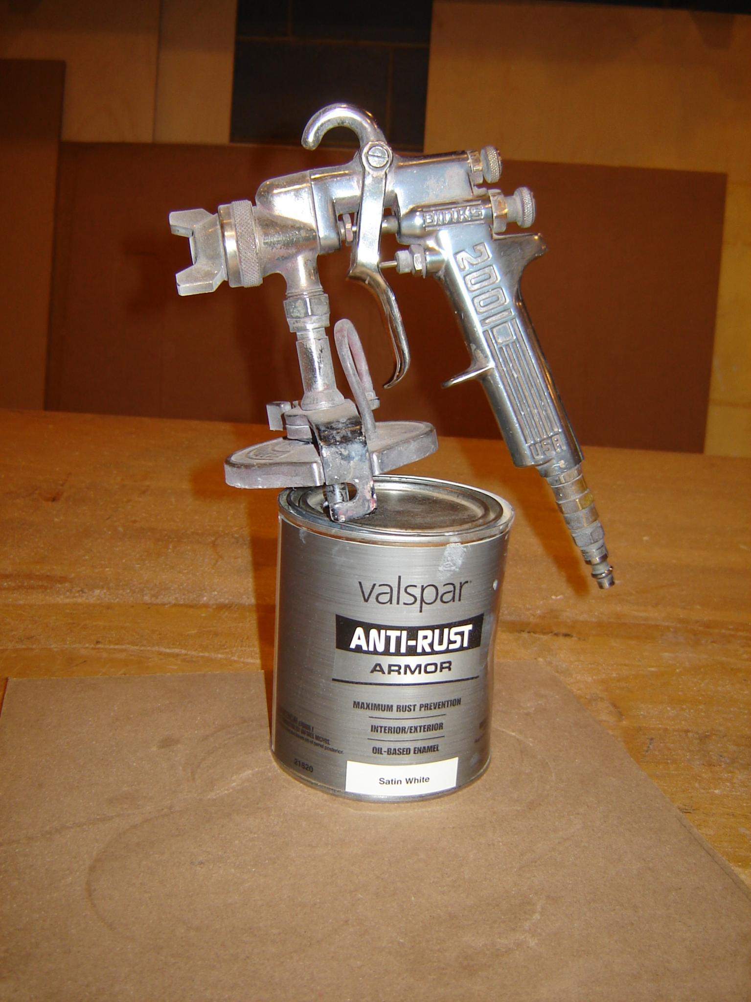

Well used the Semi-Oil paint; pretty happy with the cost vs. finish and coats need.
This is one sealer and one finish coat.
The only painting technique I seem to have luck with is high pressure/wide fan, stand back,
close eyes and pull trigger. :boggled:

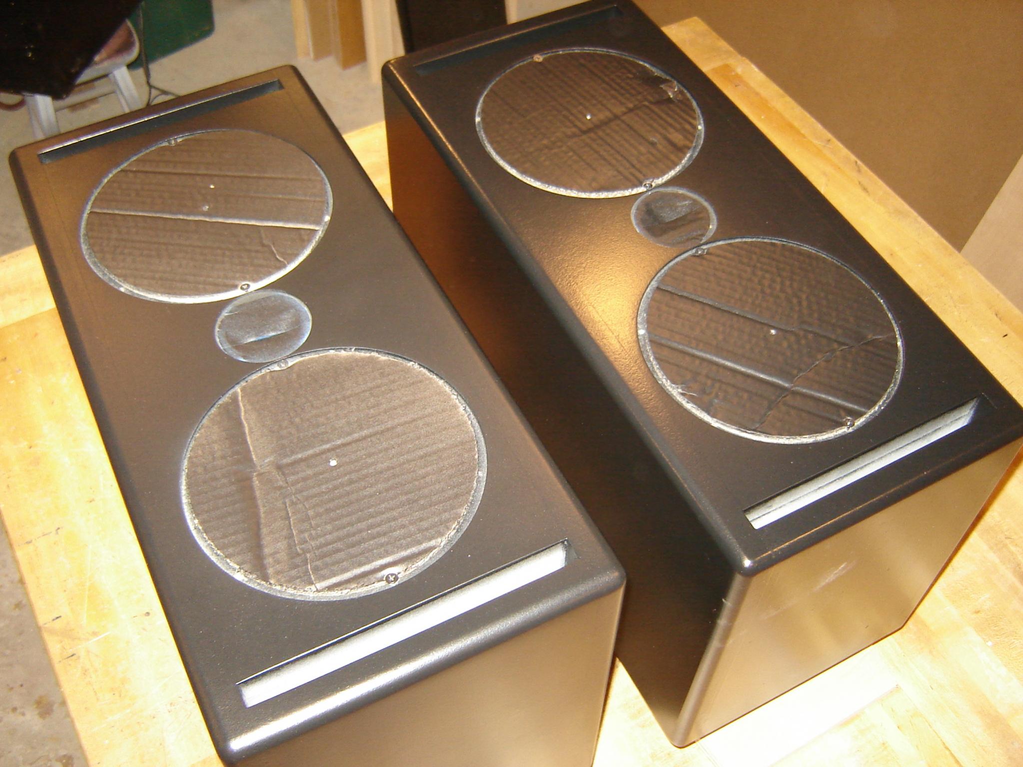

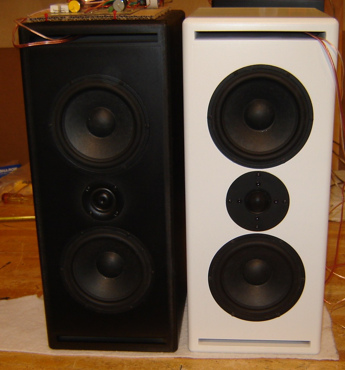

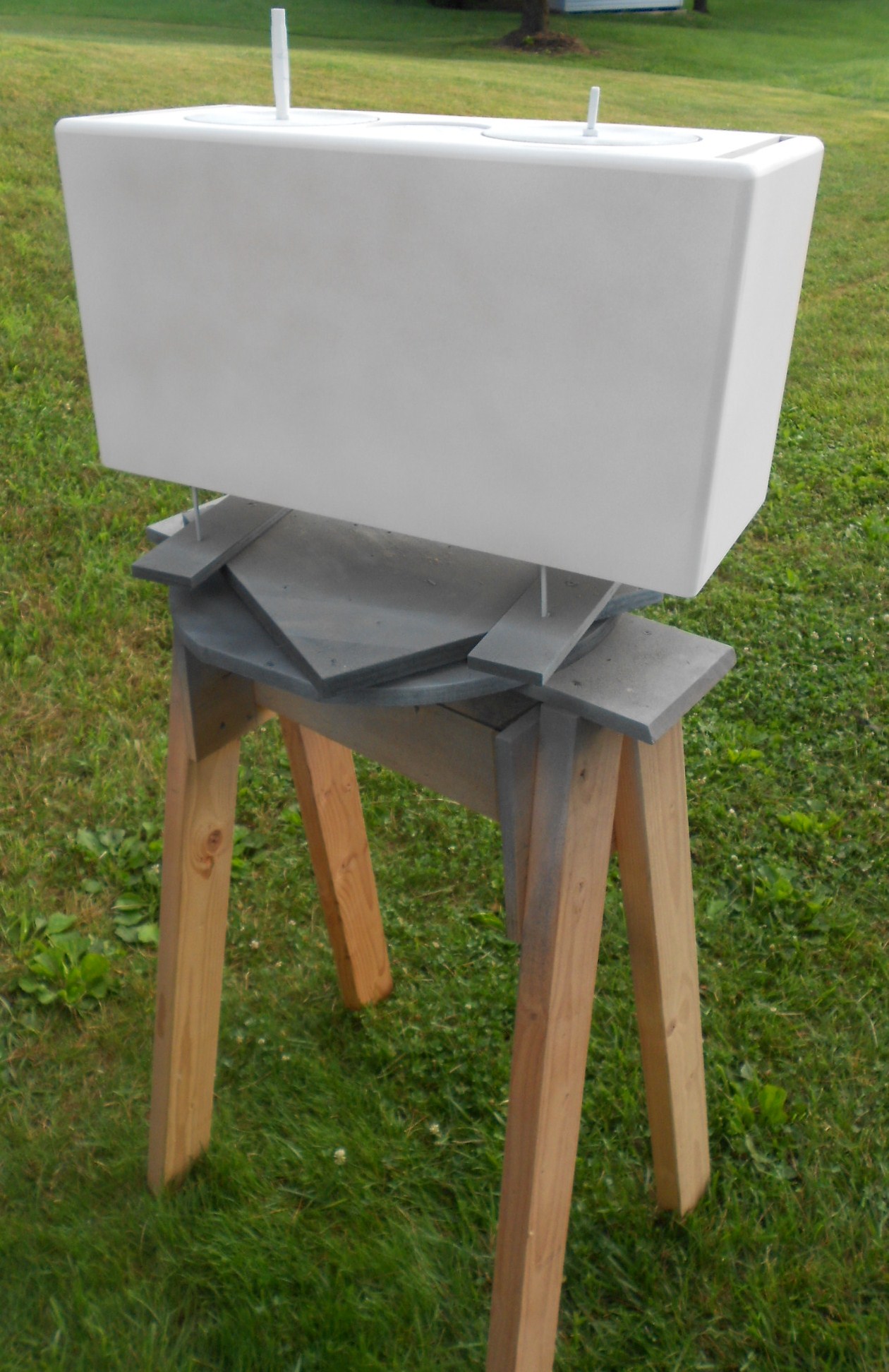

what rednecks do
This belongs on "what rednecks do" but it does work and saves a lot of thinner.
Works nicely if you just want to repaint a side, or stained top.

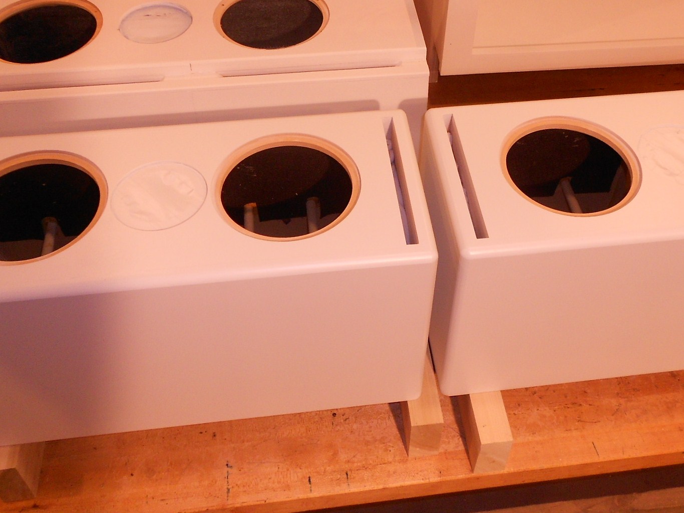

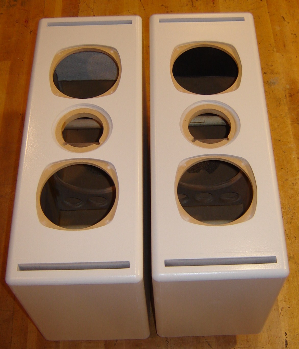

Really like the Valspar oil, only $10 at Lowes. One quart can finish a lot of projects. They say its the same paint as in the spray bombs.
The Zinsser oil "Cover Stain" primer works nicely - sands perfectly smooth; drys fast if left outside.
