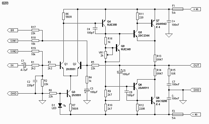

That voltage is too high. Parallel output transistors won't help.JojoD818 said:Hi!
Can I use my transformer that gives rail voltage of +/-63V to a P3A? Do I have to change anything?
I read that I can parallel output devices so can I use 4 pairs of 2SC5200/1943 for the output?

In answer to another question: To use parallel output transistors, use emitter resistors 0.1 ohm but otherwise connect them directly together. See ESP project 68 for an example.

You may have some trouble finding them. I think at least one of the transistors would end up needing a voltage rating of 100+ volts.

Raising the voltage that much (you are talking about a 50% voltage increase) will probably change the working point of the circuit's elements, so you need at least to re-arrange them a bit.
Output devices can be paralleled but in a different way, look at the 300W subwoofer project at ESP.
The final result is that your project won't be a P3A at all...
If your transformer gives +/- 63V and 80-100W are enough you can lower the rails either regulating the supply or using something like a lamp in series with the primary of the trafo.
If you need considerably more power go for a different project, like Holton's symmetrical amp, or the Leach amp, or whatever you like.

Andrea,
The only reason why I thought it may work is because I compared it to the 300w esp amp and it has very similar values for the resistors, etc. But it uses a +/-56V supply rail. However Rod said to be careful with the output devices so I will use lots of my stock toshiba devices.
If the mod works fine, if it blows I'll just stick to the P3A setup.

Those are feedback components. They determine the gain and frequency response of the amp.JojoD818 said:Hi,
Regarding the P3A, I just want to ask what does R4 and C3 do? Do these parts dictate the frequency responce?
Jojo
At DC, or very low frequencies, the capacitor acts like an open circuit and R4 and C3 are effectively out of the circuit. There is 100% feedback, so gain at DC is 1. At higher frequencies, C3 becomes more like a short circuit so gain increases to R5/R4 = 22 = 27dB.
C1 also affects low-frequency response. It forms a filter in conjunction with R2.

I have just built a modified esp3a amplifier, running at +/-52V, 4 ohms load. Works and sounds good!!!
Powersupply/channel:
One 500VA toroid transformer
Two 47000uF 63V RIFA capacitors.
Amplifier:
Q1, Q2, Q3, Q9 = 2N5550
Q4 = MJE 350
Q5, Q6 = MJE1503x
I use two pairs of Sanken 2SA1216/2SC299 transistors each with a 0R1 5W emitter resistor.
R9, R10 = 3k3
Q4, Q5 and Q6 need to have small heatsinks.
I also placed Q9 (Vbe multiplier) at the top of Q5 to have a very stable bias current.
Otherwise I haven't done more modifications yet, but I'm thinking of increasing the current through the input stage and VAS stage and add degeneration resistors, and a balanced input.
/Freddie

Freddie,
I wish you can update me to any other mods you do so that I can also mod my P3A. Mine is running at +/-63V right now (happily).
Transistors used were:
2N5551
2SD669
2SB649
2SC2344
2SA1011
2SC5200 X2
2SA1943 X2
BTW, I attached (using mica insulators) Q9 to tha main heatsink not knowing if it's really necessary. Any suggestions?
Actually (if I'm not mistaken ) The gain is (R5 + R4) / R4 = 23

Well, I haven't done any more modifications than replacing a couple of transistors and two resistors, yet!!
/Freddie
/Freddie
"If I increase or decrease the value of C3, what happens? Does the bass response vary with C3?"
As I mentioned, there are two low-frequency cutoffs. The first has a cutoff (-3dB) frequency of 1 / (2*pi*R4*C3).
The second is 1 / (2*pi*C1*R2).
