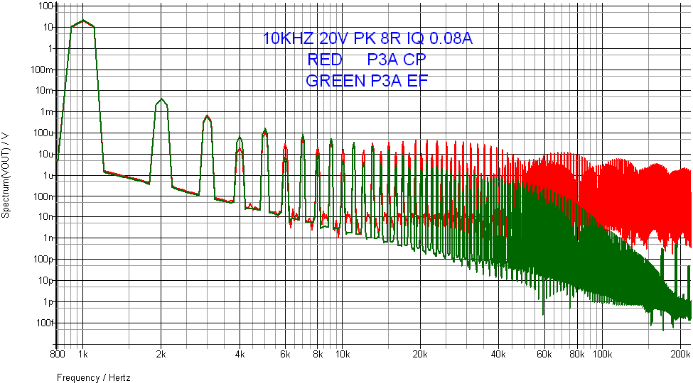

Distortion In Power Amplifiersthough it is noticeable that the EF gives a good deal less distortion at lower power levels around 1 W. This is an unexpected observation, and is probably due to the greater width of the EF crossover region.
P3A works better , in sims at least, with EF than CP.
TMC will not improve a CP version by much but in conjunction
with an EF OS , it will improve the THD ratios by some margins,
although the result will surely be unoticeable in listening tests,
but who knows..
I know the article. However, for what I could understad, the explanation of the phenomena is "unexpected". What is well documented is the different linearity of the two stages ( being the CFP about 1/4 deviation, although more concetrated), if you look at the graphics.
Funny that i elected to use the ones on the third curve ,
2SJ50/2SK135 as definitive devices in almost all the amps
i built since late 80s...
Indeed, they allow very good stability and very wide OLG.
As pointed by Tekko, CFP are less stable when used in amps
that have global NFB , and this show in simulations by wider
bandwith of THD residuals.
