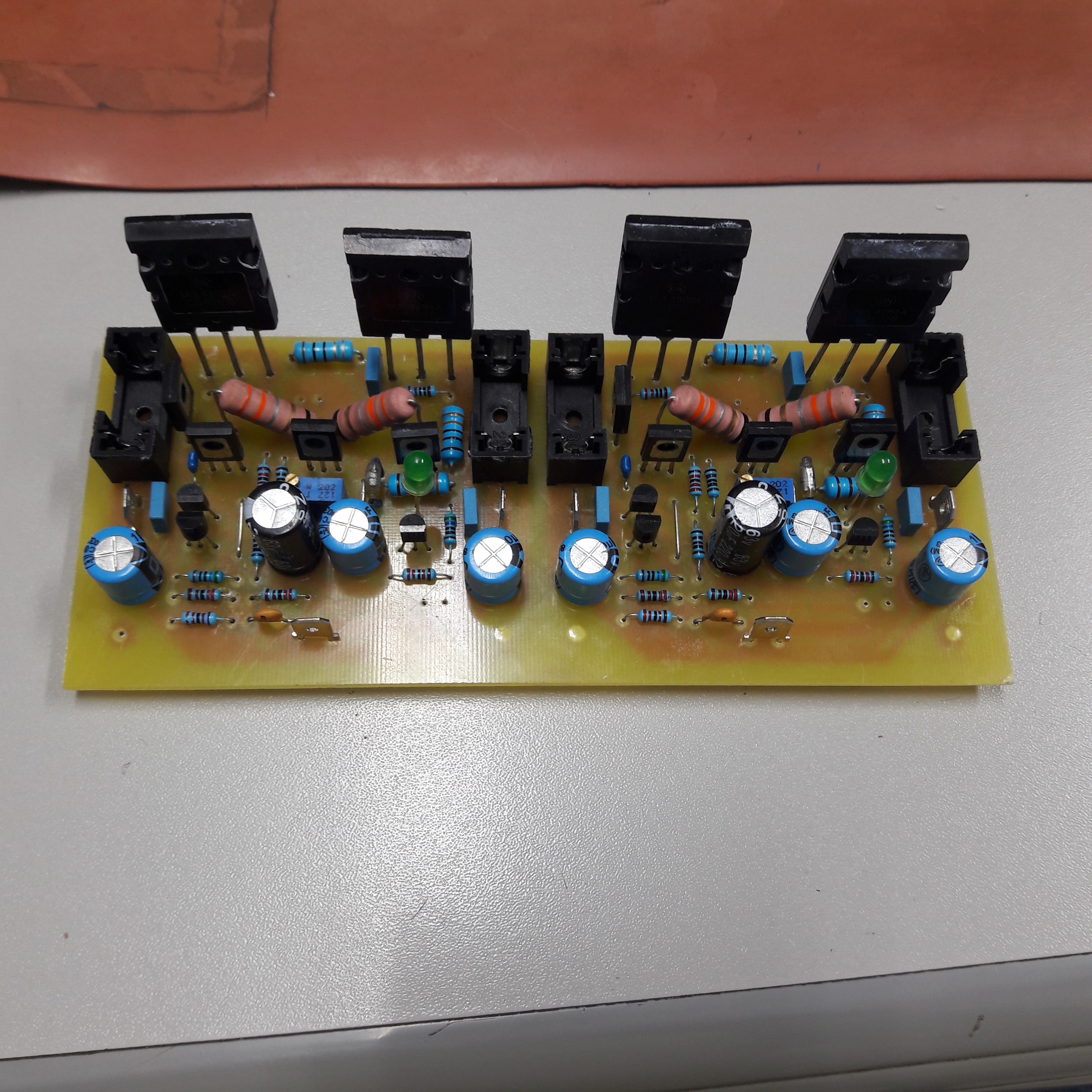

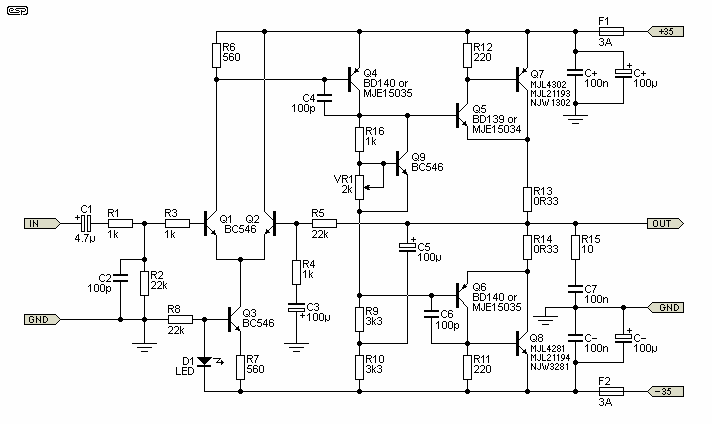

Hello, I'm assembling a p3a, Alexmm PCB, I have a question about capacitors: what would be more suitable for c + and c- is ceramic or polyester?
And for C2, filter, a polyester or common ceramic ?
Those are the options for now, quality polypropylene are difficult to obtain.

Polyester caps are only just ok in quality audio circuits - seldom specified now. The function of those 100n caps in parallel with "C+" and "C-" is to augment the filter performance of those electrolytic bypass caps at high frequencies, where electrolytics can be less effective at filtering noise. So it figures that unless the film caps have much better high frequency performance, they probably don't help at all. In fact, they are seldom specified nowadays and you don't see them on schematics here at DIYaudio.
In most cases, just fitting modern, good quality electrolytic caps alone means the 100n film caps are redundant. There would be little point to fitting the film caps unless they were high quality types such as polypropylene film, not cheap polyester or ceramic caps since they there to improve performance, not just come along for the ride. Otherwise, they are not necessary.
The 100p capacitor is an RF filter cap. so it needs to be effective at frequencies much higher than audio, so cheap ceramics and polyester caps are out. Most audio amplifiers used polystyrene fim caps in this role but it should also be OK to use genuine NPO or COG grade ceramic caps there. I doubt 100pF value polyester or polypropylene film types time will even be be available anyway.
As always, beware of fakes and low grade components unless you use reliable, commercial parts distributors for your components.
