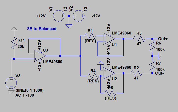

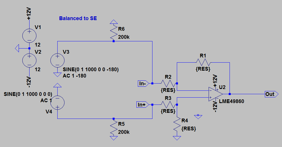

Looks like opamp time, would you need anything better than a TL07x for a s/e to bal converter (& visa versa) (1Khz @ 2Vrms)? I cant remember the unity gain distortion figures, was it decimal two or three zeros? recommendations anyone?

These are the circuits I have bread boarded (though I need to revisit, as I pulled it out and was not able to reproduce my previous results). I'm going to make up some new cables as well as I think perhaps the main issue is to keep either of the differential inputs from being connected to the shield, and a passive option may be possible.
The Balanced to SE I originaly used 2K resistors for {RES} thinking I needed low values to keep the noise floor low, however I think I tested with 10K and it made virtually no difference (noise floor still below -120db)
With the SE to Balanced circuit 10K also worked fine (though for some reason I had 6.8K in spice... i think I was trying to find the sweet spot for lowest IM distortion in the sim).
Both circuits I bread boarded with 100nf decoupling caps on the IC's. I ran off two X 12V gel cells. I used LM4562 op-amps and 1% resistors for {RES} but for best noise immunity 0.1% (or better) resistors should be used. Earth routing is VERY important. I've yet to do a layout for this, I think I will work up a verro board version first.
Both of the circuits below should be considered experimental and not fully debugged at this stage :) I think TL07x should work fine as well, though probably with not quite as good distortion performance as the LM4562's
Tony.

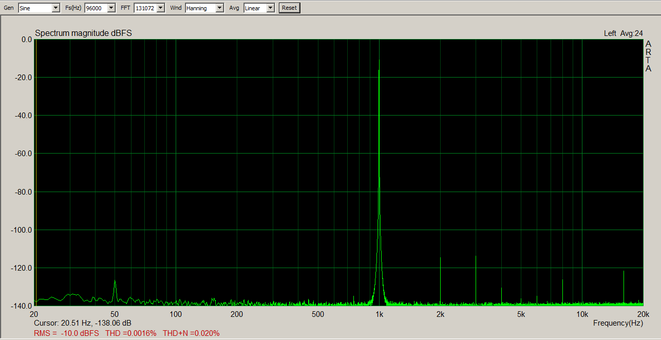

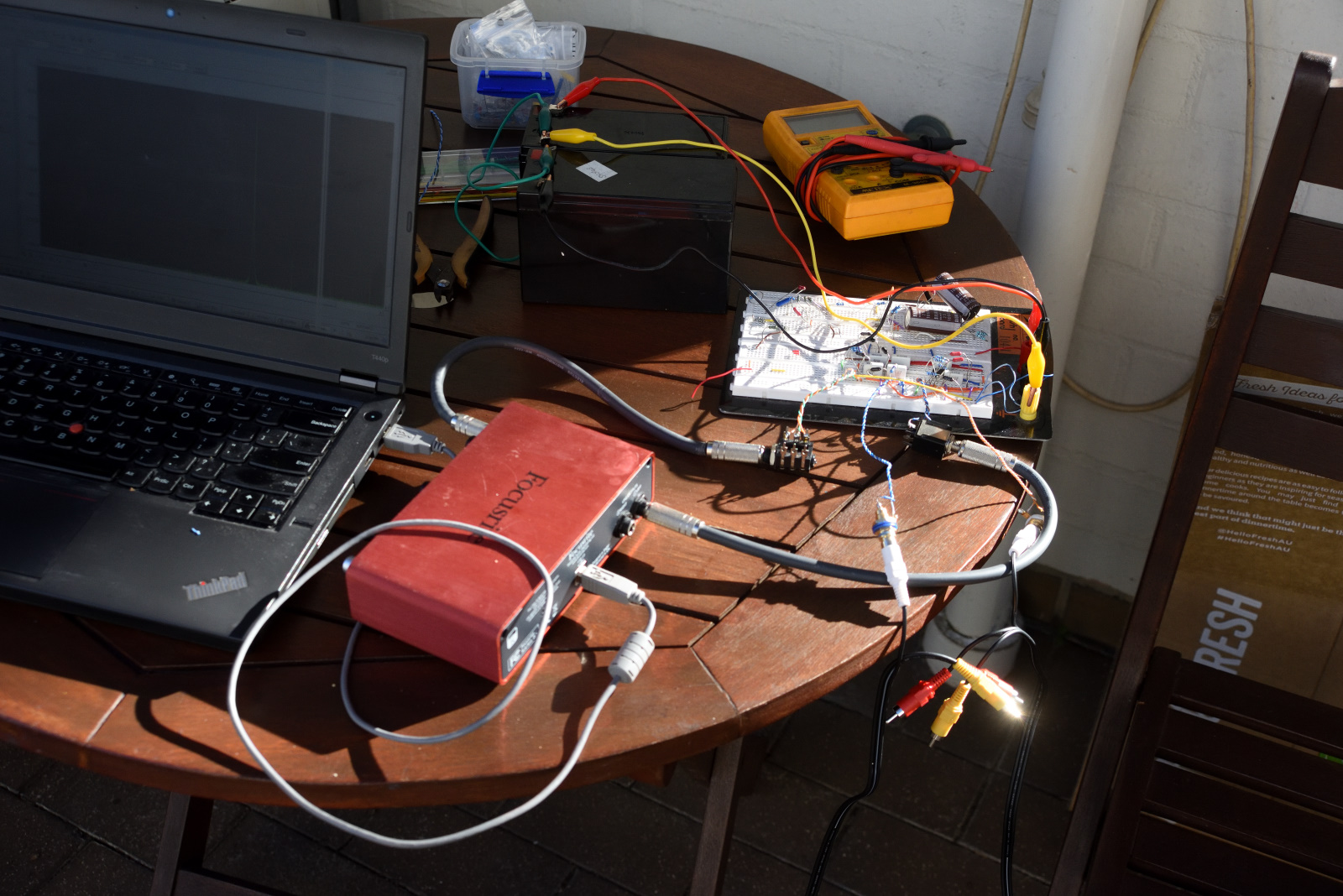

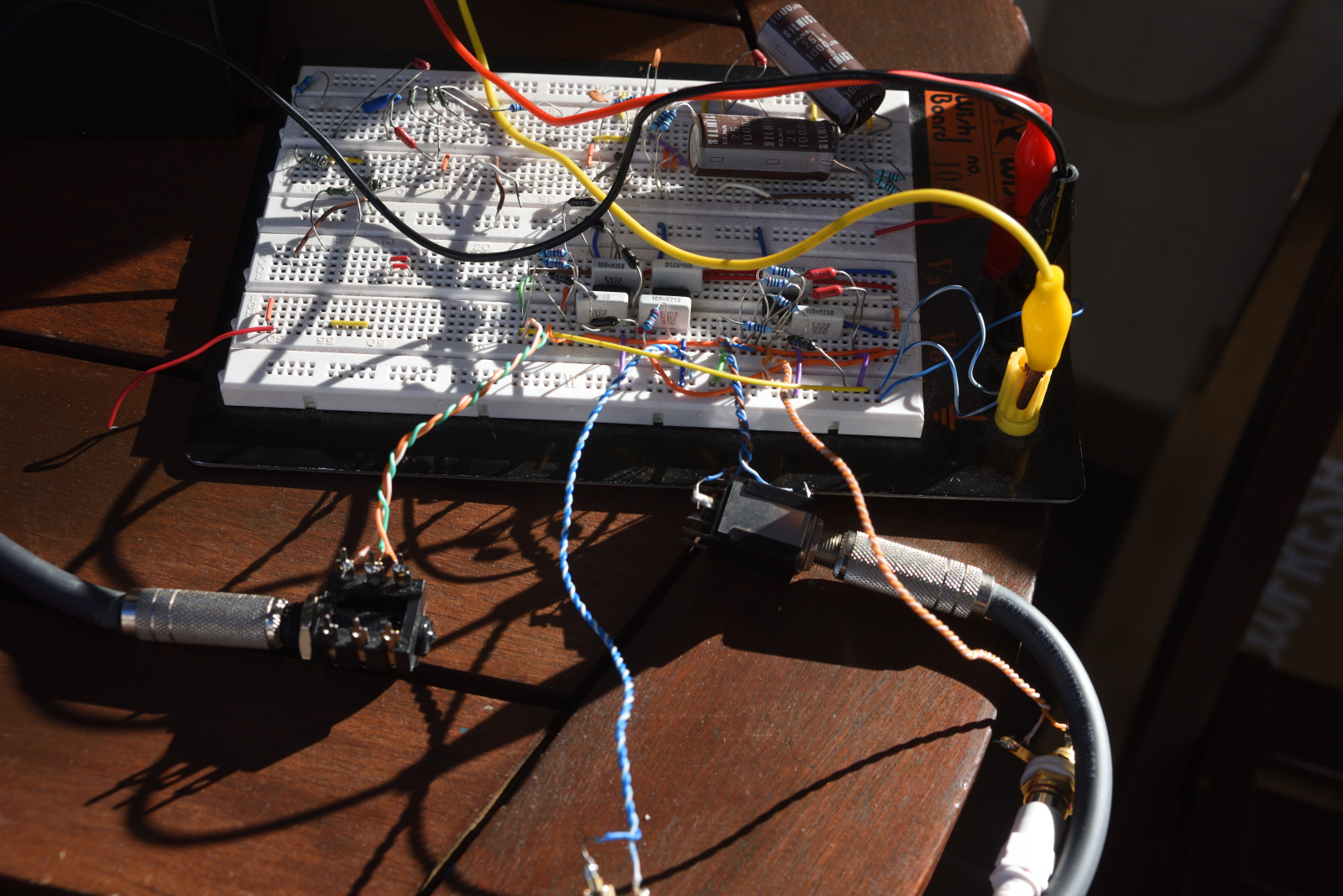

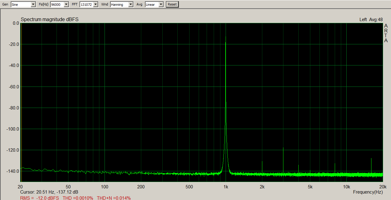

I've done a few adjustments and done some more measurements. These are using variations of the circuits posted above with resistor values that I had on hand in 0.1% Not quite as good as straight balanced loopback, but a whole lot better than an SE loopback!! When you see the pics of the setup it should be apparent that they can only get better with good layout :D
I'll post what is actually on the breadboard a bit later. Other values would probably be a bit better, but I just went with what I had on hand.
Note that the best results for this config seemed to be arta generator set at -10db and input pot configured to read -10db. Note I have not calibrated ARTA!
I also tried the switch in the inst position. The gain is MUCH higher. I had to turn down the generator to -25db and the noise floor rose to around -100db so inst setting is a no go.
Note also that mine is a first gen 2i2, the ones available for purchase now are 2nd gen, however I believe from testing that has been done here on diyAudio that 2nd gen also suffer the same degredation when running SE.
Tony.

I did some more tests this afternoon. I found I had already made a new cable (and forgotten about it). Provided the earth connection is kept out of the picture for both output and input the loopback at least looks good. When lifting the output shield to the balanced to SE converter and taking the output of that to tip and ring of the input with no shield the results are on par (or in fact better) with those when passed through the SE to balanced comverter.
If the output shield is connected to common however then the results are no better than when using straight mono loopback cable.
Attached is the result with only the balanced to SE converter and the rca to TRS cable on the input.
I can try a test with just tip and ring for both output and input through an audio device and see how that goes. certainly loopback with just tip/ring and no sleeve gives comparible results to the bal to SE loopback posted in this post.
Tony.

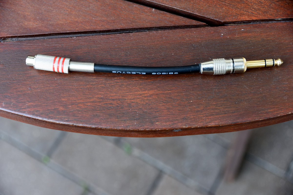

I have ordered some TRS to RCA converters to test with. I am quite sure that the Tip is connected to the center of the RCA and the Ring is connected to the Gnd of the RCA and the Sleeve is not connected but will check that when I receive them. Then I will use the Line settings of the 2i2. I hope it is possible to adjust both channels in the same time so they can be adjusted equal. It would also be nice to see an analog representation of the signals so e.g. the phase of the 2nd harmonic can be adjusted relative to the fundamental......like in 6l6s video.
