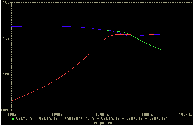

heres is a zoomed graph...
ajju
Erhh... Where? :) Ahh There (popped up whle I was writing).

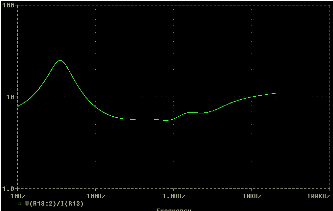

Anyway, the component values seem OK, the Fs = 1/(2pi*sqrt(CL)) = 37 Hz and Qms = R/(2pi*fs*L) = 1.5 from the values in the diagram. Re and voice coil impedance is also OK.
There *should* be a peak in the impedance of 18.8+5.8 ohms at 37 Hz. Does the program model the impedance from the diagram, or do you enter the diagram separately in some way?
Many thanks for the review Svante...
Ok...next step..integrating these into the X-over...And see how they show up..
that will be tomorrow...its past 2am here...:) and need another 20 min drive to get home..
No i force the impedence to be calculated...
basically from the node parameters Pspice calculates...
so i basically add this to the graph..and bingo u have the impedence plot..
X ~= V(R3:2)/I(R1)
Voltage at node/Current at node after the source resistance.
thats how i go about it..!
thanks
ajju

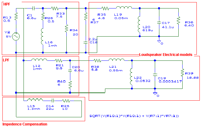

Crossover:
This is something that i have arrived at finally.
Comments are very welcome. :)
thanks
ajju

I agree that by interpreting a circuit simulators output correctly....
Yes Sreten,
We do agree with you. There are a lot of things which you cant model on a circuit simulator. But one needs to have something to start with (of course u have proven designs which can be taken and tweaked) but when it is done afresh,i presume some kind of modelling has to be done as a starting point.
Once a basic architecture is arrived at, it has to be tweaked in the real system to get close to the goal. As i understand a circuit simulator might be of great significance in looking at the impedence plots etc..so as to predict how difficult a load the final design is going to be for the amplifiers.
Moreover it is not always possible to get a straight line response without a lot of trial and error, and the simulation data should be of great help in this stage.
