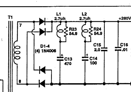

You can tell this to ARC as well. They might even have a patent for this.
Thank you very much! I am so sorry because i am late:( Someone had already thought this and have a patent! . Anyway, what i am thinking was right and i can arrange my powersupply unit in same way. Of course i will check the frequency response of the low-pass circuit and whole circuit by using an oscillator.

I analysed ARC circuit.
Current up to 5Khz comes mainly from the 470uF electrolytic capacitor. Between 5Khz and 80Khz, current comes equally from both electrolytics. Between 80Khz and 5Mhz the 2uF capacitor provides the current. The 10nF bypass is a bad joke. Actually the whole circuit is a bad joke and a marketing tale because the electrolytic capacitors are the ones supporting audio frequencies.
Supply impedance contains a large resonant peak at 93Khz and another bigger one at 6Mhz, but both disappear if L1,L2,R23,R24 are removed :D:D:D The 93Khz peak will probably compromise amplifier stability.
