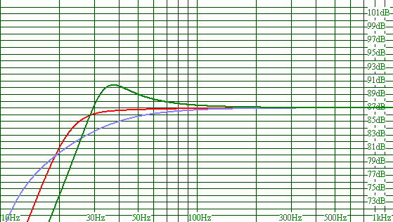

Below is a graph of the same driver-ACI SV12, in two enclosures.
The red is a flat response, in a box 8.2 cu ft and tuned to 18 Hz.
The blue is in a box half that size-4.1 cu ft, and tuned to half an octave higher-25 Hz.
This setup has been suggested by David Weems in his book Designing, Building, Testing Loudspeakers. He recommended for a hobbyist-not so much someone after super hifi, but a good, serviceable way to put a woofer in a smaller box. You get a 2.3 dB hump in the half-size box.
The sound isn't bad, and some people like that slightly fat bass sound. I think this illustrates the principle.

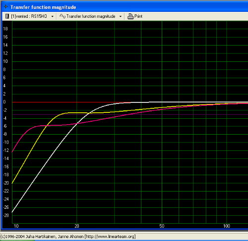

Here is a better idea of what is being discussed. The driver used in this sim is a Dayton RS Series 15" HO Sub. FS on this driver is 21hz.
White Line: Max Flat Response, 3.55 ft^3 tuned to 22hz
Yellow Line: EBS -3db, 7.1 ft^3 tuned to 16.35 hz
Magenta Line: EBS -6db, 8.3 ft^3 tuned to 12.76 hz
As you can see the bass in the EBS alignments start rolling off earlier however extend the bass lower at the expense of spl higher up. So that would give you your "weaker" bass because the EBS -3 alignment is a full 3db down at 30hz where the flat response alignment is just starting to drop off at 30hz. However, at 17hz where the EBS alignment starts to roll of it's shelf the max flat is almost 8.5db down.
AS in all things speaker related it is a compromise. Extend the bass lower, or keep the power up for a sharper rolloff higher.

Olay,just to illustrate this even more, I am taking elambert's example of the Dayton RS Series 15" HO sub, putting it in a 3.5 cu ft box, using a 4" diameter port, and giving the response for three different port lengths. For all three curves, the box is 3.5 cu ft and the port diameter is 4 inches. The tuning frequency is in parentheses.
Green-7 in long port, (31 Hz)
Red-16.67 in long port, (22 Hz)
Blue-38 in long port, (15.4 Hz)
Red, of course, is the optimal tuning, green is one half octave above optimal tuning, and blue is one half octave below optimal tuning.
I hope this illustrates what happens when you vary the length of a port.
