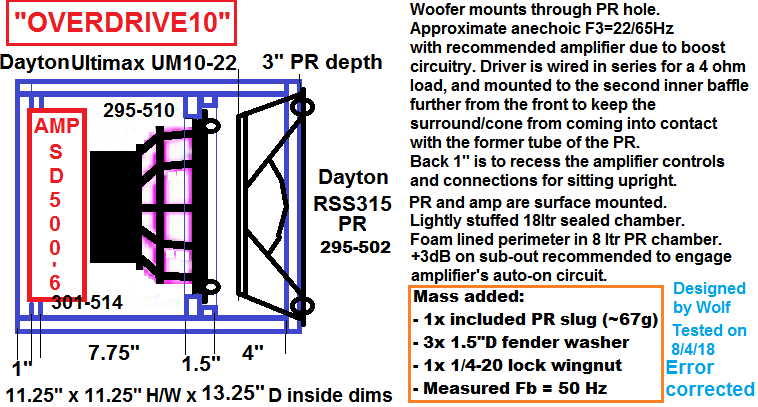

Addendum:
First off- I sincerely apologize if this mislead anyone, but I actually have the woofer chamber measuring at 7.75" deep. I vaguely recalled upsizing the volume a smidge for braces and the magnet structure, and the old graphic said 7", so that is what I thought I built.
The woofer measures about 5 5/8" deep if surface mounted, and the Yung SD500-6 is about 2 7/8" deep- It's pretty apparent that it would not fit if it were just 7". By my measurements in my actual box, the heatsink on the amp is virtually touching the magnet backplate, but I'm not really sure of a way to actually measure this distance. They don't appear to touch while mounting the amp.
Here is the CORRECTED GRAPHIC, as I cannot edit the original post.

That would be a great design to get as small as possible while getting down to the deep stuff.
Correct me if I'm wrong, I am assuming the outside dimensions at 12.75 H X 12.75W X 15" D Makes my 4.1 cubic foot 12" sub with 18" PR tuned to 21Hz look huge! That would be a great design for dorm rooms, bedrooms and work areas--great job on a bandpass with PR, the unicorn lives!

Very interested in building this sub. The one part about the construction that I’d change is a solid baffle on top, instead of having the 4 tangential corners glued into the walls. I’ll most likely model this whole thing and draw it up on CAD. I can send you the PDF when I’m done with it, if you’d like.
As long as the front chamber is 4" deep, and the sealed chamber is 7.75" deep, and the inside height and width are both 11.25", then it should perform as mine does.
I'm assuming the PR mount is what you are referring to. Just make the sides/top/btm 3/4" less long, and you'll be good to do as you are thinking. In the construction, it was easier to have all 4 boards the same size, so that is why I built it like I did; fewer cuts.
However- I will be applying hardboard to the surfaces to improve the looks aspect before I finish it.
