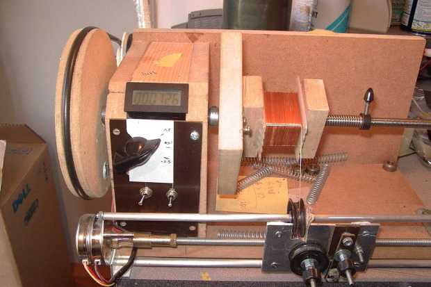

By the way, you have posted a pic with a very nice bobbin.Where do you find it?Do you wind OPTs with this kind of bobbin?

Thank you so much Resident, you are the first one to say that my bobbin is "Nice". I made it with a unique system and a very special material. It took me a lot of time to design it and a lot of effort, becouse I think this is a very important part of a transformer......but.....everybody told me this is "Ugly". And I become to start to believe in that.
It is made from a shet of Tufnol 6F/45 a very good material with high quality characteristics such as isolation, strengt etc... But it is utterly ugly!
Never mind. If you like I can post a picture of the plans. But don't blame me if your neighbors say it is ugly.

Hello everybody,
Hi resident,
You are right stating that it is impossible to made two sections equal each other, but.... williamsons OPTs were made that way, and how could be significant the difference between the two sections compared to the tubes tollerance? Splitting the windings in two section there could be a lesser stray capacitance at least 1/4 times the same windings on one section, as is stated on chapter 5 of the Radiotron. This is why I'm experimenting it. Till now I winded all my transformers with 5 to 9 interwinding layers but in one section only and they are working very fine. Now, I have to find somenting else to make things worse
Next, the material is from RS-COMPONENTS Tufnol, it comes in sheets of 1feet by 3 feet by 2 or 4 millimithers thick.
All I used to work the material is a jigsaw and a milling machine with a bit of 4mm. After all pieces are finished, I assembled them out and glued togheter with a cianoacrilic (loctite) glue. It holds very tight with tufnol material, the right way it is needed for the pourpose.
I allways use normal silicon grain oriented steel same used in line transformers, since I like to build bigger transformer than needed since I found the bass extension very pleasent. So I find the use of extra permeability cores expensive and not so convenient.
The core for the bobbin is 1" by 1" square EI type.
Nevertheless I think, sometime in the future, I'll try a double C core from Metglass, but is still not very easy to find that material in Saudi Italy .
http://www.metglas.com/tech/index.htm
Here are the pictures of the making of the bobbin from the sheet, I think they are explainfull, if they aren't, ask an I'll post you the blueprints.
Sincerely Larry.
