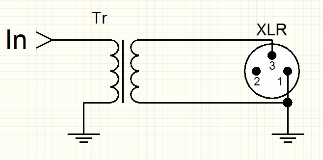

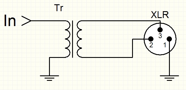

Can a trafo with a single secondary drive a differential amp input when the primary has a differential input with no ground reference, like with Sabre or AKM?
I can understand the need for 2+2/0.5+0.5 to get a differential output when the primary is referenced to ground (like PCM1792 or single ended DAC), but it seems like you shouldn't need it for the 9038 .
BTW I am using your trafo with TDA1387 NOS DAC at the moment.
The trafo is a much better match for this NOS DAC than the 9038Pro DAC, it sounds better than any delta sigma DAC Ive heard too.
There is no relation between both the primary source + coil (no matter if it balanced or single ended signal applied) and the secondary coil\coils, because they are galvanically isolated. I have version 1:2+2 too. If your amplifier can handle sound without ground reference then yes, you can use only one secondary coil.
