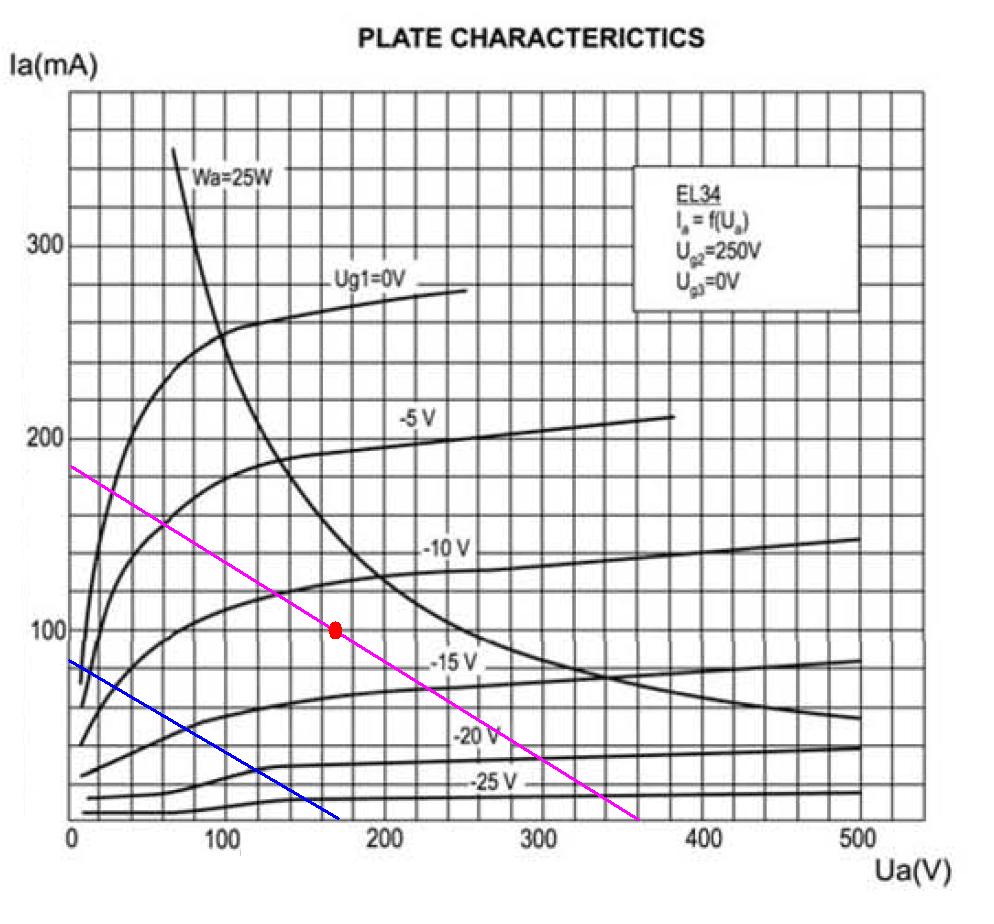

I was wondering if I can do a similar thing with output transformers. Output transformers are very expensive and sometimes hard to find. The ratio needed from primary to secondary is about 1000:1. So output of valve amp goes into a 240VAC:12VAc transformer then into a another 240VAC:12VAC transformer.
Would this work ?

I was a bit out with my 8000:8 giving a 1000 times ratio. I will go back and read up on transformer theory and work out impedance ratios.
Nigel, the thing to know about transformers and turns-ratios is that the impedance ratio is the square of the turns ratio. The voltage step up (or down) is proportionate to the turns ratio. The matching to the amplifier, to the impedance ratio.
8,000 : 8 Ω impedance ratio is √(x/y) = √( 8000 ÷ 8 ) = 31.6 turns ratio. In 0–120–240 primary land, that'd be 120 ÷ 31.6 → 3.8 V secondary. In the 240 primary land, the secondary would be 7.5 volts. Kind of an unusual transformer.
But then 8,000 Ω is kind of unusual for a modest duty output stage. Lots of volts, little amps. SOME OTHER THINGS…

Thanks for the detailed explanation. Clearly the power supply side function is fine because it is 50Hz.
I did look up the transformer impedance ratios and found the mains to 12 volt transformer to be 3200 ohms so it is about right for my amp. However as you say heating will be a problem at higher frequencies.
