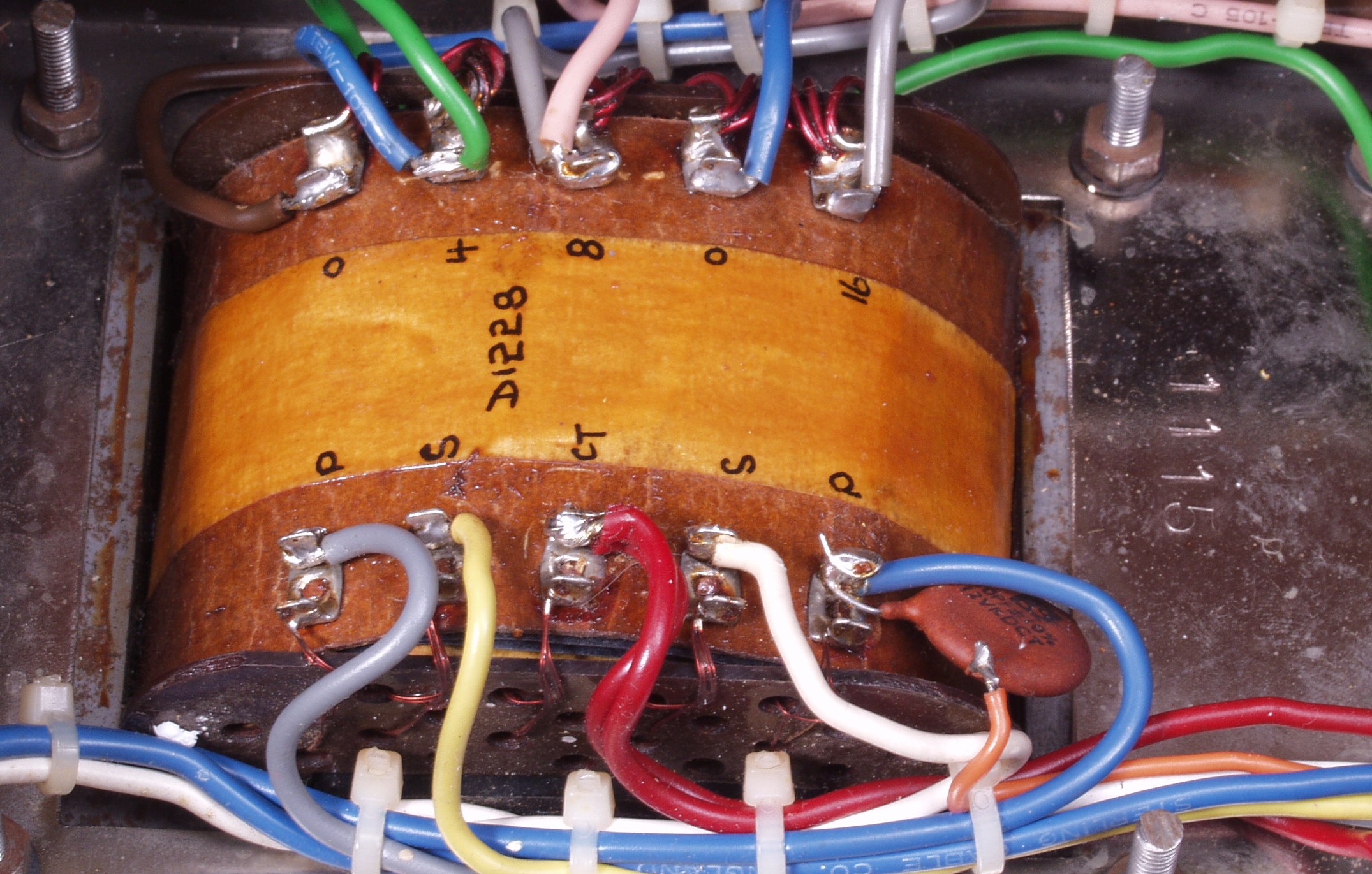

When the secondary are connected in parallel, as in the drawing below, which is the final impedance? I need this information to adjust the feed back loop.

That OT diagram looks a lot like the setup that Hammond uses (or used to on older OTs). An 8 Ohm winding with a 4 Ohm tap. Connecting the other 4 Ohm winding across the 0 and 4 Ohm tap just increases the current output capability, still 4 Ohm across the 0 to 4 tap and 8 Ohm across the 0 to 8 taps.
You connect the extra 4 Ohm winding in series with the 0 to 4 Ohm taps to get 16 Ohm out from the series combo. Looks like the diagram has the extra winding connected across the wrong taps. (will smoke the OT in that case since the 4 to 8 Ohm taps are actually a 2 Ohm winding, not 4)
Apnneto,
As the Hammond schematics showed and Tom Bavis and Smoking Amp said.

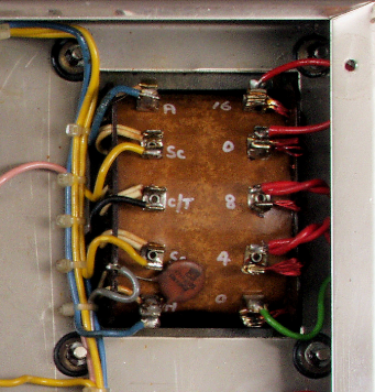

Your photo does not clearly show what is wired how (some detail is hidden behind the right panel.)
To give a simple arithmetic example, referring to the sketch in your first post: Say one assumes 10 windings between the bottom '0' and '4' taps, then there will be a further 4 windings from '4' to '8' ohm, which are 14 windings altogether for that section. The top section will equally have a second 10-turn winding from the '0' to the '16' marked terminal (never mind if it sounds wrong).
That then gives two separate 10 turn windings (4 ohms) in parallel for a 4 ohm output impedance. As said the parallel windings do not change the impedance, much as two 6,3V windings in parallel still give 6.3V, only capable of double current. To get to 16 ohm the two 4 ohm windings go in series, thus twice the windings and four times the impedance. The 8 ohm tap is somewhat of a 'bastard' connection. For 8 ohms one has the two 4 ohm windings (10 turns) in parallel plus an extra 4 windings not used before from the lower secondary. [Ratio 14/10 = 1,4, squared for impedance, which gives 2 x 4 = 8 ohms for the appropriate tap.]
Pardon the grade 1 explanation, but you will notice that real connections cannot be as pictured in your intro schematic; you will have two unequal windings in parallel. The physical connections as per the photo look factory-made, so please check as per the description in case someone made a booboo. (You can also use a separate say 50V mains transformer connected to the OPT primary, and measure secondary output voltages, all sec. sections disconnected, just to make sure.)

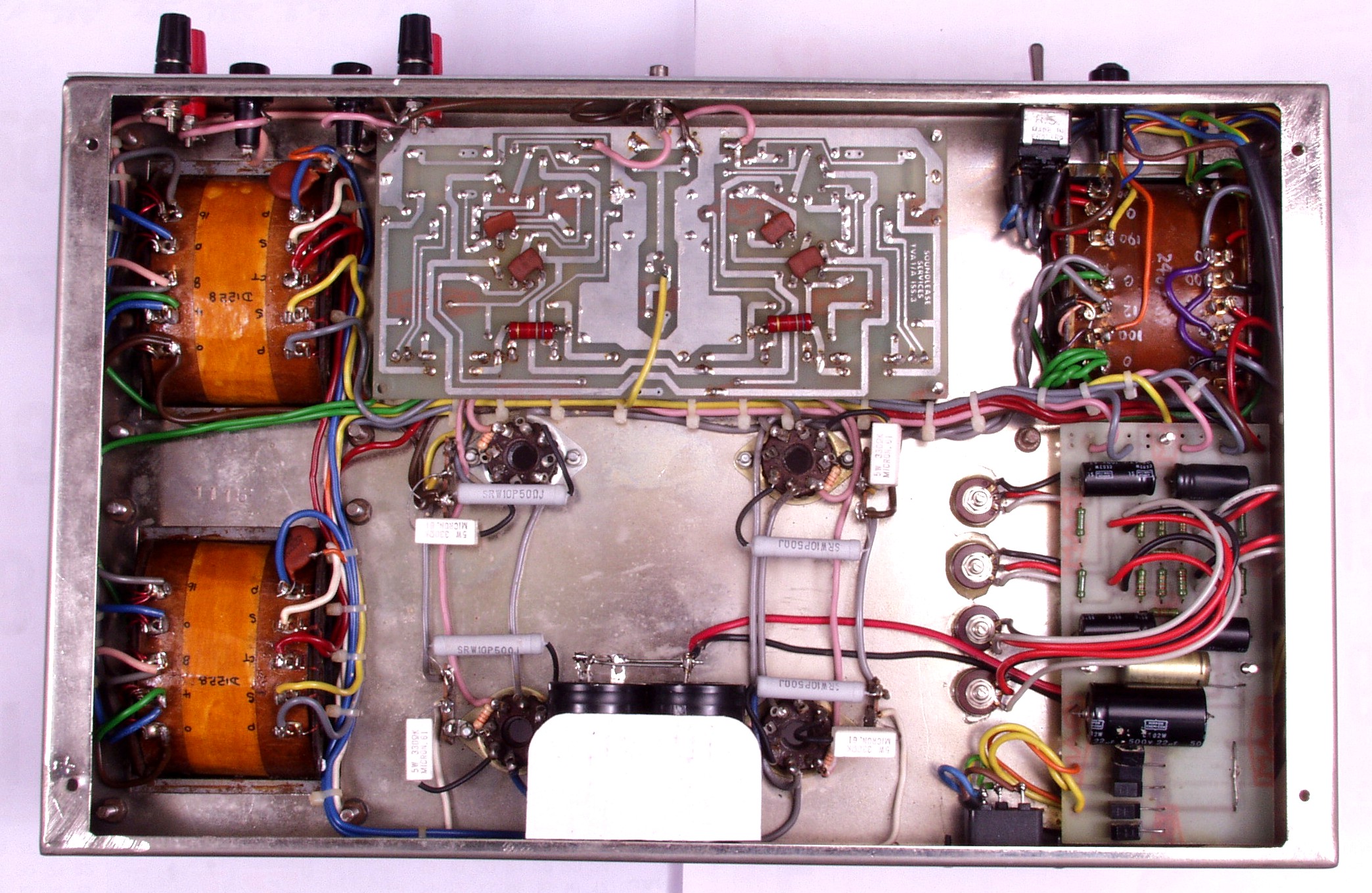

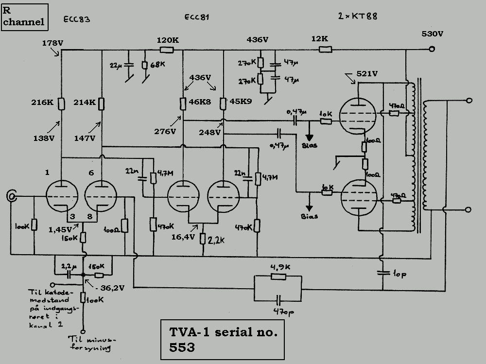

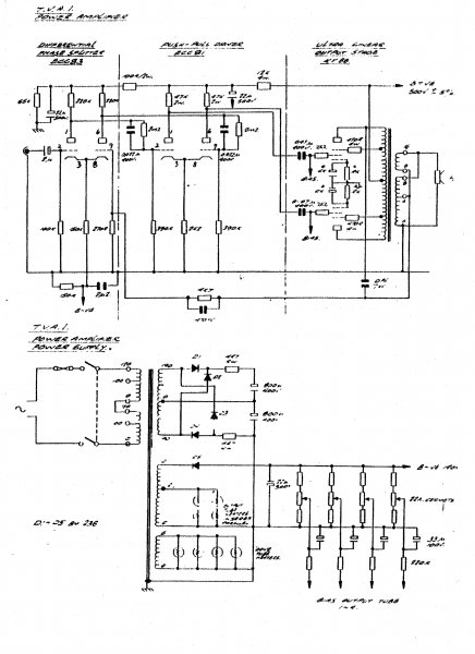

Unfortunately I don't have an original OT for testing and measuring. In fact, I'm cloning the TVA Amplifier. Nevertheless, what I've got till now is the output impedance used to feed the feedback loop. It's for sure 4 ohms, since it used the 4-8 ohms to parallel the 0-16.
There's a lot of pictures of this amplifier on internet and everything pointed to what the schematics is showing. Look at the new pictures.
Other point is that I've got a good operation point near what is on schematic, so I'm working starting with 4 ohms taps.;)

Sorry Folks,
You are mistaken.
The two output transformer secondaries are not shorted together in this amplifier.
The two secondaries (output: 0-4-8) and the feedback secondary (0 - 16) are only connected at the + speaker output, thereby giving twice output voltage in reverse phase for error correction.
What this does is provide an 180° out-of-phase feedback signal to the input and phase-splitter stage for error-correction.
