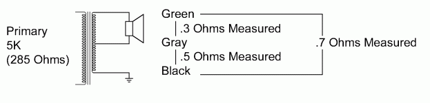

Wow, thanks much for all the responses. What a wealth of knowledge here! I guess I didn't make myself very clear, or I don't know what I'm doing (more like it), so I drew a crappy schematic for clarification. Given the measurement of the coils in the output transformer this was the way the original transformers were connected. Still seems strange to me that the bottom end of the unused coil connects to ground. Shouldn't the Gray wire connect to the Star Ground , Green wire to + on the speaker and the Black wire left floating?
Sorry to trouble you again.

Not sure where you got this idea, but likely no.. Measurements with a simple generator will tell you the ratio and from that you can make an educated guess.
The bottom of the coil is ground, most likely there was feedback from one of the taps and this would be referenced to the grounded black tap.. There was probably some connection between the speakers and this point as well.
A schematic of the original amplifier would be most useful.
When you referenced the black wire did you mean to say chassis instead of (transformer) frame in your post on said subject? To me there is a world of difference, perhaps not so much to some of the others here. As an engineer I read things very literally.

I think you are part of the way there. 400Hz was a reasonable choice IMHO as the primary Z should be sufficient for accurate voltage ratio measurements. I made a couple of assumptions and reworked your calculations.
- I assumed that Black-Grey was the 16 ohm tap
- I assumed that Black-Green was the 8 ohm tap
812/60=13.53 for the turns ratio, squaring it and multiplying by the suspected tap impedance = 183 * 16 ohms and results in a primary Z of 2928 ohms
Taking the 8 ohm case:
812/42=19.33 for the turns ratio, squaring it and multiplying by the suspect tap impedance = 373.8 * 8 ohms and results in a primary Z of 2992 ohms..
Within experimental accuracy and typical winding tolerances I think the results are consistent, and indicate that what you have is a transformer with a 3K primary impedance.
These on the face of it probably are not the best match for a 6BQ5 in pentode where something on the order of 5K - 7K would seem more reasonable. Note however that with a typical speaker this ought to be OK in triode connection.
