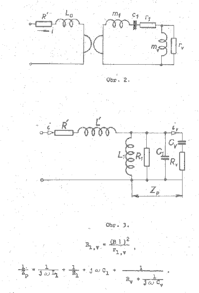

Charles,
you will probably agree with attached speaker's simplified schematics. From this frequency characteristics under resonance, between resonance and critical frequency and above critical frequency are derived. Now what happens, if we increase R' to infinity (or very big value)? This will mean in fact current drive of the speaker.
Pavel
Pavel

Hi Jan
To me (which is of course a matter of taste), decent speakers are always active speakers (with line level-crossovers).
It wouldn't make much sense to use current drive on passive ones.
This way, my statement about Lvc might make more sense to you.
The distortion reduction comes from the elimination of (B*L)^2 in the denominator that is there for the voltage to velocity transfer function but is absent for the current to velocity transfer function of a driver.
I have never attempted to figure out the actual differences though.
Pavel
I see what you mean but you have to take care not to make a mistake.
A current source presents indeed an infinite output resistance, but compared to just increasing the Rdc of a driver (or any resistor connected in series) that is connected to an ordinary amplifier, a real current source wouldn't reduce efficiency in such a dramatic way.
Moreover, current drive would even make Rdc "invisible".
Regards
Charles

Some years ago, I had an idea that I would like to share with you. I never tried it, but maybe someone who is good at digital signal processing might want to have a go at it.
Normal loudspeaker boxes are designed to have a more or less flat response under voltage drive, but the distortion decreases when they are current driven, according to Mills and Hawksford. (I am actually not sure if their arguments are valid near the resonance frequency, but that's a different matter.)
The frequency response with current drive is simply the product of the impedance curve and the response with voltage drive, as the voltage which will develop across the loudspeaker terminals is the product of the current and the loudspeaker impedance.
Suppose you make an amplifier with a current output which has a self-adjusting equaliser built in. The equaliser measures the impedance curve of the loudspeaker after switch-on and adjusts its response to be the reciprocal of the loudspeaker impedance curve. This way, it is possible to drive a normal loudspeaker box designed for voltage drive with current, while still getting the normal frequency response and reduced distortion.
For loudspeaker boxes which behave as lumped systems at low frequencies, such as closed boxes and bass reflex boxes, it is even possible to compensate for a box that is boomy under voltage drive, or to extend the bass response. In this case, put the measured impedance curve in a pole-zero extraction algorithm. As a linear time-invariant lumped system has only one characteristic polynomial, the poles of the impedance (current to voltage transfer) are also the poles of the current to sound pressure transfer. Adjust the equaliser such that they are covered by equaliser zeroes and let the equaliser add an equal number of poles in desired locations (Butterworth, for example). This way, you can let the amplifier taylor the bass response, automatically compensating for boomy boxes or automatically extending the bass response if you press the right button on the front panel.
