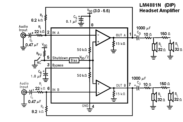

Yes , 16-60R would cover most earbuds.

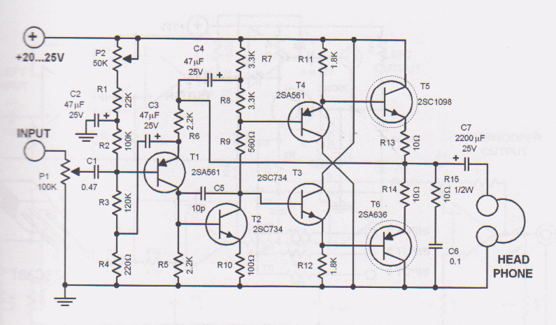

The BJT circuit below would even power a more current hungry set of
headphones.
Here is a link to the excellent LM4881 IC board -
Sure Electronics AA-AB32261 Stereo 2 x 150mW Class AB LM4881 Headphone Amplifier Board
The 4881 has the buck convertor - you can run it from a single 5V USB.
If you want a project , there are many IC based kits on ebay for <10$.
Edit - here's another .... http://www.parts-express.com/sure-e...ass-ab-headphone-amplifiers-2x1w-kit--320-319
TDA2822 with RCA inputs. PE has many of these kits.

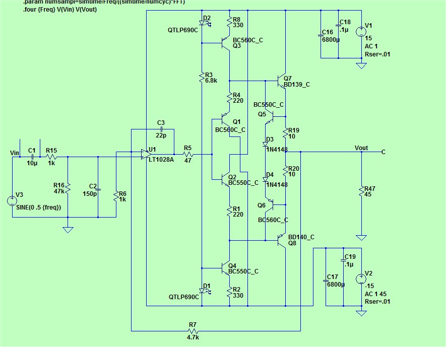

Then you use a class A output stage with a local current limiting FB loop.
That would be like (below).
Q7/8's thermal/beta would rise , Q5/6 would counteract this.
Q3/4 are current sources for the diamond (Q1/2).
The drawback is for a stereo pair - .3 -.5A total current ,depending on how
many diodes (D3/4 - or even another one ).
The 2 big semi's (Q7/8) could be ksa1381/ksc3505 - low Cob.
You would have to mount them on the chassis or a heatsink , they
pass 60-100ma each.
This is the price you must pay to mitigate the issues you mentioned.
OS
