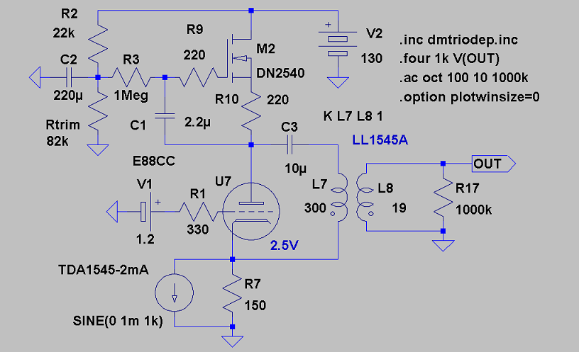

So, lets go on a budget using an E88CC. Also using the input from T:
Sure, looks nice enough. But also consider using common cathode and resistor I/U.
With a CCS loaded ECC88 you have a gain of around 30.
So for 2V out we need around 70mV RMS in. With 2mA Peak-Peak this means 100 Ohm I/U conversion resistor (to Vref) and a V Ref of 5V/3 = 1.67V. How you get the 1.67V, up to you. The DC overlaid on the ECC88 grid would be around 1.8V.
Single coupling capacitor out (maybe from the "Mu-Follower" output) and you are done.
Ciao T

Hey T,
Why this 2V out;)? My pre has a gainstage and the RIAA outputs ca 1V just as the drawn DAC-buffer.
Will adjuts the Vref according to your calculations. Still I don´t get it as the 2mA setting was 2*11k where I supposed Vref should be 0,5*Vdd.
With Ug 1,3V for Ua 100V/Ia 17mA we add the 1,2V positive bias at the grid to get the 2,5V. Pa is then held at below Pamax.

Common convention. In the olden days (does this rhyme with golden days?) before ridiculous amounts of compression where applied CD's had around 14dB Headroom. So average output would be around 0.4V. A normal MM cartridge with 5mV @ 5cm/s and the then common 34dB Phono Stage would give 0.25V average output as LP had 14dB headroom on the 5cm/s level.
Actually, Vref (in my notes) is developed across a resistor that is nominally 11K inside the DAC (hence the "Iref" label). So with two 11K resistors in series to a 5V supply Vref at the DAC becomes Vdd/3. I found boosting past 2mA lead to increased distortion, 2mA seems to be the sweet spot.
Also, the outputs should be held at a level higher than Vref.
Ciao T
Hey T,
This means Vref should be 1,7V when going the 2mA route. So running the DAC outputs just above this is what you recommend.
