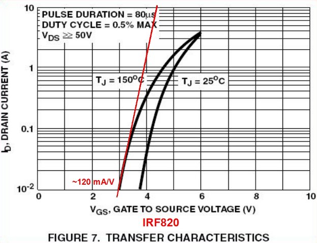

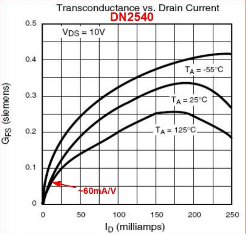

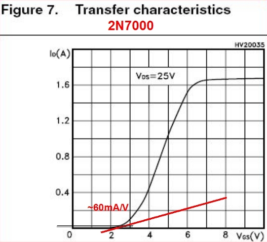

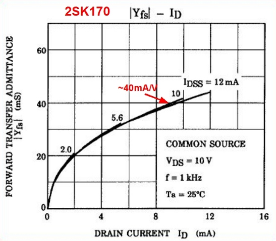

I found a datasheet for the IRF820 that goes down to 10mA...
I've been looking into this, looking for a low capacitance small signal device with high gfs at low current. It looks to me like the low current devices have relatively low gfs.
But I don't know why you say it won't work; what specifically is the problem? Even 40mA/V translates to 25 ohms Zo.
You could use a constant current sink if you're worried about the extreme of signal swing. That would tend to linearize the gfs.
Michael

Guys,
Please remember that the critical parameter for a FET in voltage follower service is reverse transfer capacitance. A type with a low and stable reverse transfer capacitance is what the job requires.
There are a number of suitable types available. FWIW, I call for the ZVN0545A in low current situations and the IRFBC20 in medium and high current situations.
ZVN0545A Data Sheet
IRFBC20 Data Sheet
BTW, even a wimpy 12AX7 section has no problem in cleanly driving a ZVN0545A. :)
Just looked in Grey and Meyer's book. Two regions of gm variation exist for MosFets. For gate voltages above approx. Vthreshold+1 Volt, gm varies linearly with gate voltage and also as the SQRT(Id) [since Id = k1* Vg^2]. This is called the square law region.
Near threshold voltage (Vg = 0V up to about Vth +.5 V), gm varies linearly with Id, since Id = 10^(k2*Vg), ie exponential transfer like a bipolar. This is called the sub-threshold region or exponential region. This region occurs when the channel is cut off and substrate conduction effects are remaining.
Michaels graph for the 2N7000 above illustrates the linear variation of gm with Vg with the large straight ramping section of the curve. The small curved section at low Vg is the sub-threshold region of gm variation, linear with Id [or exp(Vg)]. The flat horizontal section is in the saturation region.
The graph for the 2SK170 illustrates the inverse parabolic variation [ie, SQRT(Id)] of gm versus Id. (Same as the linear gm variation versus Vg region for the 2N7000, but the 2SK170 graph here has an Id coordinate instead of Vg coordinate)
At 20mA the gfs of the irf820 looks to me more like 1900mA/V, as drawn by you. I know the actual value is a moot point; just saying.
It looks like you are saying 1.9A/1V is the Gfs. The problem with this is you are evaluating on a log scale over several decades of current.
The quantity Gfs (also Yfs), like the analogous Gm for vacuum tubes is known as "dynamic transconductance" because it is a changing quantity evaluated at one particular point, in this case approximately 20 mA.
If you take the first 1/3 volt from the axis, you get approximately 40mA current delta for aproximately .33 V delta. This is how I estimated the Gfs for low current based on the slope of the line in a small region around the point of interest. Really the deltas ought to be made mathematically very small, which is defined by di/dv.
It's probably a stretch on my part to eyeball the first derivative of a curve on a log axis chart in the first place, but that's the general idea. Edit: I see this is probably the issue. I am making the same error as you in reading a straight line off a log scale, just smaller ;-)
Michael
