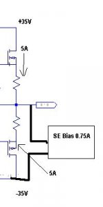

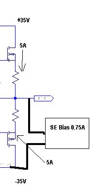

I also have this curiosity:
when you say negative side 4.25A and 0.75A SE bias, isn't it more like 5A negative side plus 0.75A?
I mean with SE Nelson controls the amount of bias on each quadrant?
This is probably something I haven't understood yet. Check out my sketch and please tell me where I am getting wrong.
Thanks.
Thanks.
