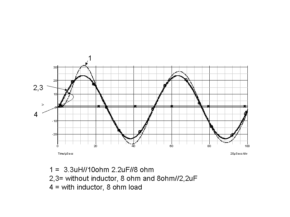

Hi all
Simulations reveal some issues. Using a "blameless" architecture, which as Bob says in another thread has a Miller stabilisation scheme which reduces drive impedance at high frequencies, comparison of 8 ohm load, and 8 ohm in parallel with 2.2uF, with and without a 3.3uH inductor show differences.
At 20 kHz the no-inductor solution gives almost the same output whether or not there is a 2.2uF load. Evidently this is the best option.
With an inductor and resistive only load, there is a marginally greater initial delay, which MIGHT make the sound "duller".
The really bad situation is with the inductor and 2.2uF load which shows massive "first cycle" distortion due to ringing, and continues with artificially increased signal due to ringing.
So here's the conclusion from this experiment: with a Miller architecture, which has been widely reported (mostly subjectively it has to be said) as sounding dull, but is unconditionally stable (hence an easy amplifier to use with capacitive loads) there seems to be no need for an output coil.
If an amplifier needs a coil with capacitive loads, perhaps this will degrade the apparent brightness of the amplifier (from the simulations, for those objecting to subjective terminology, this means longer delay time). The question is that these simulations were all at 20 kHz. Harmonic distortion won't be a feature. We're talking about delay times, and ringing.
It is interesting to note that the current flowing in the transistors at the first cycle peaks at 11A for a 50W amp, with the inductor, and only 9A without. Using 2N3055's in the simulator showed no difficulties. In practice the gain may be falling so far that the VAS and drivers run out of steam.
BTW this inrush current is because a continuous sinewave dumping into a capacitive load had to build up an out-of-phase current. If the current is not present, the effective load is closer to 2 ohms or so until the current has "caught up". I don't think out of phase currents are particular issue, but large ones develop large error voltages in the input stages to force the output transistors to handle them.
Moral of this story is that capacitor loads may make an amplifier overload, may trip protection circuits and generally cause havoc. If you want to run electrostatic speakers, then an alternative to an inductor is a small resistor - perhaps 0.1 ohms will do. Even JLH suggested this!
cheers
John

The point of my recent post wasn't really to change the implementation of the output network, though I always like to eliminate a part when possible. It was more about considering the fact that the real physical networks may not match up well with what people plug into the simulations. Inductors can be very imperfect components, and much of the info here is based on simulations. A bit OT- my free Switchercad simulator can't account for the variation of series or parallel R at different frequencies. It uses fixed R and not D or Q. How does one deal with that? IMO, it has to be dealt with if the results are going to reflect reality. Here's another thought- make up ten output inductors and mount them in series with a bit of space between. Now attach the speaker wire to the tap of your choice and see if you can hear a difference. I'm going to try that, being a rather easy and inexpensive test.
Hi John and others,
I'm trying to read the implications coming from your graph.
It looks like a delay of the peaks for the inductor+capacitive load of about 3 to 5uS. It also appears that the zero crossing delay is much less, possibly 1 to 2 uS. This implies some saw tooth type distortion. What specific harmonics and relative proportions make a saw tooth?
The increase in voltage is also an obvious distortion.
When listeners report hearing a difference, what are they hearing/not hearing? Is it the peaking up (is that another word for overshoot) of the voltage or the altered harmonic structure?
What frequencies are the listeners hearing that have differences in them?
I get the impression that these inductor/no inductor effects are a high frequency phenomenon and that much of what is to be heard is above our normal hearing range.
Does that mean we are only hearing the intermodulation of the distorted high frequencies folding back down into the audible range or is our hearing system capable of dissecting the high frequencies directly and recognising that a normally inaudible signal is there to be heard?
That 11Apk into an 8ohm//C load is a surprise and supports the view that Re is not the worst resistance that a speaker presents to the amp output. Is this the first cycle effect (or similar) that Graham talks about? How long could this high peak current last in the most extreme case, 10uS or 100uS or could it happen on a sudden bass signal and extend out to 1mS? I'm thinking about false triggering of protection circuits on transients.

Hi Andrew T
Well this is where we get into the argument about hearing distortion at 20 kHz. Since it is not possible, in the case I mentioned it would have to be the relative amplitude response that is the problem, possibly also that the additional delay causes the amplifier to sound "dull".
If we run the simulations at a lower frequency - let's say 10 kHz - then it is just possible that any distortion is audible. But the effects of the inductor will be halved compared with 20 kHz.
So far, then, it seems to me that capacitive loads are the prime candidate for the cause of the trouble, especially if these need inductors to stabilise.
The point I made about the Blameless is worth repeating -although it uses a Miller capacitor it is (or ought to be) unconditionally stable and does not (or should not) need an output inductor, even with capacitive loads.
Yes you are right in that the first cycle distortion could trip protection circuits, but again this was with capacitive loading. Projecting this to a real load, the crossover components in a loudspeaker network may well have similar effects, but most crossovers I have seen have resistors in series with capacitors and few have capacitors directly coupled across the load.
First cycle effects into capacitors may translate into "last cycle" in inductors because inductors oppose fast changes, but instead try to keep currents flowing during switch off. In this case it seems to me that the amp has to provide a discharge path for the out-of-phase currents which may stop suddenly rather than start suddenly. But there again, transient bass notes tend to cause the fast dynamic attack with a slow decay but maybe there is plenty of scope for leading/trailing edge effects as music is never sinewaves!

Folks would be aware that this thread is quite parallel to another on effects of output coils, so apology for repetition:
My brief comment would be that so far I could not find a reason for omitting such a coil. My own design is definitely not "unconditionally" stable without it, as shown by loop gain/phase/nfb magnitude plots. Those characteristics were chosen with other objectives in view. What people will throw at outputs of my amplifiers is outside my control, and any measure that will broaden the stability margin without affecting the sound is to me desirable.
I could not find such effects with the 6uH I am using (in parallel with 18 ohms). Any (mainly attenuation) effects start at > 60KHz. I have simulated with an equivalent typical woofer-tweeter loudspeaker (cross-over about 2,2 KHz) load, and all sorts of load variations, and sorry, I cannot find a reason for not using such a coil - neither did I in all the quite informative posts (I did learn many other things!). Lastly, my loudspeaker impedance shows an inductive component of about 80 uH at 20 KHz. An odd extra series 6 uH will affect matters how? (That 80 uH itself is most probably subject to variation with practical loudpseaker spread of more than 6 uH.)
Many output topologies are possible, some very possibly not needing a series loudspeaker inductance. But that is no proof that the use of such a coil is detrimental. Also I do not disrespect the hearing experiences of others. But there are just too many other design parameters playing a role for that in itself to be normative.
Main thing: The amplifier design should be such that such a network should not have an effect in audio.

Hi John,
These results are interesting on a couple of levels, but I do have some questions.
Am I correct in understanding that you did not include a damping resistor across the 3 uH coil? That can make a very big difference, and I would never recommend eliminating that resistor.
I'm pleasantly surprized that the Miller architecture you simulated was stable into 2.2 uF, but I'm not sure that is always going to be the case. It may depend a lot on the specific implementation and compensation. It may also be unstable into a smaller capacitive load.

Andrew,
I was talking mainly simulation with Spice. Where I did check reality I did it with cumbersome scope input/output point-by-point plotting! It would be possible to plot directly with some of the analysers available (and I presume pc software), but alas, I am not the proud owner of such luxuries (yet). Local economical situation blah blah ...., not to go into politics. I still do the "spadework way" occasionally just to verify that reality is not too far off the simulation. (I did until some time ago still have contacts at the lab where I worked to use their instruments, but erstwhile colleagues, like myself, have retired, etc. )
So I must regrettably give you a mundane reply.

Hi Bob
There was a 10 ohm damping resistor in parallel with the 3.3 uH coil.
I agree, undamped coils certainly would be troublesome.
Whenever I use a "blameless" amplifier configuration I choose the input emitter decoupling resistors to be rather larger than the 100 ohm usually used; in addition the input stage current is increased; and the dreadful Miller capacitor need only be quite small (but has to be larger than about 10 pF or it is swamped by variations in Cjc of the VAS). This ensures that there can be no cut-off in the input stage for any input within the normal limits. Distortion is a little worse than the usual 0.003% or so, and rises above 10 kHz, but nevertheless it is unconditionally stable if using a 4 MHz output pair (eg MJ21193/4) and a unity-gain (closed loop) of 10 MHz, which still surprises me at being stable!
Hi Jan
I think that the audible effects will be something which may cause "listener fatigue". Sorry to use subjective terms, but when the initial cycle starts, and is larger (at the speaker) than the following cycles, I believe the sound will be somewhat "artificially bright" if anything. In other words, both delayed and bright at the same time!
I've not listened to such an amp. with a 2uF load. One amp I have heard sound like this description is the dual-slope Miller types where the Miller capacitor is filtered to give a higher open loop gain which reverts to 6 db/octave before hitting the unity gain line.
I've often puzzled by the term listener fatigue in early designs. Does anyone have a view?
My twopennorth is that it is simply arising from intermodulation products - amplifiers which don't have low enough distortion create harmonics which don't belong, and the brain is trying to remove the sound because it "knows" instruments should n't have them...
But, unless several sets of transistors are used in parallel I suspect that real amps will distort wiht resonant load (coil+capacitor) because of the huge current inrush.
From this point of view, coils are best avoided, but it is not established that they are audible per se.

Are you saying that your simulation reveals no oscillation with a true (i.e. ESR=0) capacitive load of 2.2uF? This really amazes me. I have run hundreds of sim's on many different topologies, but with 2.2uF, I always got troubles. Are you sure your models are okay, in particular regarding the O/P transistors? Did you have also simulated the lead inductance of the O/P devices (ca. 10nH/cm)? The latter makes quite a difference!
john_ellis said:Hi all
[snip]
cheers
John
Hi John,
