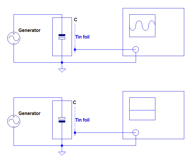

Elvee:
Excellent schematic, thanks for going to the effort. I stole it.
The generator is a standard audio or function generator.ops!....i've done measurements without generator....could be this the reason of my faliure ?
what type of generator ?
if yes how must i proceed ?
Ideally, the frequency should be set as high as possible, except that the practical limit depends on the capacitance value and the generator's output impedance.
Function generators generally come in 50 ohm, sine oscillators can be 600 ohm or any other value.
Anyway, 1kHz should be OK in most cases except if you measure really high capacitance ones, like >1µF

I just remade a sanity check of the method, and the results are completely unambiguous, even on "difficult" cases, like small boxed caps

Show your setup, indicate the capacitor's value, in short give us all the details: the reason will be immediately apparent, because as I said earlier, the method is extremely robust and reliable, at least when there is indeed an outer foil: if you try to determine a standard ceramic disc capacitor that way, your results will be completely inconclusive for a very good reason....i tried don't change nothing !!!, why ?
What generator do you use?
Can you post a pic of your setup?
3.9µF is already large and if you use a high impedance generator, it will pose problems. With a 50 ohm one, it is still just manageable.
Try setting the test frequency to 100Hz, use a good ground plane and push the scope's sensitivity to the max, it should work
