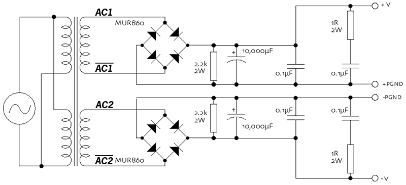

Hi Zac, only the second link worked. The power supplies you were looking at are actually used for industrial control, probably wouldn't work to well (also why none were above 24v).
You can go in the direction of buying a prebuilt power supply, but it will be expensive. You are in need of a supply that can provide +50 and -50 at around 2A. It would be much cheaper to buy the components and build it yourself.
What about (back with the first kit supplier...) the AMP 1 on www.41hz.com using the AMP 1 PSU plans posted on there?
Are there printed circuit boards available for this type of PSU?
