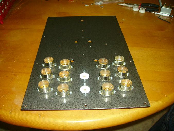

Ok, I should have posted some schematics here days ago but nothing has happened. I usually do such things when I work late, but there´s been a lot to do at work lately.
Another reason why I havent come up with any schematics is that I for a short while forgot about the whole SE OTL thing and started reading up on various PP OTL projects instead.
I´m sure an inverted Futterman with 6 x 6C19 per channel would be worth a try, but all the extra stuff required to drive the output tubes properly finally got me back on the SE track.
I´ve been digging around in my junkbox a bit and came up with some interesting transformers, with a little luck and a shoehorn I might get everything into one chassis after all.
Not that I´m too fond of having big power transformers just inches away from low-level circuitry, but good connectors to use between PSU and amp are expensive...
With one 12V 50VA filament transformer per channel available, why not go "The full monty" and use six output tubes per channel?
Output power increases in square with the quiescent current, so every extra fraction of an Ampere is most welcome in a project like this where current is the limiting factor.
So: 2 x 12V 50VA for the output tube´s filaments.
1 x (2 x 36V) 225VA for the output´s plate voltage.
1 x power transformer from an old tube radio for the drivers
2 x cathode chokes
12 x output tubes
2 x input tubes
<10 x 680uF 160V Rifa caps
All this on a 10 x 16" alu sheet. Wish me luck!!
...and off we go!:

It´s been a while since I did anything to this amp, I´ve been working on an 807 SE amp for my brother and gathered parts for a couple of big SE DHT projects. I did order some parts a couple of days ago though, so perhaps some initial testings can be done in a not so distant future.
I´ll start with the output stages, when they operate as intended I´ll work my way towards the input stage.
No schematic yet.
Update: The 12 x 6S19 OTL is abandoned due to heater and PSU issues.
A new design incorporating 8 x PL504 is in progress, the 27V 300mA heaters are much easier to deal with as they can be connected in strings and fed with DC.
I have a big toroid transformer that is very suitable for this, it has one 77V 5A winding and two 9,5V 2A windings.
My idea is to rectify and CLC-filter the 77V to get just over 100VDC for the heaters and then stack the (separately rectified) 9,5V windings on top of this to get about 125VDC for the output stage.
Aside from this three more voltages are required: heater and plate voltage for the input tube and a negative grid voltage for the output stage. No problems, any little tube radio transformer should manage this.
