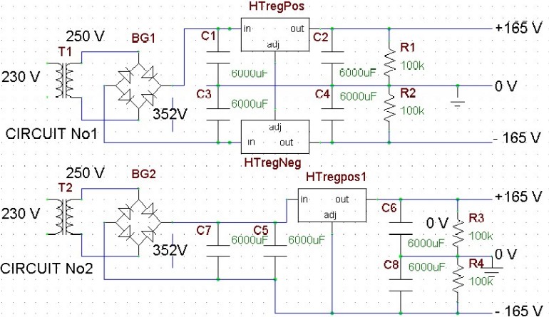

I’m going to build the famous 6C33 OTL design by Mr. Ciuffoli and I’m planning to use a regulated HT for both the drivers and the final stages. So if you notice on the schematic the 250VAC from the transformer goes to the rectifier bridge and we have about 352V DC. Now we have two possibilities Circuit 1 or 2. Which one you think is the best to use? Please note that I already have in my hands these 6000uF capacitors. Also in the next message I will send the regulator circuit Positive and Negative with the discrete parts.
Thanks in advance

Maybe not the answer you are looking for but I suggest that you build the OTL amp without regulators, it works well if you use good components, (especially the PS caps). In my OTL that is similar to the Ciuffoli circuit I use 2 x 5500uF as only filtering for the power tube supply, it works very well. For B+ to the driver I use CRC with 100uF + 100uF and then one RC stage with 220uF to feed the input stage, (SRPP).
Regards Hans
Hans,
I was thinking of using the regulated PS because I will use this amp with a set of back loaded horns using FE208ES units with total sensitivity of about 100dB, so as you can see I dont like to have any irritating HUMMM on the speakers. Also I think that in case I will use this PS, there is no need of any chokes because the ripple of the voltage will be very very small, finally the cost and the weight of the chokes also is importand.
Yes I can appreciate that as I am using Lowther horns myself. My amp gives 0.4mV Pk-Pk noise and hum which gives signal to noise ratio of >100dB, this without using any chokes and no regulators only caps, I can not hear any disturbing hum at all using my Lowther Fidelio horns which have about ~100dB sensitivity so I think it is quiet enough.
Regards Hans

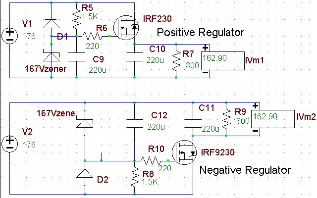

Thanks all of you for the time. But please lets stay focus on my main question regarding which of these topologies whould you choose between circuit 1 and 2. Now regarding the choose of tubes or mosfet as active element on the PS section is another thing, maybe Im will use a 6080, 6AU6, OA2 setup instead of a mosfet and a diode zener. So please lets accept the regulator thing as a tree wire box doing the same job even if it is build with mosfet or tubes.

6080 is not enough in this application, the amp draw 0.8A continouos current at full output power which a 6080 can't handle.
I still don't understand why you want to use a regulator when you can get low enough hum, (that means not hearable) without it but anyway that is your choice.
If you want to use a regulator it must be designed for 0.8A continous current and I advice you to make it more stable than in your circuit, using Zeners at high voltage gives very bad temperature drift and voltage shift depending on Zener current so you will have an output voltage that is not constant and varies with temperature and load.
I would build a closed circuit regulator using a high speed opamp with the circuit carefully tuned for good high frequency response.
Regards Hans
Hans,
Item No1.
P=V x I =I x R x I (For P=25 W, R=8 Ohm) => I=1,77A rms Passing through the 8 Ohm load, producing 25 W power, Right?
So how you calculate 0.8 A continous current?
Also I do believe that the capacitor bank can give the extra peak current to the amplifier when he will ask for it.
Item No2.
In case of these amount of current the 6080 is to small to do the job I will agree with you. Maybe the use of another 6C33 as a pass element in the PS regulator would do the job (this was my first idea) but once again, see can't handle the 1.77 A (or 0.8 A) through her.
Item No3.
In case of using the mosfet idea now , a mosfet can handle easy lets say 2A current with about 30 Volts between drain and source pins. The thermal noise produced by the zeners and variation of the constants can be reduced by using many small voltage zeners in series in order to create a high voltage zener with better overall characteristics.
What do you all think about it?
Chris
