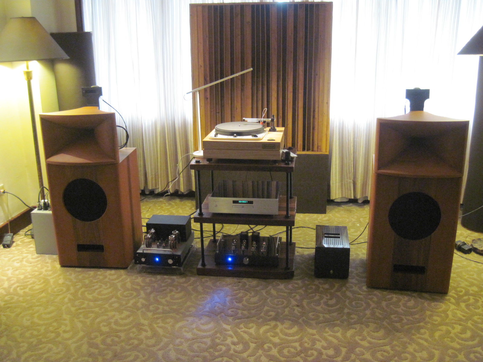

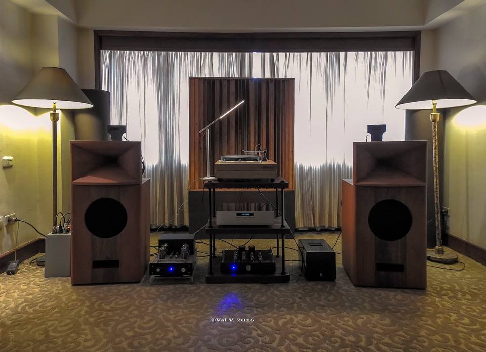

this is our DIY setup at the Dusitani Hotel in manila last nov 12-13...
diy speakers using altec lansing woofer/mids and EV highs...
What about the Thorens on the top ? arm & cartridge ?this is our DIY setup at the Dusitani Hotel in manial last nov 12-13...
that was a Garrard with local solid wood plinth while the tonearm is a linear tracker, locally designed and fabricated.....i think that was a hanna mc cartridge...
Nice stuff, bravo!that was a Garrard with local solid wood plinth while the tonearm is a linear tracker, locally designed and fabricated.....i think that was a hanna mc cartridge...

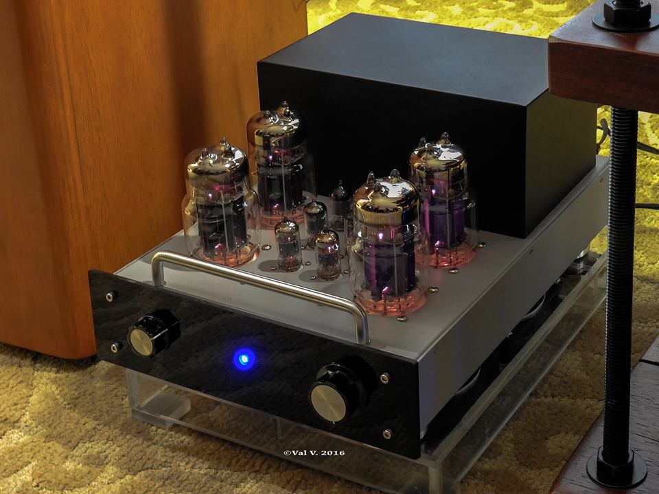

Talking about your otl, what caps have used in PSU?
What for, the 2200/250V ? did you changed Tim's design?i only did the otl amp, the preamp and speakers were done by others, even the interconnects....
in my irl amps, i used two 10000uf 80 volt series caps, bypassed with a 40ufd film caps...
oh, an i used a 2200ufd, 250 volt output caps.....
Maybe when your OTL settles down and you become more confident of it, you can "live dangerously" and remove the O/P caps. I ran my own OTL for about a week into a dummy load before connecting speakers. Now the O/P DC offset does not vary by more than +/- 6 milliVolts. So far, there have been no LS disasters. It takes courage though.yes, i put in an output dc blocking caps....
yes, i have my sights on that.....i just don't want another persons' speakers burn out.,....btw, those in the show did not know about the output caps...
the hever asled so i never told them....
I am running too, the mono-blocks since more than 10 month on the precious esl 63 and offset seams to be prety stable. I also face one ef86 damaged, but fuse done his job. On my humble oppinion output cups may alter the sound more than an OT.Maybe when your OTL settles down and you become more confident of it, you can "live dangerously" and remove the O/P caps. I ran my own OTL for about a week into a dummy load before connecting speakers. Now the O/P DC offset does not vary by more than +/- 6 milliVolts. So far, there have been no LS disasters. It takes courage though.
if this were so, those who came to the show and listened were all smiles as they left the room....but i do believe that the amp will be better without the cap, just that safety of the speaker came in as first priority...
