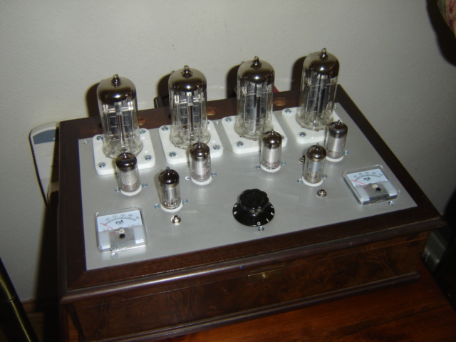

Hi All,
Recently finished my variant of Tim Mellows OTL. I've used 6C41C's in place of 6C33C's as, for me, around 6W is sufficient and I don't need all the extra heat. (although, this weather?!) The circuit is exactly as Tim did it except that I've used 500mA meters in place of 1A. I run the 6C41C's at 100mA not 200mA and the HT fuses are 500mA too. One thing I did change was the working voltage of C18 in the -430v section as 250v was exceeded. So a 385v rating was used. After a weeks use, the amp. has settled down with bias and balance pot settings remaing stable - and it sounds - GOOD too! I realise that using the 6C41C's compromises the output impedance and damping factor but it still sounds very nice compared to other more conventional amps I have built. My son in law was so impressed that he wants me to build him the original version to (possibly!) replace his 300B amp I built him a few years back! All in all, a very nice sound, thanks to Mr Mellows unusual (and rather novel circuitry - who'd have thought of a dc coupled driver for 6C33C's using an EF86!!) Picture attched.

David very nice where did you get the case?

That looks really nice. I'm inspired!

Thanks all for your comments - Yes, the box is a Cutlery box - various sizes around at 'boot fairs' etc. One thing I didn't mention in my report is that the box only contains the two transformers for heater supplies (In order to keep the size down - the power for these and the +&- 150v ht's is derived from a 500w isolation transformer (hidden behind a setee!)(extra points for that from wife!) There is a 3 core cable between the two - L,N & E. This probably would't be practical for the higher powered version
As to the DC offset - after a weeks run-in, it seems to settle at around ' +&- 0.005v'! Amazing! This extremely good stability may be in some part due to the lower power 6C41C's - not sure if 6C33C's would be this good (?) My previous OTL using 6C33C's certainly wasn't! Like to know what other builders are getting?
