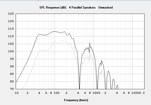

Alright guys. finally got to work on this project (although my drivers still havnt shown up yets...) BIg thanks to Ricci and JWMBRO for the inspiration on the fold style, JUST A GUY for checking my noob fold skills with akabak.
Final dimensions, 25.7x25.7x20

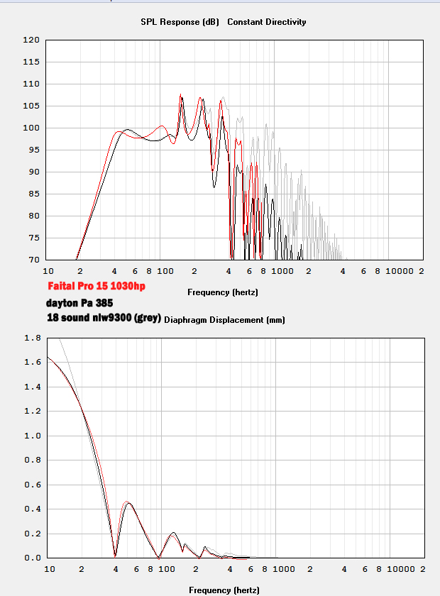

The driver that will be used in this build is the Faital pro 15 hp1030. The BC 15tbw100, 15sw100, and Dayton pa 385 (kind of) are also good fits. I'm sure there is an 18sound driver that will work but they are too hard to source (affordably) here in the US.

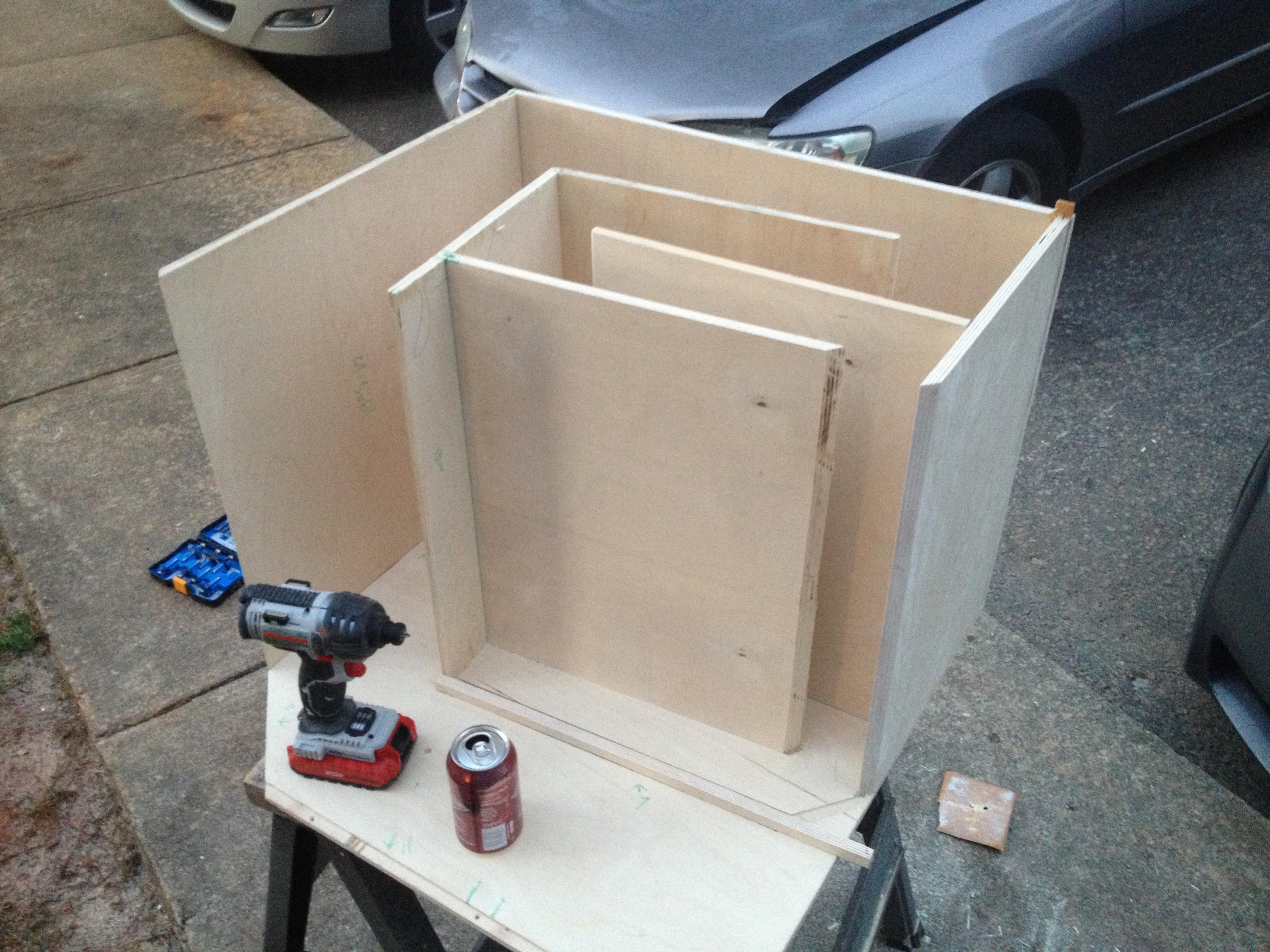

I honestly didnt lay out cutsheet for this one because i had to cut my 5x5 sheets down at the lumer yard with a handheld circular saw. The 19.25 internal width does play nicely with 5x5 sheets, but the 25.7 x 25.7 sides are not all that efficient (take basically a half sheet for sides alone, with a 9 x 25.7 piece of scrap, and a 5 x 60 piece of scrap ). I also messed up a couple cuts whilst cncing the sides.... yeah... so I'm hoping to get 2 of these out of 3 sheets of BB 5x5 (including all the bracing pictured.
CNC out the braces and the side panel dadoes last sunday. Heres a quick vid for your viewing pleasure.

Hey young man, remember back a few months ago I challenged you to design a tapped horn of your own? Congratulations, you did it! And HaHa, I still haven't got mine done yet, so I hereby admit defeat.
It looks very nice - you did a very respectable job here. Beautiful 3d rendering and that CNC thing is amazing. Are you willing to share your HR files, or the actual dimensions?

I know my NLW9300's probably are but I am going to use those in my new L/R HT fronts. I have some W750's also which I dont think work because they like a huge cabinet. I'll see what the other models are but I think I will be selling my four W750's anyways. Then I will be getting a few more drivers.(18 9601 or 2400 and another 15)
Unfortunately the 9300 doesnt look that hot. VERY similar to the Dayton (in fact, the dayton has a little bit better excursion control) AND the 9300 has a MUCH lighter cone (aka more distortion at high output).
Yah I have those plans also. I have built a few different horn builds that didnt pan out. SO I am still thinking of doing the TH18 by Xoc1. If I feel I dont need below 37hz I should be fine. BUT I am really liking the Othorn with the 18 9601.
