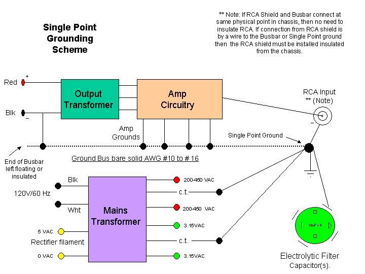

Joel said:Gene,
Look closely at your inside layout picture again. I see five or six seperate "ground" points, which are merely the lugs on the tube sockets, and/or capacitor cans. They don't even seem to be tied to the chassis in some cases. You're assuming these are all good COMMON grounds for the signal. I wouldn't assume that at all. Especially not on a painted chassis like that Hammond box.
All your circuit "grounds" should be attached to a single heavy bus wire of at least 16ga, and then attached to the chassis at a single point (usually one of the power transformer bolts). That point should be scraped down to bare metal on a painted chassis.
Joel

"The Tube socket is basically being used as a poor mans star ground."
A "star ground" is all the circuit ground connections made individually to a single point on the chassis. Not multiple tie points each connected to the chassis.
What you have happening in your amplifier is positive feedback. There is a path occuring you're not aware of, or something is not "grounded" that you think is. Also, when you use mutliple chassis grounds, there can actually be a difference of potential between them, and induced AC voltages.
I know using the chassis as a ground plane, and the tube sockets as ground points has been done before (especially in guitar amps), but it was never good practice, and shouldn't be used.
Joel
Joel
Ok, I understand what your saying Kind of,
Looking close, There are a total of 5 points in which ground actually contacts the chassis.
The Can Cap mounting is isolated from the chassis, Rules that one out? It connects to earth only via the highlited blue & white wire from the transformer CT's and or the lead between the socket and cap lug.
#1 The Tube socket lugs(virtually a terminal strip)
#2 The Lug at the 12AX7( Added Today with no effect)
#3 The Lug where the bypass caps are attached
#4 The input jack
#5 The output jack

So, I guess in my eyes the only points in which the chassis is "relied" upon as ground is the output jack & the solder lug where the shielding of the signal leads connect. I added that this morning mounting the 68K resistor directly on socket pin 2.
I Jumpered the ground side of output jack directly to earth with no change.
I jumpered the earth to the solder lug, no change.
Question, Earthing,
On Amp #1 (working) I have earth directly conected to the chassis, Then Directly to the cap lug. A seperate wire then returns to the transformer CT's.
Could the Cap and its proximity to the PT be my source?
Thats a pretty big piece of metal floating up there and its lugs are ties for several componets.
gene

I suggest that you pull the output tube and probe the preamp output with a scope or the input of another amplifier to see if it still oscillates. This will tell you if it's local to the preamp front end or from the output back to the input.
Guessing here, the 15K resistor to ground off the tone stack should be grounded close to the front end, say to the same point as the first tube. Grounded close to the output stage or where current flows from the output stage can form a feedback path where the tone stack senses ground shift from the output stage.
By the way, I only see heater and output transformer wires on pin 8 of the 5Y3, there is a wire to the cap - I hope?

Hi Gene,
We seem to not be communicating for some reason. You should realize that all of the tube socket tie points you listed are also "relying on the chassis". You can argue with me if you like, or you can simply realize that the construction method you chose is problematic at best.

Joel,
I agree that there is clearly an interaction taking place, But, If I floated the tube socket above the chassis, It is still connected to ground via a hard wire, as Is the Cap.
So, I concidered the socket lugs as nothing more than a terminal strip surrounding the socket.
Now, I guess the real trick is locating the points causing the interacting end results.

This may be a little late since you've re-done the offending amp, but I'll post it anyway.
Ok, after looking at your fotos there are some grounding issues!
1. The Mains gnd should be attached to the chassis at the earliest moment, near the power cord recepticle; NEVER directly to the PS or signal gnds at any time!
2. A redundent gnd wire from tube socket to lug strip, which is attached to the chassis at both ends.
3. You have gnds all over the place that are at multiple points on the chassis.
4. The is no such thing as GROUND!
The easiest way to impliment grounding in your case would be a single point bus grounding scheme. One of the most desierable chassis grounding points would be at the metal can PS cap with a grounding bus returning there. Some amps have the grounding bus attached to the chassis at/near the input jack. You may need to use a few more lug strips to accomplish this, but it's the way to go.
Now that's said, I would suggest putting a 4.7k 1/2 watt grid stopper at the output tube's grid, even if it doesn't stop the oscillation because it's always a good idea at that position.
I have a block diagram that I downloaded from somewhere showing a single point grounding scheme. I hope it will be OK to post it here as I think it will help you greatly.
Cheers
Wayne
Cheers
Wayne
"My God! They're using TOOLS!" Dr. Herbert West, a.k.a. Jeffery Combs - "Bride Of Re-Animator"
