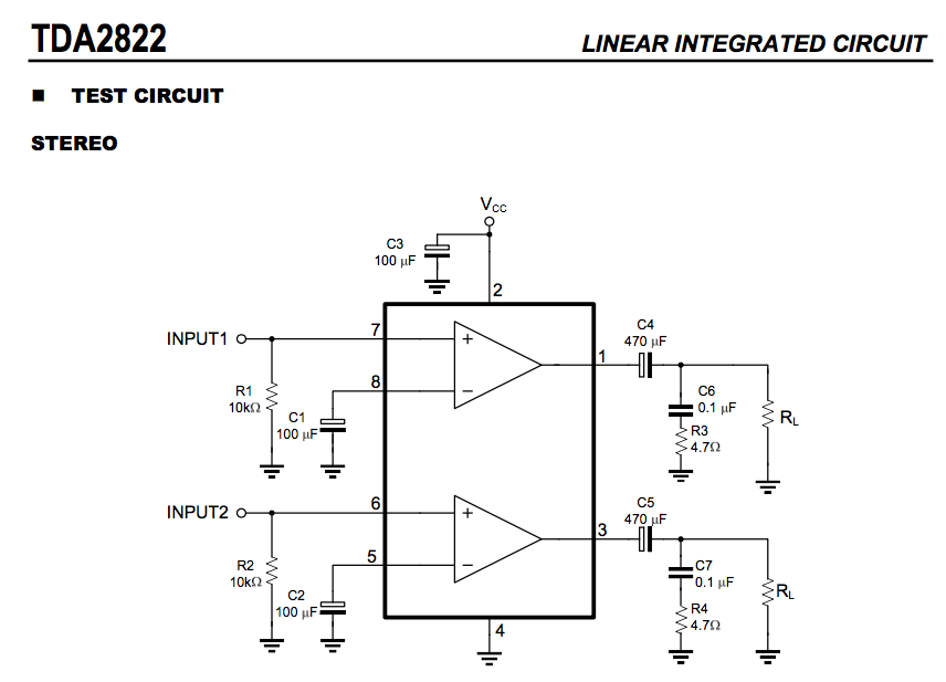

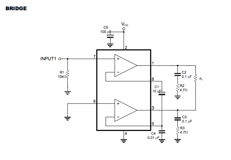

So i'm playing around with the TDA2822 for a portable guitar amplifier.
I just received the chip so last night i tried to breadboard the test circuits from datasheet just to hear it work.
I tried both the bridge and stereo (using only one input) configuration, but in both cases I got a loud high pitched noise as soon as the chip was powered. And i THINK the chip is running hot pretty fast, but i didn't dare to keep it powered for long.
As the datasheet circuit is pretty simple, I don't really see what could go wrong with this.
The only changes to the test circuit are that i added a cap in series with my input (guitar), C4 (output cap in series with pin 1) is 100uF, and R3 (resistor of the zobel network is 3.3r instead of 4.7).

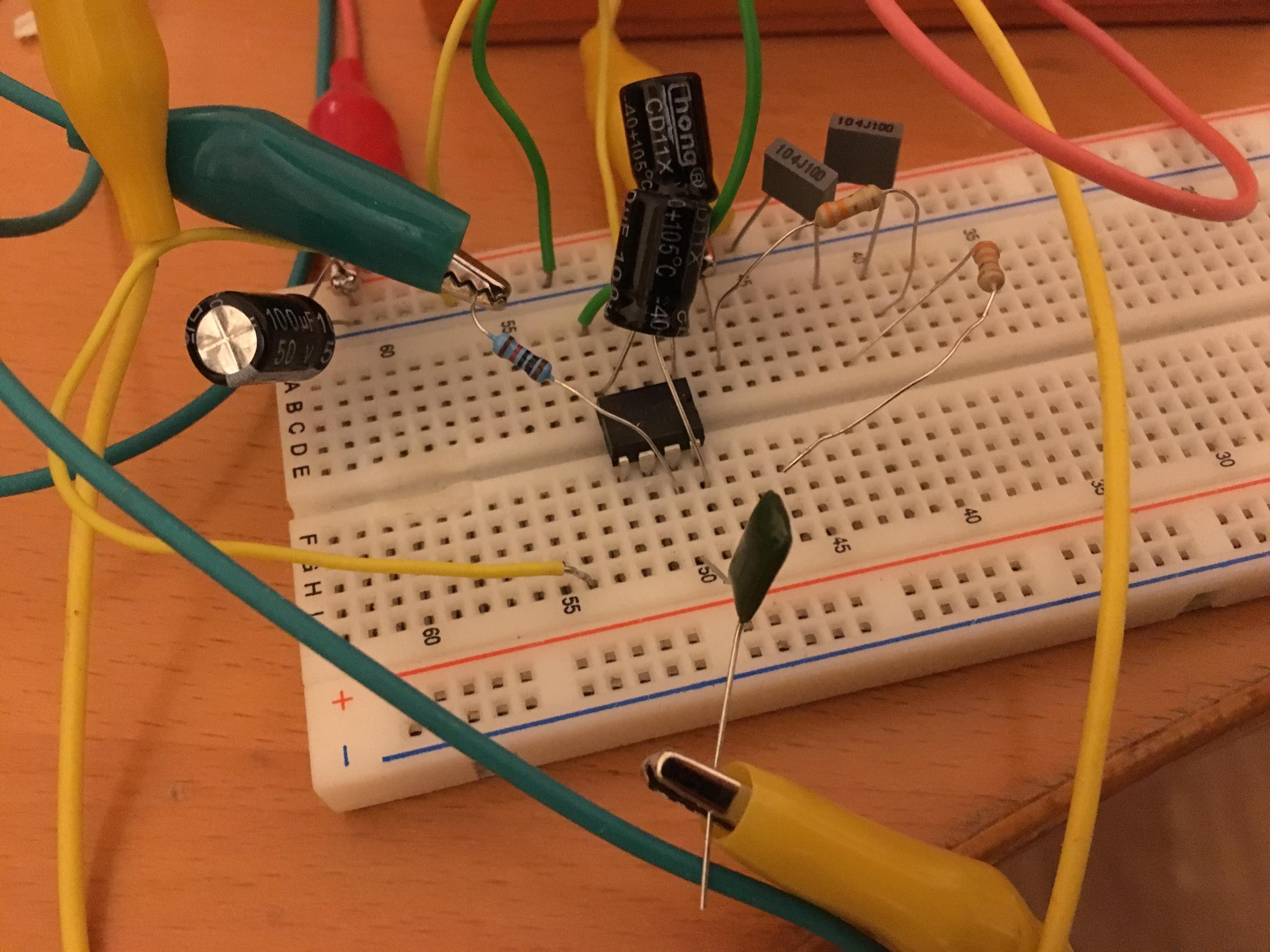

The pictures show the breadboard for the stereo circuit. theres still an unused zobel network that was used for the bridge configuration (out of curiosity, isn't it better to have one zobel network between the two drivers outputs in that case? i think i've read that before).
Could it be because it's breadboarded? too much gain (from the datasheet, the gain seems to be fixed into the chip by an internal resistor)?
Any idea would be appreciated, i'm out of idea

TDAs are very sensitive to layout.
My suggestion is to look into where your zobel networks terminate to the ground. Contrary to known "good practices", TDAs may work better if you move zobel components as far away from the chip as possible (within reason). You must be aware of bad ground loops and positive fb that can happen if there's a signal injection into your "ground". This can happen if you neglect good supply bypass (a 'lytic between Vcc and gnd, as close to the chip as possible), and if you connect the zobel returns in such way that they actually inject "bad fb" into your ground. This is easy to try - see if oscillation goes away when you remove the zobel. Use a couple of ten ohms dummy load during the test, like 22r or something.
My "stability test" with various TDAs is to short the + input to the ground connection, and if the circuit oscillates you most likely have a layout problem - or alternatively a bad chip.

  • My suggestion is to look into where your zobel networks terminate to the ground. Contrary to known "good practices", TDAs may work better if you move zobel components as far away from the chip as possible (within reason). You must be aware of bad ground loops and positive fb that can happen if there's a signal injection into your "ground". This can happen if you neglect good supply bypass (a 'lytic between Vcc and gnd, as close to the chip as possible), and if you connect the zobel returns in such way that they actually inject "bad fb" into your ground. This is easy to try - see if oscillation goes away when you remove the zobel.
    How can I avoid that in such a simple circuit, in a breadboard? The way it's built now, i guess it could be possible that the supply bypass cap is not well placed since I have it on the extremity of the breadboard, then comes the connection to R1 (10k at input), then ground for pin 4 and cap of pin 8, then the extremity of the zobel network. So i guess it's entirely possible that pin 4 and 8 get some residuals from the zobel. Its actually really interesting as i never had a practical experience with ground loops before. Yay 😀

Pin6 does need connecting - either via resistor to 0V or direct. Ditto pin 5 via cap. Also C3 the supply decoupling cap does need to be really close to the IC, preferably also bigger than 100uF. I'd use a minimum of 470uF myself.
I'll ground pin 6 and 5 then, and try to find a bigger supply cap.
Thanks for helping i'll try that and let you know if it's better
But it was also happening in bridged configuration with pin 5 and 6 connected so ... i guess that's not the problem here, even if it's probably a best practice to remember 🙂
Ok so I
- paralleled 4 100uF between supply rails to get up to 400uF
- Tried to remove the zobel
- Tried to rearrange the order of the ground connections to have the ground to pin 4 and 8 close to the supply caps, and to the connection to my PSU ground, and the zobel network ground connection on the other side
- added a 100nF supply cap
aaaaand it's working!
Thanks for your help! i'm trying to bridge it now.
You might have to solder this up on a piece of prototype board if you want this to work. Those plug boards have very high row-to-row capacitance. That could cause the chip to go unstable. I'd also look into proper decoupling of the chip. You'll want 100 nF from the supply pin (pin 2) to ground placed as close to the IC as you can get.

With single-ended amps; IC-amps in particular, my rule no.1 was to religiously ground-reference everything to the "-" power-pin(s) of the chip. This pin (or pin-group) should be your local gnd star-point, alternatively the star-point could be also the "-" pad of your IC decoupling cap, whichever works better in your app. hth.
IIRC, ST appnotes and datasheets for TDA chips include factory-recommended pcb layouts. Study these and as tomchr pointed out, try to prototype on some kind of a perfoboard.

Well i guess that was it! using the ground of the IC as a reference for the speaker solved my problem.

Ok, so now i'm trying the bridged version and i have another problem that i never experienced before.
With no input signal I don't have oscillation anymore, everything seems fine.
When i touch my guitar, as soon as some audio signal goes into the circuit, it kindof shorts out. My PSU light goes off, the HP make a light 'thud' noise, then the power comes back, and it happens every second or so.
If i try to increase the volume of the input signal the frequency of this power loss increases.
What could be the cause of this? not enough current draw on my PSU?
Ok so i just tried to use a 9v, 500mA PSU to power this and it's still happening so i guess it's not lack of amperage.. this small chip wouldn't draw more than 500mA would it?
spec sheet states 1.5 amp peak @ 15 VDC.
so yeah, current is insufficient especially with 9 v and only a half an ampere.
