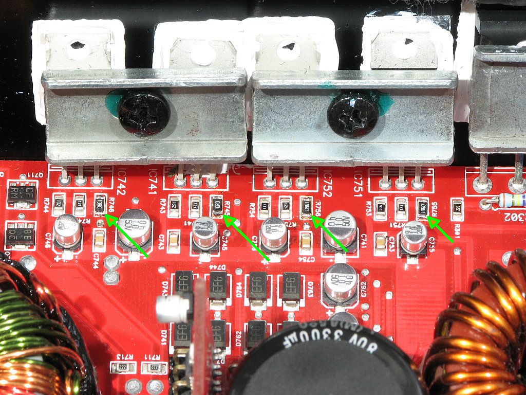

They are the 8 pin SMD ICs. They are marked 072. There are 5 on the bottom of the preamp board. It may be difficult to check them. If you want to check them, you may have to remove the board, solder wires on the output pins of the op-amps and then plug them back in. Another option would be to remove the board and find vias that connect to the output pins and check those vias on the other side of the board instead of probing the output pins directly.
