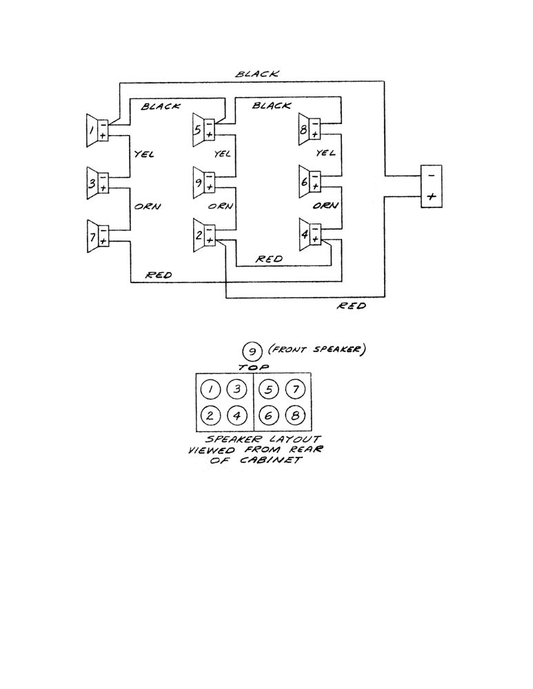

Original Bose 901 Internal Wiring Diagram
I'm not sure if I still have the diagram but it depends on which series of 901's you have. Do the drivers have 3 or 4 screws holding it into the enclosure? The 3 screw are 1 ohm and wired in series. The 4 screw are 8 ohm and are wired in a series/parallel combination to net 8ohms to the amp/reciever. This is a quote from 901fixer and my answer to this is 3screws. still the question remains on how to get to the front speaker.
