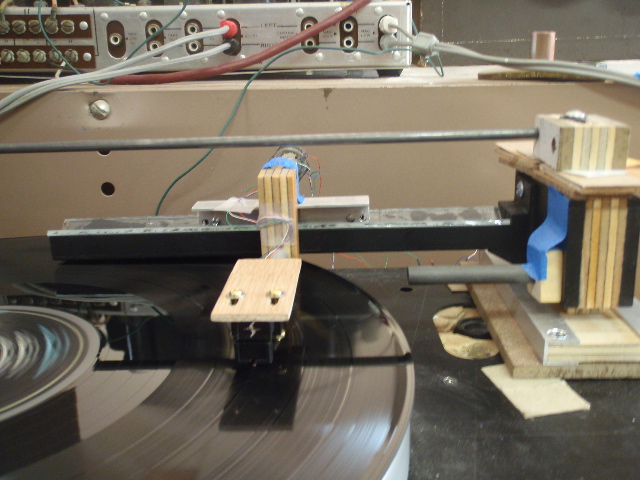

BillG,
I just tried and experiment prompted by your questions. I put the entire arm/carriage including CW, cart and stylus on a digital scale. it weighs 60.3 gr. I put the bar directly over the magnets but high enough not to have any effect until I slowly lowered it. The measured weight decreased to about 45 gr before the magnets grabbed the bar. Then I placed the bar over the rear half of the magnets, which is the working arrangement for playing records. Again, the measured weight fell to 45 gr. For the complete assembly, I adjust the bar height to a point slightly above where it pulls the bearings up to the inner surface of the tube, so the bearings are unloaded by approximately 15 gr.
When I was first putting this idea together, I tried putting the bar directly over the magnets, which are directly over the bearings, and over the front and rear halves. Directly over resulted in carriage chatter at the point where rolling friction decreased. The control I'd hoped for from the magnetic field just didn't happen, which was disappointing. Putting the bar over either the front or rear half stopped the chatter and lowered rolling resistance, but over the front half made VTF adjustment a serious problem, which would require a large CW to overcome. With the bar over the rear half, VTA and VTF adjustments were pretty straight forward. The CW started at the rear of the stub because I'd made it as light as possible for this arm.
A lot of the good things that happened were serendipitous, just positive accidental consequences of arbitrary decisions. For instance, when the arm pretty much zeroed itself as I adjusted the bar down, despite the bar being to the rear of the bearings, it was a complete surprise and it took a moment for me to realize what an advantage it was.
And all of this is quite likely specific to this arm. My guess is that better bearing/horizontal surface combinations, like your glass trough or a better tube, would offer inherently better control, which means the mag guide would mostly becomes mag weight relief, set up adjusting, and damping. And I think that's a good thing.
If I understand the U clip idea right, I think it would work. I used used full width shelf because I didn't know where the magnets would be most effective.
I did the bearing corner check you suggest and they're OK. I think the bearings are just sketchy, especially under a load.

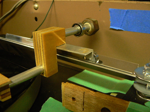

Thanks for the fast reply and the experimental data. An old postal scale puts the weight of my assembly at 59-61 grams. Can't read it any closer than that.
I have a suggestion for your first glass track experiments. To avoid problems with the magnets lifting the carriage out of the track and grabbing them. If your glass is small enough fit the entire V into one of your slotted tubes. The tube won't do anything but capture the carriage if you get the rod too close to the magnets. If not, try to fit some kind of barrier to limit the upward travel. My first experiments didn't have anything like that so the rod grabbed the magnets quite a few times.
As to having the bar/rod over the front or rear half of the magnets, that sounds like a change in VTF issue which may clear up with the U clip setup. Next week I'll try to explore that. I wonder if the magnetic force vector being other than straight up is unloading the bearings more on one corner than the other, perhaps even to the point of making the bearing a rolling knife edge design. hmmmmm???

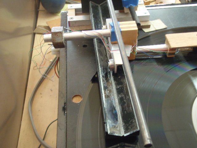

Good morning,
I've gotten the glass track built with a new carriage, with taller bearings, to accommodate the higher walls. The glass has a wood cradle and the V is angled at 120 degrees. The carriage came in at about 47 gr. I polished the bearing corners and I agree that it makes a difference. The carriage rides very smoothly on the track, noticeably smoother than the copper tube. The vertical movement is also smooth and setting VTF seems to be accurate and not difficult.
I tried a single magnet, under the blue tape, for the mag guide. It works, but is very finicky, effective at only one very specific setting, and generally isn't satisfactory, so I'm going to modify the carriage for dual magnets. The single magnet sometimes seems to act as a pivot.
I may also try increasing the carriage weight.
Without the mag guide, the stylus is hunting badly. I think I'm just going to have to spring for some quality bearings. In some ways, the glass track emphasizes the bearing deficiencies - if things aren't working right, it's not the fault of the track surface.
I've changed so many things, there's really no way to compare this model to the previous one.

Good evening and thanks for the update,
Your glass track looks to be well done. You ran into the same problem as I did by making the glass sides too tall. If you check my pics you will see my solution. Make the glass slips .25 to .30 inches wide and the wood cradle small enough so the glass edge is up above the cradle. Better yet use two cradles, one at each end of the track where the bearings never go. You may have to use a slightly longer track. Now you should be able to use the bearings you have used successfully before. Also note that with my smaller bearings I had to undercut the bearing support rods with a file to make a half round recess in them for the edge of the glass. My design uses 90 deg angle for the V but I think your 120 deg may actually better. As I said in a previous post I used the 90deg because I had one all made up at the time. We go to great length to secure a good smooth and hard surface for the track. Then we roll two bearings along its surface. The rolling edges have to be as nearly the same surface finish as the glass. I'm glad you have found the glass to be better than the copper tube. Now think about what happens inside the bearing. The bearing races are like a linear track but rolled up into a circle. Now we have some steel balls trapped in that circle and rolling on it. For best performance the balls and races will need to have the equivalent surfaces as the outer race corners and the glass track. Once we meet or closely approach that condition these LT arms work really well from what we read and have experienced. I assume your stylus "hunting" is where the carriage is sitting still, stuck as it were in one spot until the side thrust from the record groove overcomes the obstacle(s) and the stylus moves backward to its center position. All my comments apply to the best of my knowledge. Playing a record with my setup I can watch the stylus remain centered in the magnetic gap and watch the bearing roll in its races as the carriage goes back and forth following any ex-eccentricity of the records. So, if your smaller bearings don't work out with the glass, I guess you will have to pop for some better ones. Do you have a specialty bearing supply house within reach where you could go to make a selection in person? Good luck with your efforts, I think you are very close to the ideal conditions.

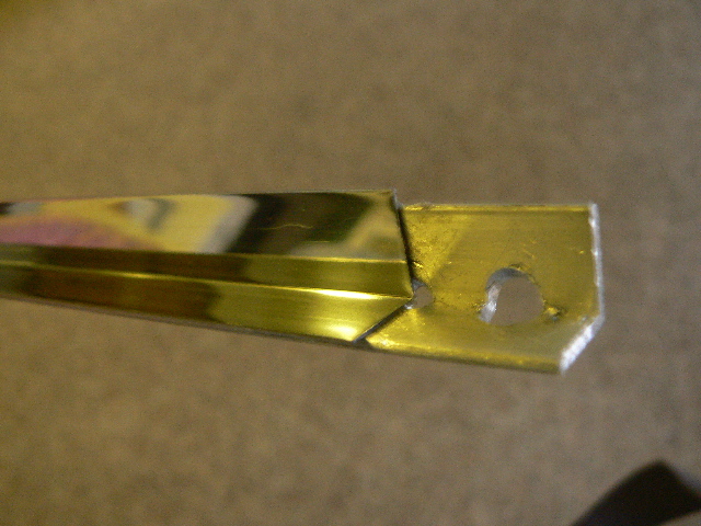

Bad new flash! Magnet/bearing proximity may cause bearing malfunction, may sort of squinch the bearing parts together and increase friction. I'm not certain, but I'm not happy about this. I'll do more checking and post. BillG, would you check this out, too, please?
Doug,
When I started playing with the mag guide idea briefly I had the misfortune of contacting one of my bearings with a magnet. Suspecting a potential problem I removed all magnets from proximity to the carriage, like far away. Then I spun the bearing. It didn't run for long and always came to a stop in the same orientation. Mind you, this bearing was "magnetized". So I cleaned it carefully and demagnetized it. Have a big bulk tape demagnetizer but for this job I just used my soldering gun. It was easy and handy. Bearing ran fine after degaussing. Tried re-magnetizing again and same results. I've not tried using a magnetized bearing in the functional LT arm. But it is a safe assumption that a compromised bearing will affect the tracking performance. I didn't mention this earlier because my problem was clearly the result of my own carelessness rather than the magnets in what we assume would be their proper position for the mag guide. Please forgive me for not raising a flag on this one. For now I have discontinued the mag guide experiments. Could be that a full ceramic bearing would be made from nonferrous, non magnetic ceramic material and therefore immune to the proximity of the magnets. Will have to check that one out.
If the ball bearing assembly gets magnetized so that there is a north pole on the rim of the outer race and a south pole on the other side, 180 degrees away, a similar magnetizing of the balls and inner race will take place. Now rotate the inner race any number of degrees and let go of it, It (the inner race) it will rotate back to its static magnetized position and that there will be holding torque impeding its free rotation. Put an alternating polarity magnetic field external to the outer race and the inner race should run nicely as an electric motor.
