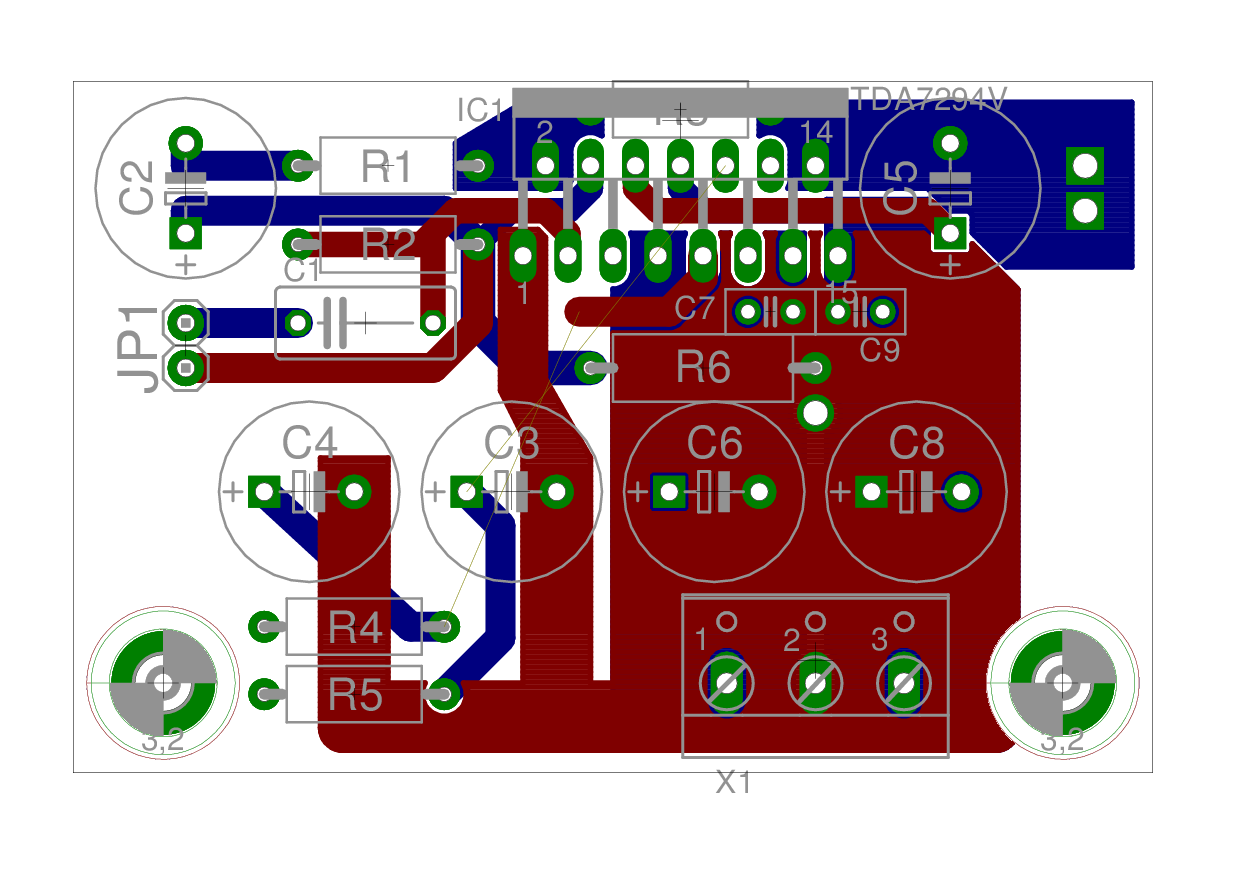

Here is a careful start to a layout. I like the way pins 13-14-15 and 7-8 are grouped together, should make the supply and ground routing easier.

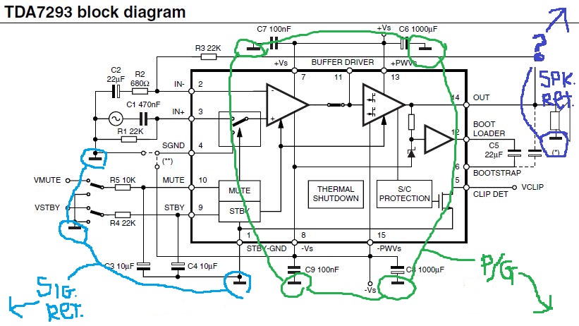

That question--Speaker ground = power ground.
Your negative feedback is a circuit. And circuit means loop, which does require a return. The negative feedback makes a small to large signal transition. The return for that one is the 0v at the amplifier board.
If one can momentarily overlook the vexing pinout and succeed nevertheless (postage stamp sized board?), then Pins 1, 7, 8 on the schematic that you posted, all have the same 0v.
Standby circuit is located at the output of the small signal voltage amp and belongs to voltage amp power group.
Mute circuit is located at the Input of the small signal voltage amp and belongs to small signal input group.
It is not especially erroneous to assign pin1 return to small signal, because indeed the current is really very tiny, and because, assuring the absence of layout foobar despite vexing pinout makes the board so small that the whole business is buss ground and a moot point. The discussion of separated grounds is only relevant to a large sprawling layout that would inherently assure instability. No dice. Don't even worry about it, but instead, just buy a tiny board and then route the signal resistors directly, by shortest path, under-board, instead of the popular combination of decorative and dysfunctional placement.
Basically, the available boards don't support the ideals.
Thanks Mark, you don't think it would be a noise potential to connect all the grounds on each amp board? I 've been reading multiple recommendations to keep the signal returns separate from the psu ground, but join them with wires off the board, in a star-ground configuration. Then add the chassis ground, though isolated from the other two with a C and R in parallel.
I've been also wondering if a small diode where the signal ground connects to the power ground might help prevent PSU noise from flowing on to the signal circuits?

The discussion of separated grounds is only relevant to a large sprawling layout that would inherently assure instability...Basically, the available boards don't support the ideals.
Aha! - that explains it. Ok, I can understand this... none of the publications I've read talk about board size. They are just dealing with abstract ideal concepts. Thanks for bringing it down to my level of understanding.

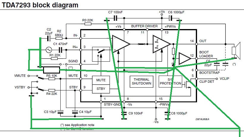

I put in an extra resistor (1R or less) between input ground and power ground, If you do this on every channel then add a ground loop breaker between the power ground and the chassis/PE, you should have no problem with ground loop noise.
Ok, this sounds simple and easy enough to do, it's that whole question about insurance, I really hate paying for it, until I need it.
Thanks Mark!
Sixto.
Not so sure if it does anything for audio, either for or against. But, I'm very sure that it will promote good layout and understanding as well. Let's consider it mandatory, because we are, for sure, in need of good layout. Your concept forces good layout. Yeah, that's alright.
The great part about this design is that the 1R resistor is optional, replace it with a wire and you still have the best ground layout. If I can find the time I will make a start on a PCB design.
The decoupling and boostrap caps all go as close as possible to the chip.
Where the majority of designs have failed is being overtly concerned about the standby and mute features; and, therefore I suggest to tack them on lastly.
Don't know if I can be much help there, but I'm definitely interested, and would love to contribute some thoughts... One thing I've read in other posts is that people often lament having to place the TDA7293 chip so close to one edge of the board (due to heatsink requirements). I wonder why we couldn't place all the bulky components on the bottom, and keep only short components such as resistors and connector terminals on top. This would allow placing the chip more to the center of the board, with closer placement of surrounding elements to their pins (and ground/power traces) on all 4 sides, and still leave enough room for a heatsink to float above all that, and even span 2 or 3 boards!
Another idea I first saw on Daniel's P2P thread is how easy it is to solder the feedback resistor and bootstrap capacitors right on the pins. Don't have to do a lot more than that to save some board space that can be used for other components. And who says everything has to be on the board?
Third, is one of the boards I got as sample, had a number of vias touching the chip-pin vias. Almost like a P2P layout (or next closest thing!).
Who knows, maybe my 30 years of bricks-and-mortar architecture and design background can contribute something? I can almost visualize this thing in 3-d space. (too bad I don't know how to use PCB layout software...yet)

Work in progress. Datasheet figure 1, missing st-by/mute and zobel.
I think we should use the st-by/mute as used in the figure 25 of the ds. Connecting the chip pins together with only one control circuit.

Stability (and potentially resolution/imaging/realism) is improved by locating C6 and C8 decoupling caps Much Closer to pins 7 and 8.
In my opinion the compromise of having accessories like R6, C7, C9 push the decoupling caps farther away from the chip, couldn't possibly be worth what that costs.
P.S.
The feedback-shunt, R1 and associated coupling cap(s), C2 are positioned nicely! Love the orientation of C2, in case I need to add more caps off the edge of the board, it is super easy. THANKS!!!! Might suggest making R1 vias both resistor and cermet trimmer compatible--that dial can buy 2x lower gain.
