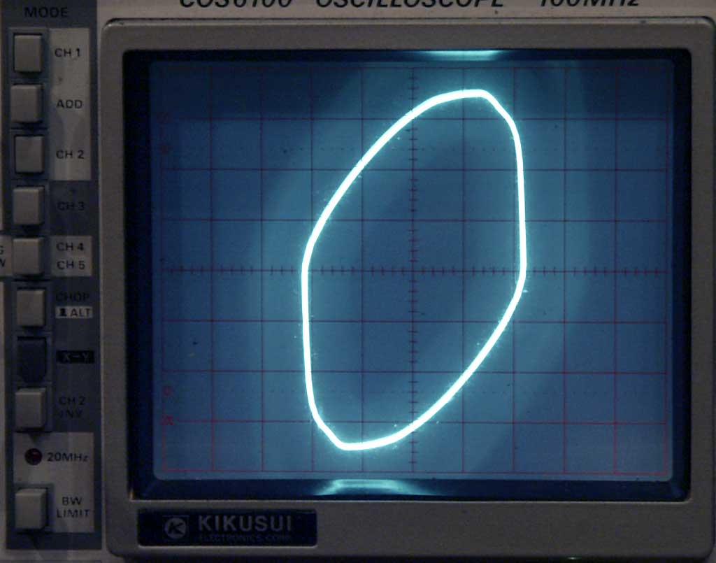

Wien oscillators are sensitive to temp variation. VPI used a Wien bridge osc in their ADS power supply and the frequency drifted up ~0.25Hz with temp over 10-15 minutes:
ADS temp drift
The stability was approximately the same as an average wall socket, but the accuracy was many times worse.

That shouldn't happen. I had a clock correct to 7 seconds a day on a Wien. The trick is NPO caps that are 30 ppm. Folklore has it they are best suited to 1% resistors. Crystals of the type Linn used are 30 ppm. Polyester are often 200 ppm and polystyrene between. A 10 nF COG/NPO costs pennies. TL072 a good op amp at 50 Hz. Silver mica are posh NPO.
The difference I believe, is the clock probably didn't generate much heat. The ADS amps had heat sinks that were internal to the case and the air temp inside the enclosure could exceed 60°C when powering an 7.5W motor; I could watch the frequency change as the temp of the supply increased. At room temp (or with the top cover off) this did not occur.
No. I have had that problem and it affected voltage more. If you take a remarkably small amount of trouble the problem vanishes.
What is noticeable is stability takes a few moments to go from good to excellent. To power the oscillator 24/7 is a low cost option. If using diode stabilisers LED are a little better.
