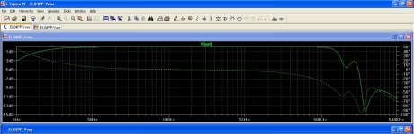

Sheldon said:The first transformer I made had a hf roll off around 60kHz, and very nice 10kHz square wave - nice shape and just a little ringing. I didn't do a very good job of getting the margins for the secondaries, as described by Bud. They tended to cover the bobbin end to end. I got better on the second wind, and everything was a little neater. But the performance was worse - 41kHz roll off. OK, let's try a third, neater still. This one had the 3dB corner at about 35kHz.
Here's an interesting finding (probably no surprise to Bud), that I also reported in my amp thread.
I didn't pot the bobbins, but applied shellac to the windings as I proceeded. And I wound each and finished it up in the same day, so the shellac was not completely dry. The first transformer had been sitting a few days before testing, the second was tested the day after it was made. Now a month later, both transformers give the same -3dB point of around 65k. I was surprised to find that a few day difference in curing made a significant difference. Not surprisingly, the 10k square waves look very similar too now (and good, just a little ringing visible as a slight ripple on the top and bottom).
So, winding technique seems not the issue, but potting and cure apparently is.
Sheldon

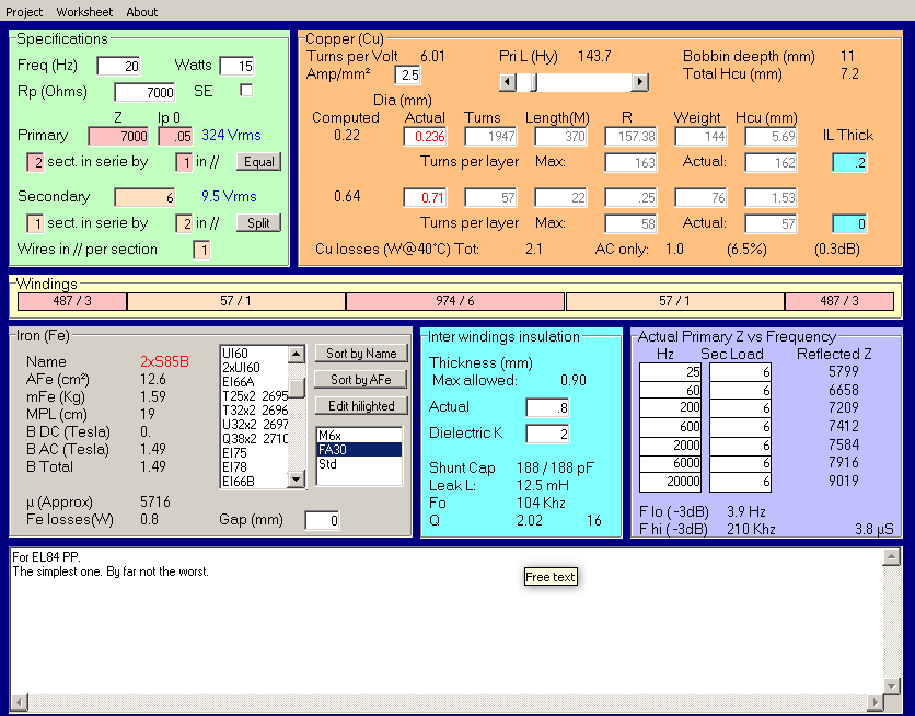

EL84 PP OPT
Hi Yves!
Could you give me some help to design a PP OPT for EL84?
8K, 20Hz, 15W on SM85B
I am a bit confused, because when I calculated the OPT with the classical methode I got ca. 3200 turns for the primary, but when I was simulating it with your program I got much better results with ca.2400 turns.
I don't know in which one should I trust....
Greets:
Tyimo
Hi Yves!
Greets:
Tyimo
Hi Tyimo.
This core have dimensions very similar to 40mm of EI96 lams !
Here is my guess, here is why:
-1 Keep primary turns as low as possible as long as the B total doesn't exceed 1.5 Tesla for the max power combined with the lower frequency.
This drastically reduce leak inductance allowing for a simple interleaving scheme.
-2 Reduce parasitic caps using thick insulation between sections (here 0.8mm cardboard) and between primary layers (0.2mm cardboard). Don't use mylar wich exhibit higher dielectric constant (with pentodes, even feedbacked, I feel that keeping parasitic caps low is more important than low leakage inductance).
Keep an eye on Fo (the resonnant frequency due to the combination of leakage inductance and shunt cap.
Keep the other on the resonnant frequency of each primary section that is shown by "left clicking" on it in the central horizontal yellow zone. Increase ILThick to push'em above the previous one.
Then play with wires diameter for best filling (full layers) while keeping another eye on losses and bobin over filling.
Some iterations may be necessary
Here are my rules, only mines ! You have not to agree with
Yves.

Hi Yves!
Thank you very much!!!!!
I made the simulation with the LTSpice and its looking very promising!!
One more question:
Is the wire diameter a Neto or Brutto value in your program?
Thanks your help!!!!
Is the 1.5 Tesla not too high for this iron? I know the C-cores can go higher than ordinary EI, but I thought ca. 1.2 Tesla is the limit.1 Keep primary turns as low as possible as long as the B total doesn't exceed 1.5 Tesla for the max power combined with the lower frequency.
One more question:
I routinely use 1.4 for GOSS EI lams.Is the 1.5 Tesla not too high for this iron? I know the C-cores can go higher than ordinary EI, but I thought ca. 1.2 Tesla is the limit.
Considering that C core are made with a bit thinest foil (0.3mm rather than 0.35) and that grains are all correctly oriented unlike in EI, I beleive that 1.5T is rather conservative
Remember than this occurs only for the improbable combination of full power (15W) at 20 Hz
Grade 1 insulated copper is assumed.One more question:
Yves.
