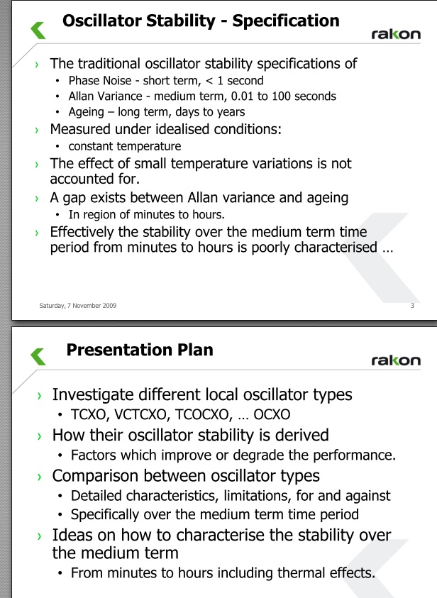

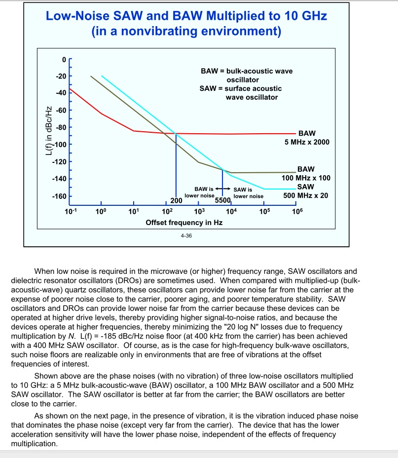

Guys / Joe
I'm guessing 'wander' will come some where in the Allan Variance (Deviation)
and phase noise very close to carrier, say 1Hz offset. See attachment
below.
Joe, I'm guessing you are alluding to the fact that stability in the range
>10 sec is important? All your work seems to point in this direction. In this
case look at getting Allan Variance measurements for the oscillators and
look at phase noise 1Hz and below.
I would be surprised if stability in > 1000sec range is of critical importance,
interestingly, in the Rakon paper they suggest this range is not well
characterized.
At the end of the day, again, I still come back to the basic premise that we
have conflicting results here.
There is a huge effort placed on reducing LF noise in power supplies but all
the info I can turn up suggests SAW oscillators have worse low freq phase
noise and med / long term stability than BAW. Ref to attachment below.

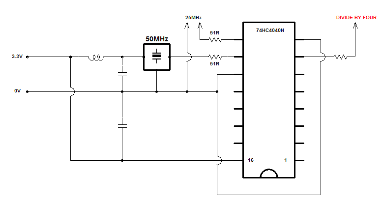

For those here, the Epsom 100MHz SAW is available from Farnel/Element14 - and the part number is 1907482.
The Oz website is: XG-1000CA 50.00MHZ 100PPM CC - EPSON TOYOCOM - OSC, SAW, 50.00MHZ, 100PPM, 3 | element14 Australia
Yes, they are cheap. But Epson also make a more expensive range and when you compare the relevant specs, they are basically the same. I can only think that this has something to do with scale of production and that they have made a stack of them. They are not that hard to get.
Cheers, Joe R.
PS: It's important to have a Ferrite Bead right on to the SAW 3.3V input and I also put a 10-22uF Murata SMD after the bead. or you may get glitchy noises.

Based on your idea, I think I want experiment more with divided clocks (using higher frequencies oscillators).
Yes, in the Oppo 105 we may consider using SAW on the DAC and Crystek on the Mainboard.
