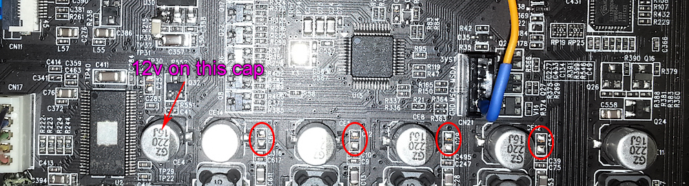

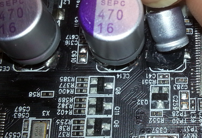

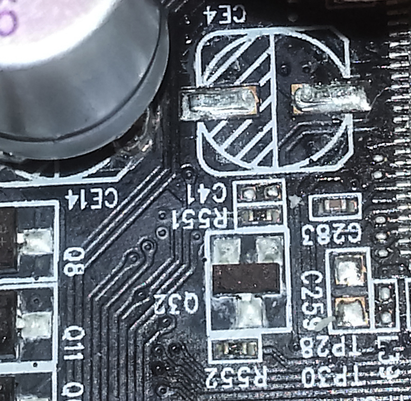

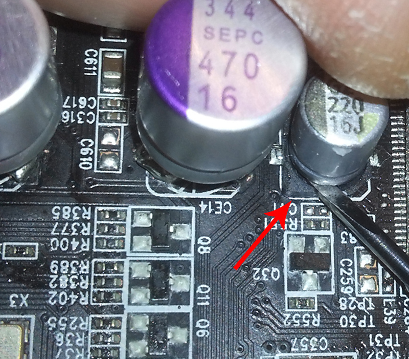

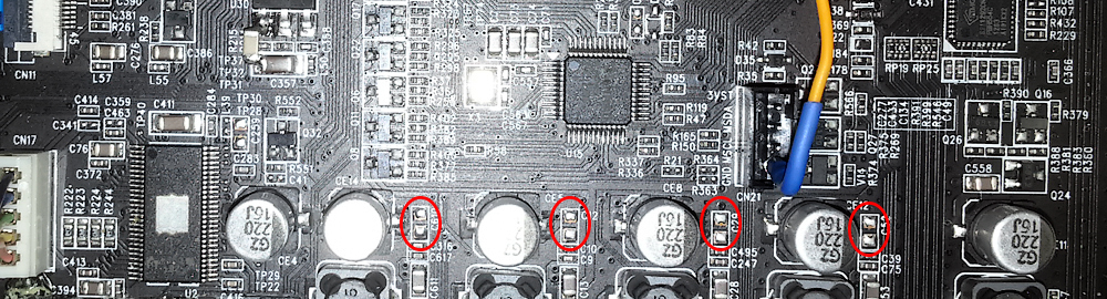

I was not the supporter of the replacement of these filtering caps (103, 105 models), but doing it at least, I could notice an slightly improvement for both sound and picture quality, on an already (completely) modified device. I do not know how this mod it will be noticeable when done it before anything else (improvement), but few peoples who did it, stated about improvements... Well, up to you to try it...
I was intrigued by the missing (unpopulated) ceramic caps beside these electrolytic filtering ones. These components were omitted to minimise the production costs. However, I appreciate these ceramic caps as important filtering devices, especially when about an SMPS output. I decided to repopulate the board with 0,1µ caps.
For those who may want do this mod, replacing these filtering caps, I may suggest to use quite near values (I used double values, and it works fine), to not load too much these small SMPSs, especially at the power up sequence. Too high capacities here may also increase the voltages on these outputs, which is not one will want at all...
The biggest problem with this mod is to remove the old caps, without damaging the board`s traces/pads. I may suggest the follow (mechanical) procedure, which I tried it with success (after doing it by unsoldering on another board): Place a tool (very small screwdriver) on this side of the cap, as you see in the picture 1. Force carefully that side of the cap upward, until you feel it following your pushing force. Take out the screwdriver and move it back and forth in that same axe. After few such movements, push it again even more up, using the small screwdriver. Repeat the back and forth mouvements until it broke its legs. Do not use too much force in this operation, to prevent disclosing the cap together with the pads. Else the pads, are at normal temperature very solid glued on the board, and it tolerate very well this mechanical operation. Unsoldering operation it will disclose at once the pads and the traces. Not recommended at all!
Remove the rest og the cap`s legs with a low power soldering iron. That`s it!
Solder carefully the new good quality ones (lowest possible ESR) in place, the ceramic caps too, and be happy with the slightly improvement...
Most of the important improvements it come from other more complexe operations/directions...
BTW, the voltages at these outputs are under 6v, so 6v rated caps can be very well used here...

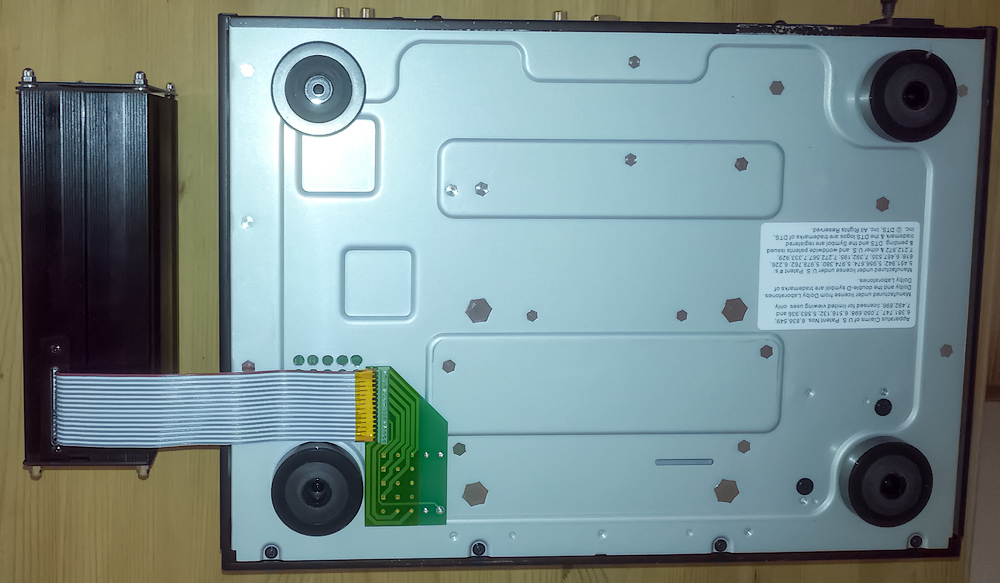

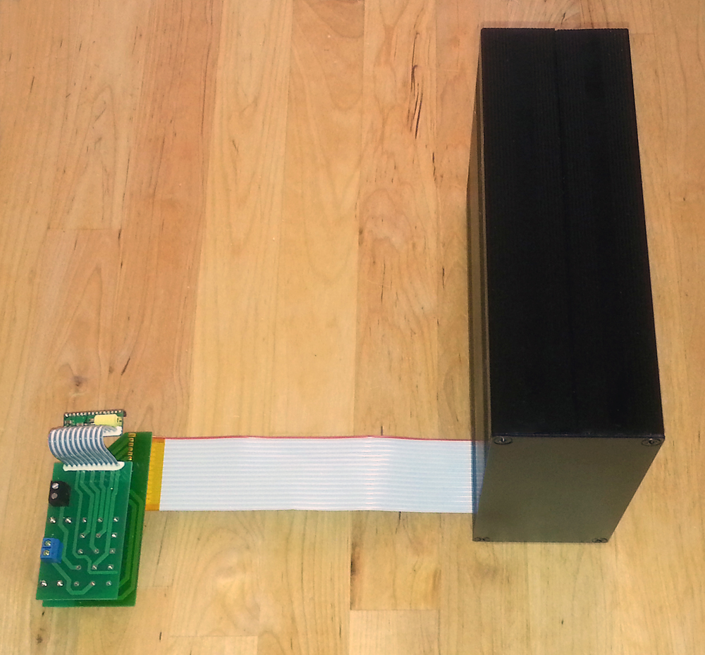

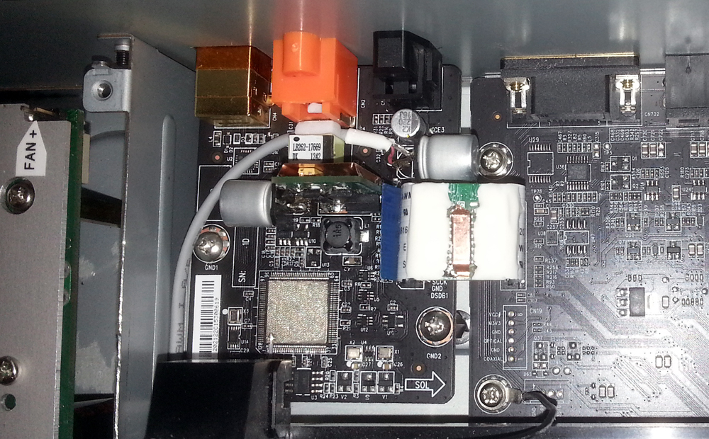

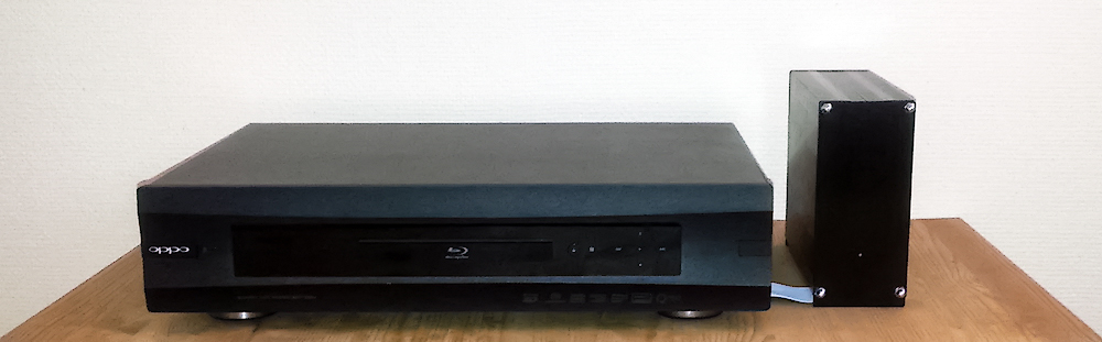

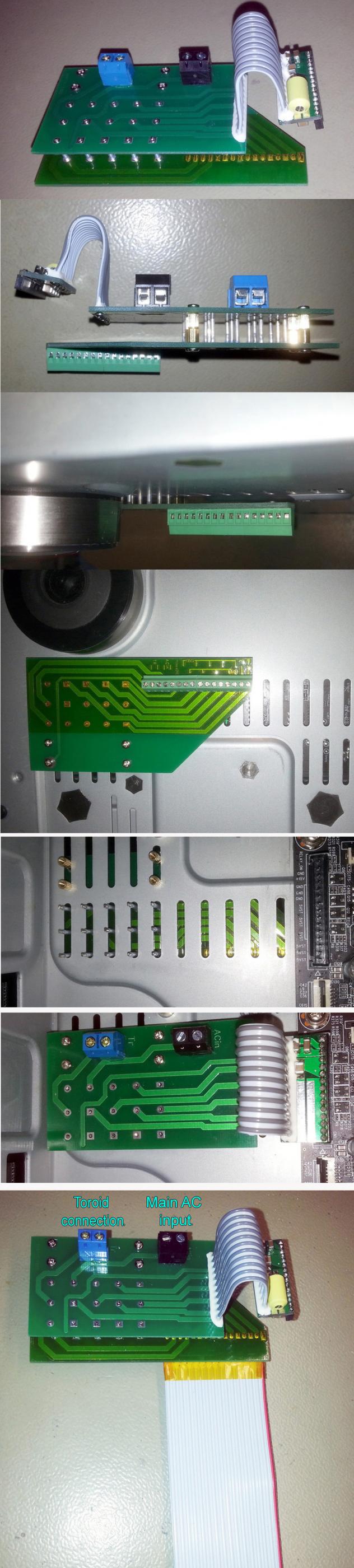

Isolated interface for USB board
I`m pleased to announce an quite important upgrade for 105/105D models: isolated interface for USB board. Now this device it is as it should on this area too. Its USB interface is now fully galvanic isolated from the rest.
A professional approach it will be available soon...
My last USB board mod with the isolator in a quite prototype stage. A more professional edition of the isolator it will come soon...
The coax and Toslink interfaces on board, are disabled as follow this mod.

External LPM for 105/105D and 95 models
There is my approach for an external PSU for 105 and 95 models. The adaptor you see in the pictures, it fit for both 95/105, as the chassis pattern for perforations is the same. The sape of the perforations it differ, but my adaptor it fit in both cases. Shielded connection cables for main AC and toroid transformer are also included in this approach, but are not pictured. An similar light indicator, as on the players front panel (on/off - blue/red) it is also available on the front panel of the external LPM. Else no any other connections, but the flat cable.
I chosen the connection between the main flat cable and the adaptor, to be by screws terminal block, as this way it provide a better and much more ferm connection than a usual multi pins connector. At least the user may seldom need to connect or disconnect this external PSU, from the BD player.
After the adaptor is mounted in place, it need to be soldered for the contact pins. So this adaptor and its boards is to be permanent installed into device, and only connected or disconnected accordingly with the needs...
As one side of the LPM`s enclosure it is used as heatsink, the position of the box should be always vertical.
My external LPM approach. Here is pictured the 95 model, which is the main target for the concept, but it fit very well for 105/105D models, especially when the user need the multichannel board in place and functional.

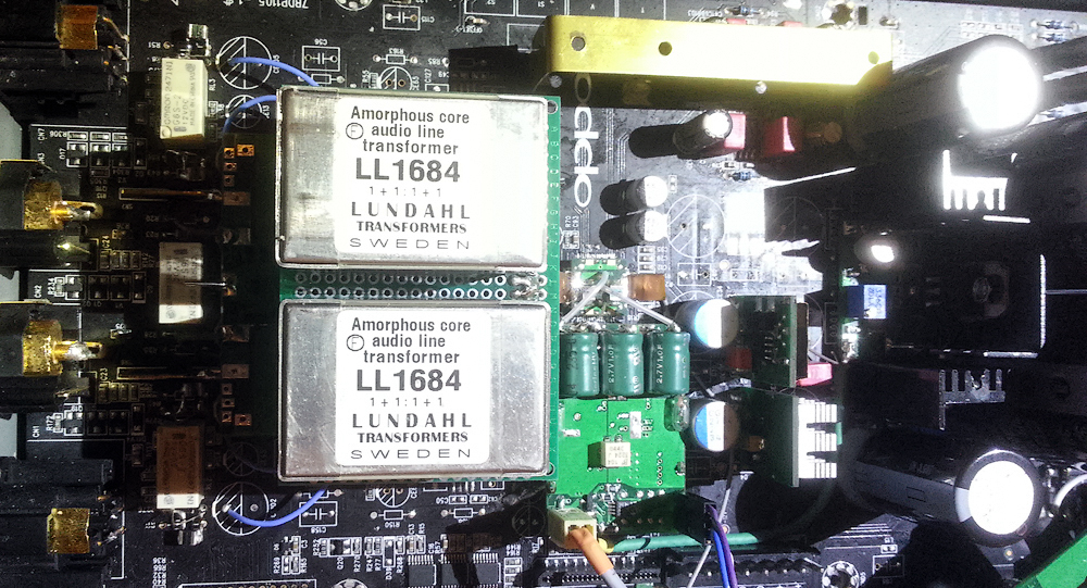

Experimenting with transformers...
At least I was able to use my Lundahls 1684, I bought it for more than one year ago, as output stage for 105.
I have to admit that this approach is the simplest, very efficient and at least with the slightly better quality results, than my differential (active) output stage.
Using this passive stage for output, it simplify even more the whole modification approach for this player. There is no need any more of improved filtering or regulators for +/- power system on stereo board. With these transformers in place the only positive rail of this dual power system is used to power the mute relays (if the headphone chip is disabled/dismissed, as the rest of the original circuits). The general inside heat get lower. No any need for AC coupling on outputs, or improving of this stage.
The only modifications it still rest as necessary are the power system of the DAC chip, its clocking approach, as linking together the two differential outputs pairs available from the DAC (105 model). Then connect the transformers, and done!
I have experimented with different connection modes for the transformers (the known ones from these forum/threads). At least I chosen a quite simple connecting approach: the two DAC side windings in serial, and the output windings in serial too. Pure 1:1 as the transformer actually it is built for.
Comparing with my active differential stage, this passive one it give a lower output voltage (normal for such 1:1). I have 3,3Vpp on XLR outputs, instead of 5-6Vpp (active stage). This is not so big problem, as this almost 3dB level lose it can be easily compensated by the amplifier.
So far, so good...
The most interesting part of this experiment is the using of the (wide disputed) cap over DAC`s differential outputs. The effect of this cap it still apply very well in this transformer approach, as also Joe previously mentioned. As I want to keep the amplifying system`s gain as low as possible, I decided to not use a quite low signal level on the outputs in the Joe`s exposed approach. However, I mounted the cap over the DAC`s outputs, as I do it for my active differential stage. I used first the same value cap as for my module. It was wrong! A muffed sound, with well-increased low-end spectre, but strong attenuated high end. This attenuation it was perceived in a quite special way: a soundstage perceived as very far in space (far back from the speakers line). Else, the quality of the signal was not excessive altered... Well, something far from natural. I got lower in the caps value, and the results became better and better. I decided finally to use for moment 500pF film caps. I got a nice soundscene, wide, with good definition and resolution of the sound elements in space, as a very nice/deep low end spectre.
My conclusion so far about this cap approach: the cap value (the filter complex final value) is in connection, not only with the DAC output circuits approach, but also with the input impedance of the following circuit, whatever it may be: an opamp I/V stage or something different, as a passive stage (transformer). A quite large cap value is well working and is needed for that the improvement effect occur on the high impedance input of an active opamp stage, and a very low value for a very low input impedance as these transformers may have. This correlation it make sense as I can see so far. The main conclusion or confirmation here is that this cap approach it still working very well, and it do a good job.
As a conclusion, the transformers approach it have the advantages of a very simple solution, a slightly increasing in the output quality (comparing it with my active module), higher dynamics, and a superb result when using the right cap over the DAC`s outputs (transformers inputs). And another advantage, not to ignore it for these transformers pictured hereby: it fit very well in available space inside. Disadvantages: lower signal level (very easy to fix it), and maybe the price of the items (I have paid 250$ for two). In my opinion, the results it surpassing the disadvantages...
Using transformers on the ES9018 outputs is nothing new at all. I only want to confirm the very good results when using such approach.
So far, so good...
