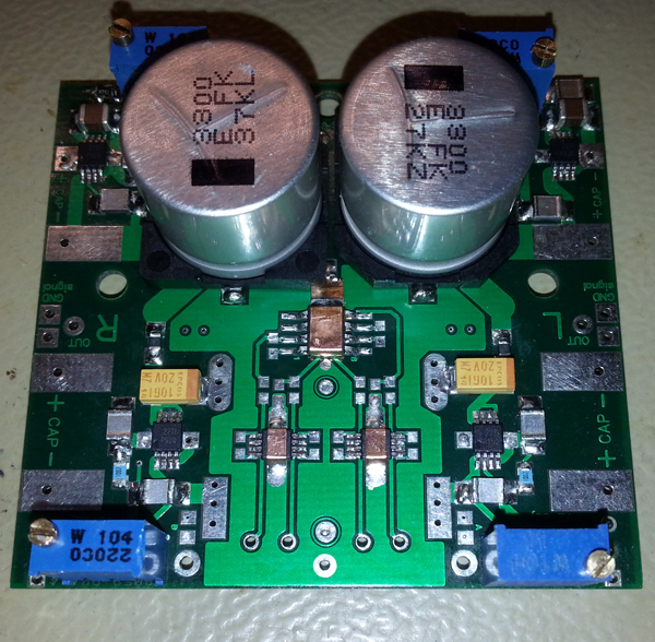

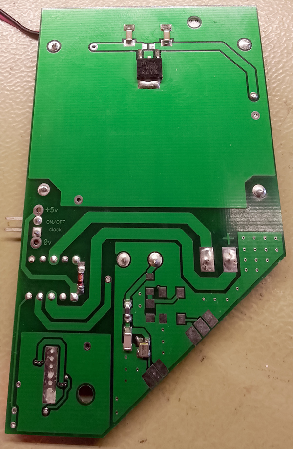

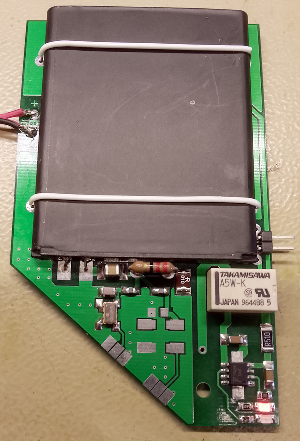

Here is my solution for battery powered clock(s) for Oppo (including some other applications...).
This board it were designed to be used on Asus ST/STX sound cards (it fits actually mechanically with ST/STX). But it can be also used on what so ever system. I will use it for Oppo players (3 clocks)... It can be populated with, and it can power up to 4 oscillators of different foot prints. Clock signals transported by 0.8 mm coax.
A new and improved design of this board is in production now. The new board it will have accessible pads from the pin 1 (Enable) of all the 4 oscillators, as a simple start up delay circuit, in case it will be necessary for a more precise control of the clock signal in conjunction with the host system power up sequence.
One may note that as it is this circuit, there exist a delay for clock signal start induced by the relay itself. There is about something into 15-20ms, depending of the relay construction/specification. If this delay it may not be enough for a host system power up sequence, then the Enable pin of the oscillators have to be used accordingly. The new (upcoming) board provide access to the Enable pins of the oscillators, to be connected further to the host system. Or these Enable pins it can be connected individual or all together to a simple delay circuit on board.
The battery charging circuit it can be connected to a 9-12v DC, or to 5v DC rails, depending on the host system. When is to be connected to a 5v rail, the 7805 regulator on board have to be bypassed (shorting its in/out pins). A gap on the traces is provided for this task. Charging current is limited to 400mA, and monitored by a specialized chip. A protection by a resettable fuse is included too.
An I/V stage/board with its own PSU/regulators is also on the way...

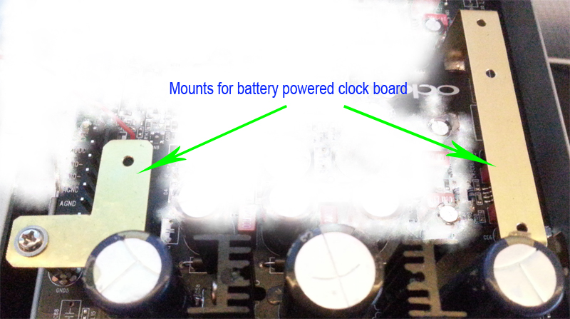

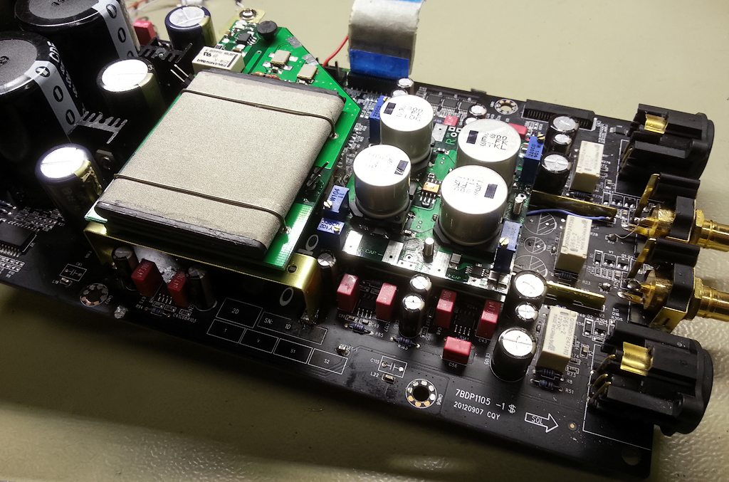

This is how it looks like my mod (mechanically) in place... No electrical connections yet...
The clock board is "floating" on some silicone devices/dampers. The I/V & final board it will be connected directly to the DAC chip, and will provide balanced output too. As all the regulation is made on-board, there is not critical any more the analogue PSU of the player. But good filtering it may be in place actually. I have replaced the original rectifier diodes, with Schottky ones.
I think I will not care too much at this time, but some regulators on original board become obsolete, and may be disabled... to lower even more the heat dissipation.
The clocks board it will be upgraded soon with a common oscillator (divided frequency) for both main processor and DAC chip.
I have tested the QDEO chip with an overclocked frequency (21Mhz), divided from the main DAC oscillator. It were nice to have all the frequencies from only one oscillator... The chip works, but HDMI output is no longer compatible (I suppose is out of standard) with my TV display input. Else I can have picture on another (cheaper) display... Keep searching on this...
