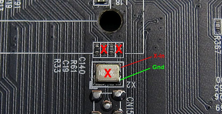

OK, I have figured this out. The 27MHz input clocking, I decided to remove the Xtal and the two small caps. By trial and error, figured out which was X-In. If you connect it to X-Out, it will not work.
X marks the removed components.
See below.

The new Crystek oscillators are the new industry standard low jitter clocks... Of course, I want the SAWs to win....they are much cheaper!
Hi Ric. We have been getting some feedback and much of it tallies well with my experience. What seems to be confirmed is that the SAW seems to excel at revealing detail, and even against the Crystek.
On that point, it seems to be good news.
Certainly at the very least competitive against the Crystek and it would seem that some will prefer it to the Crystek. Over-all it does match the level and as such is the winner price wise.
Now I am desperate to find a 54MHz SAW to convert to 27MHz. I even tried to see if Crystek made a 27MHz if I can't get SAW. But alas, it doesn't look like it.
I need a very good 27Mhz (or 54MHz), if I cannot get a SAW, and whatever is the best available at less than ridiculous prices.
If any ideas, would appreciate it. What do you reckon is the best 27MHz solution?
Cheers, Joe R.

I too had reservations about dividing-by-two option. But really no choice other than try it - and it surprised me. Both the 50MHz SAW and the 98MHz capable version of the 4040 chip, is powered by the same T-F as a "unit". Yes, I am also particular to the wire I use, I use a twisted pair single-core silver-clad high purity copper wire.
Is the Crystek available in 27MHz? I would love to know, and use that in the Oppo 105 here, which is due to be sent to Taiwan. Also, to set up guys elsewhere, including KL and Europe, to do the identical upgrades there.
And, that was the other intention of my post, what is the best 27MHz candidate available right now, and if you have any ideas/suggestions?

I think you are getting your numbers mixed up. The 957 is available up to 50meg. The 950 (older low jitter clock) and the recently released 575 are available at 100 meg. So, someone is sending you a ? clock (either 950 or 575?) to try against your saw? Looking forward to hearing about your sonic results. By the way, the very old 950 is not a 575. So, you would really have to A/B the 950 versus the 575 versus the Saw to really know anything about the latest Crystek oscillators. If you only A/Bed versus the older 950 what does that tell you about the very new 575?.....nothing. The 950 was designed years ago.....have they updated it? Does it sound the same as the 575? I doubt it. I believe the 950 is what is used in the Buffalo DAC......so, if that is what everyone of the "we" has A/Bed their SAW against.....well....what does it tell you about the newer 575? You see how fussy I am? This fussiness is about finding out as much of the truth about something that is possible. The truth of our beings is Love and Joy. Everything else is a constant changing fun game. What is the leader today, goes into the trash bin tomorrow. Only Love is eternal. Enjoy.....In Joy!
