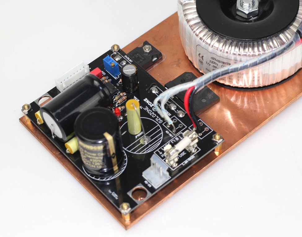

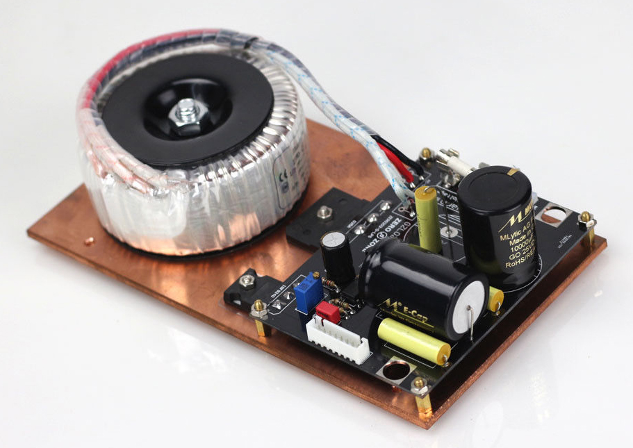

A correction I have to make about my new developed linear PSU, you refer to in the post above. This LPS it is just dedicated to the Sonica DAC, and it is not compatible with the rest of Oppo products. For all Oppo players I have developed my dedicated LPS (PCB fitting all models, populated accordingly), while for Sonica DAC I have developed a completely new LPS, which it fit only for this device.
For eventually further discussions on Sonica, I will suggest the dedicated thread (link here above), while here we may continue about Oppo 203/205 players...:)

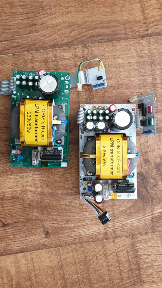

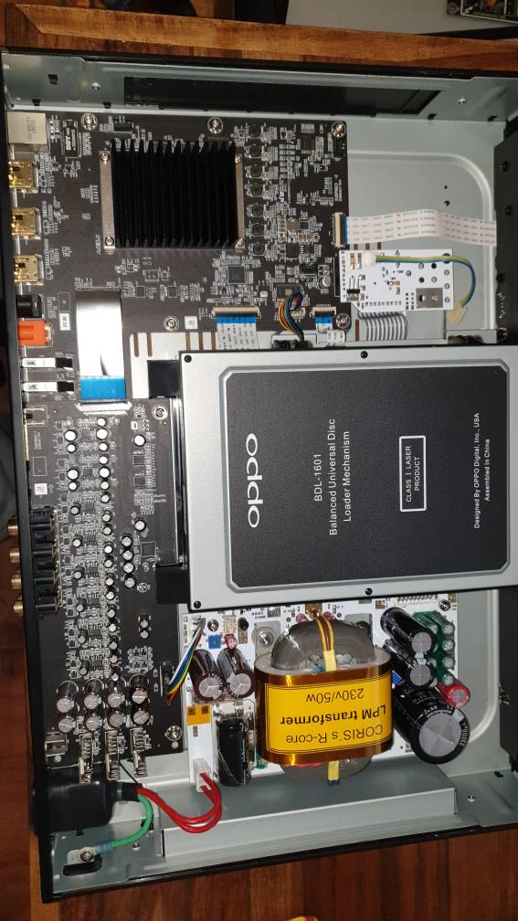

Coris upgraded LPM.
Analogue supported version (white) and non analogue/hdmi only supported version (green).
I upgraded the Iec to Russ Andrews kimber cable one. 20190226_165930.jpeg 20190226_155530.jpeg

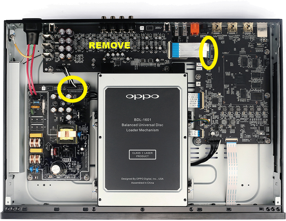

Hi Coris,
Is it possible to completely remove the analog output board in the 203 by disconnecting at the power supply (analog output) and at the hdmi board (ribbon cable)?
Will hdmi inputs/outputs (and firmware) stay uneffected ?
Thanks.
Joined 2009
Hi Coris,
Thanks.
Hi
Yes, it is possible. No any of the device functionalities are affected by this operation.
Important is disconnecting the flat cable to the audio board as well (after disconnecting the power cable).
